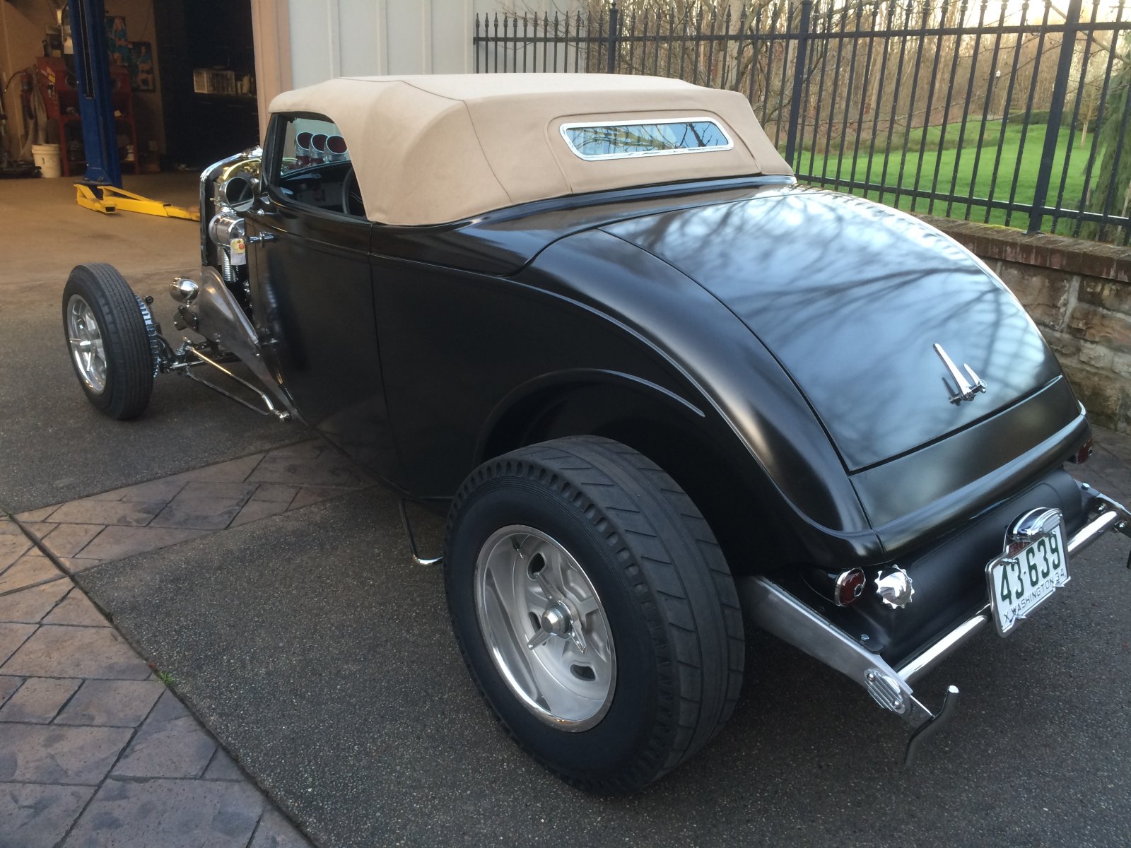

    My 34 roadster is a speed 33 steel body. When I selected it I knew I was going to have to make some changes to fit what I had in mind for my car. One was a cowl vent...
    and the other was door hinges. The car came with m***ive steel strap, hidden hinges.

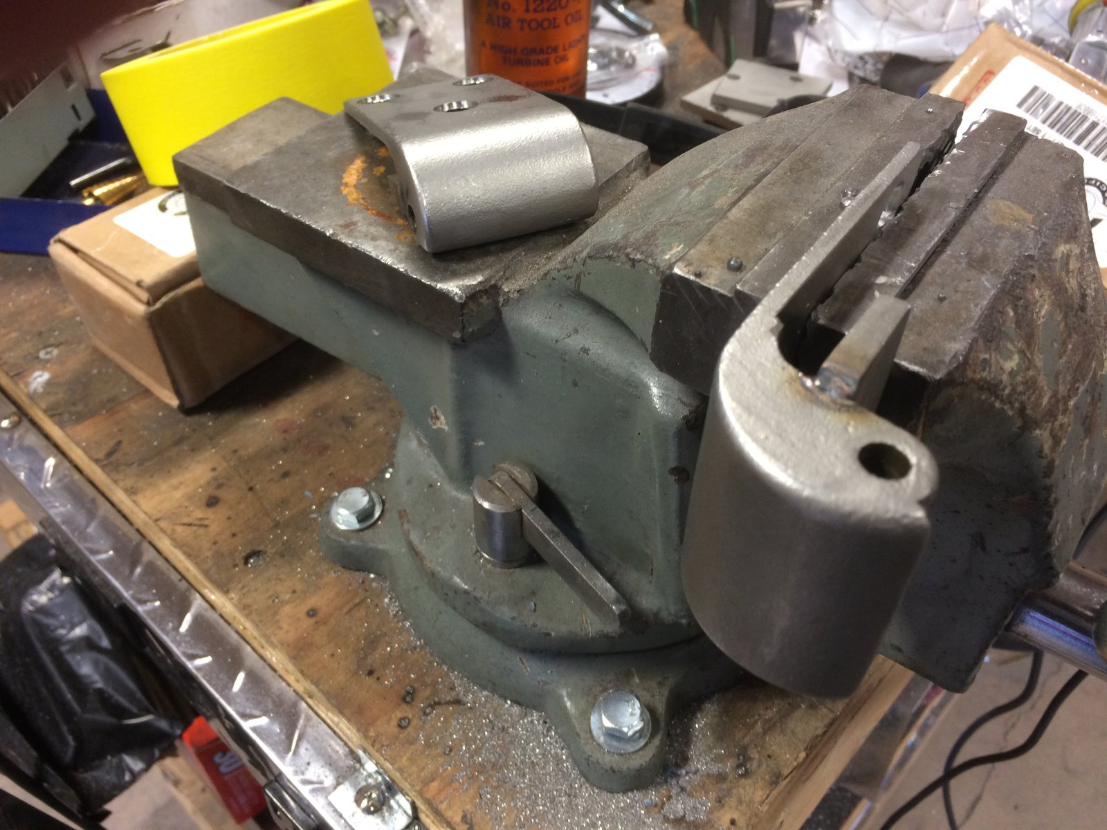

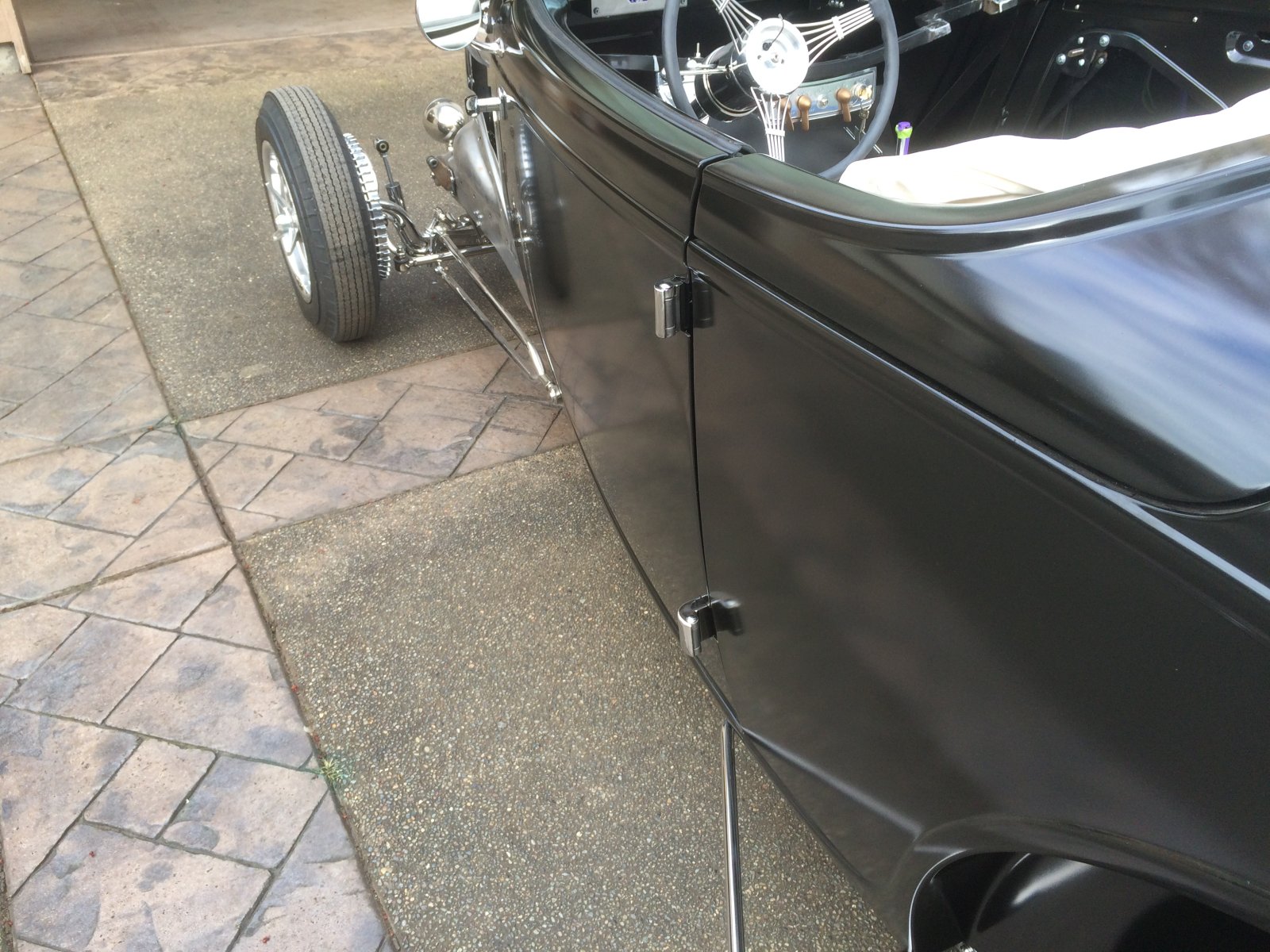

    But I wanted handles and hinges, and shiny while I was at it. I bought SS hinges for a 32 three window, milled down the thickness of the hinge (as they are decorative and not needing to be strong), welded them together and cut off what bits I didn’t need.
    Polished them, cut the doors and added nut zerts in the door jamb to attach them. No one in 7 years has noticed they are not operable. And the look?
    Is exactly what I wanted. Why reinvent the wheel when all the wheel needs is a hub cap?
