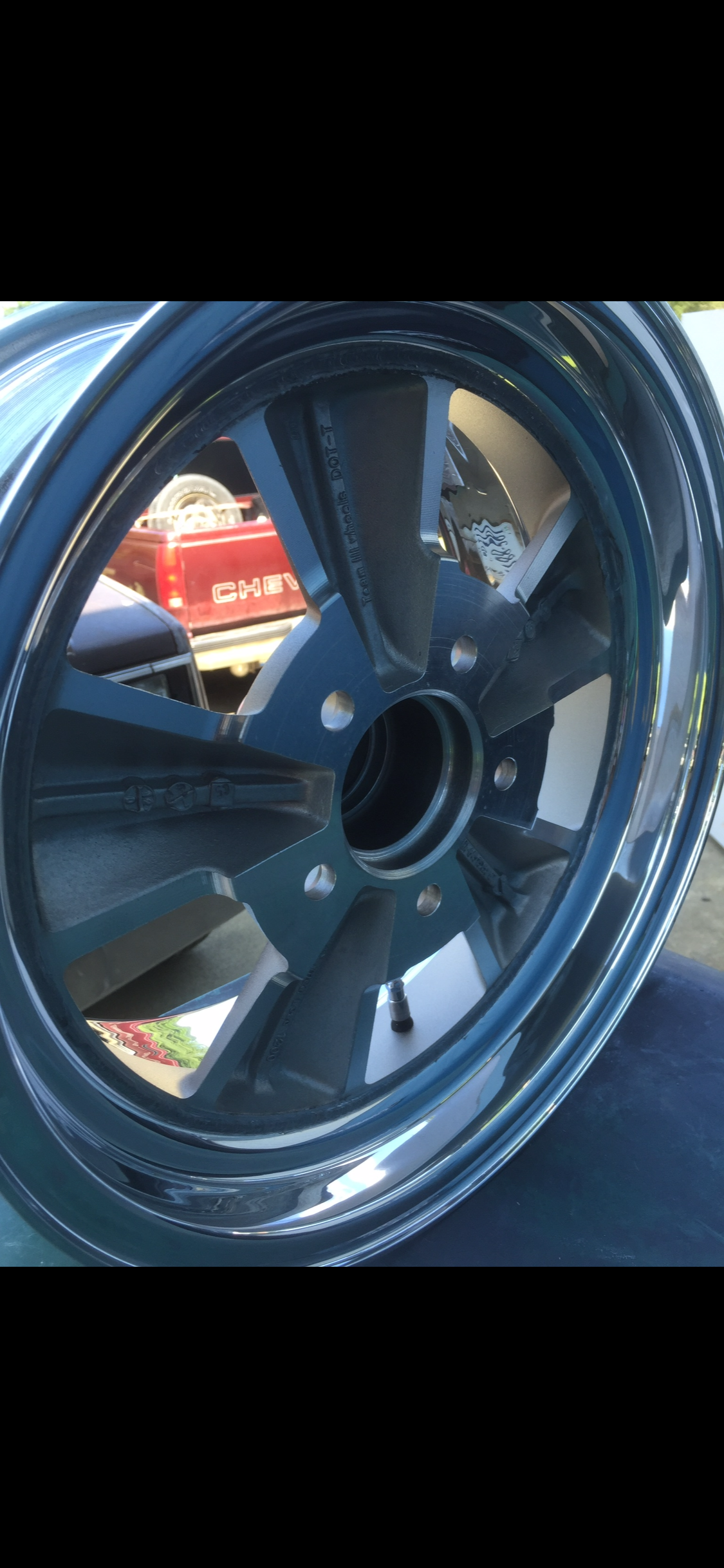

    These Sebring wheels were built by Phil Schmidt when he owned P.S. Engineering, now called Vintage Wheel Works.
    They are two piece, I was able to custom spec. the center location for my needs.

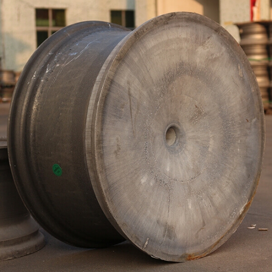

    Many custom wheels are not machined from a solid block of aluminum.
    Many are made from pre-prepared one-piece wheel blanks, or are bolted together from a custom centered, and premade rim valves.
    I have not seen many wheel blanks that narrow, and many simply don't have enough metal in the center to allow the full spoke profile to be produced. Typical web thickness are as thin and 3/4".
    It would be a challenge to find a combination of wheel parts to make a bolt together wheel that narrow, and the design would have to hide the fasteners. That constrains design options.
    While it is possible to machine one out of a solid forged billet, the materials alone are fairly costly.
    Most shops I know of charge by the hour for scan time, CAD work, and what we call spindle-hours.
    This is why machining a wheel center, or a premade wheel blanks will always be less expensive than machining a raw forged billet.
    Any and all of this can be done, it is just a matter of budget.
    Billet blocks are not hard to get.
    Wheel blanks are not, either.
    Wheel parts are also not hard to obtain.
    None are exactly inexpensive.

    For something that narrow, a forged wheel blanks may not exist.
    This would leave you buying a forged billet blocks, and paying for a whole lot more machine time.
