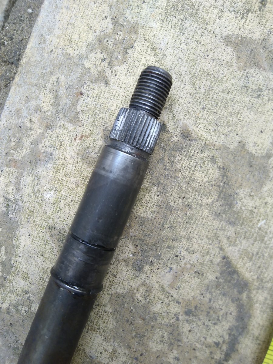

    The Jeep shaft is a 3/4 36 spline on the bottom and not sure about the Chevy collar grooves as I am a ford and Jeep guy so just a picture of the top of the shaft.
    Also this shaft was used from 1971 to 1975 CJs 5 and 6s. 1976 went to similar column but started with the tilt column as well. The bottom spline count will be the same 3/4. 36 as the steering box is a Saginaw 525 for Manuel and power box is a Saginaw 76 with a larger spline count.

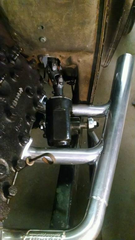

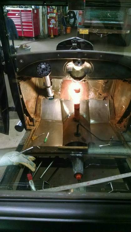

    i know this an old thread, but thought id chime in. I actually aquired two 10 foot 2 inch o.d. stainless pipes years ago from a guy i delt with years ago. I thought that id actually use em for tailpipes or something similar. Well long story short. I cut a piece off 1 to lenth i thought was good and had a straight column out of an s10 for guts. I cut off the bottom of the housing from s10, welded it to the stainless for the purpose of the plastic bushing with the goofy retainer. The guts were able to be shortened because of the slip joint, then welded solid and access cut down to length longer than shaft. The top ended up using the bearing, spring, and some makeshift spacers to get the right tightness pulling up on the inner shaft and lenght to put a universal type cup to accommodate the wheel. Which because of the doner was GM splined. I so happen to have a 54 Chevy wheel that fit on and looks at home there. And can be clocked if needed. I wasnt sure this was even going to work, but thought id give it a shot. Happy i did. And it actually seems decent and works great. The bottom was able to be attached to the box via a double joint that was a double D to the column and correct spline to the box. Ill try to post some pics if any intrest is shown.
