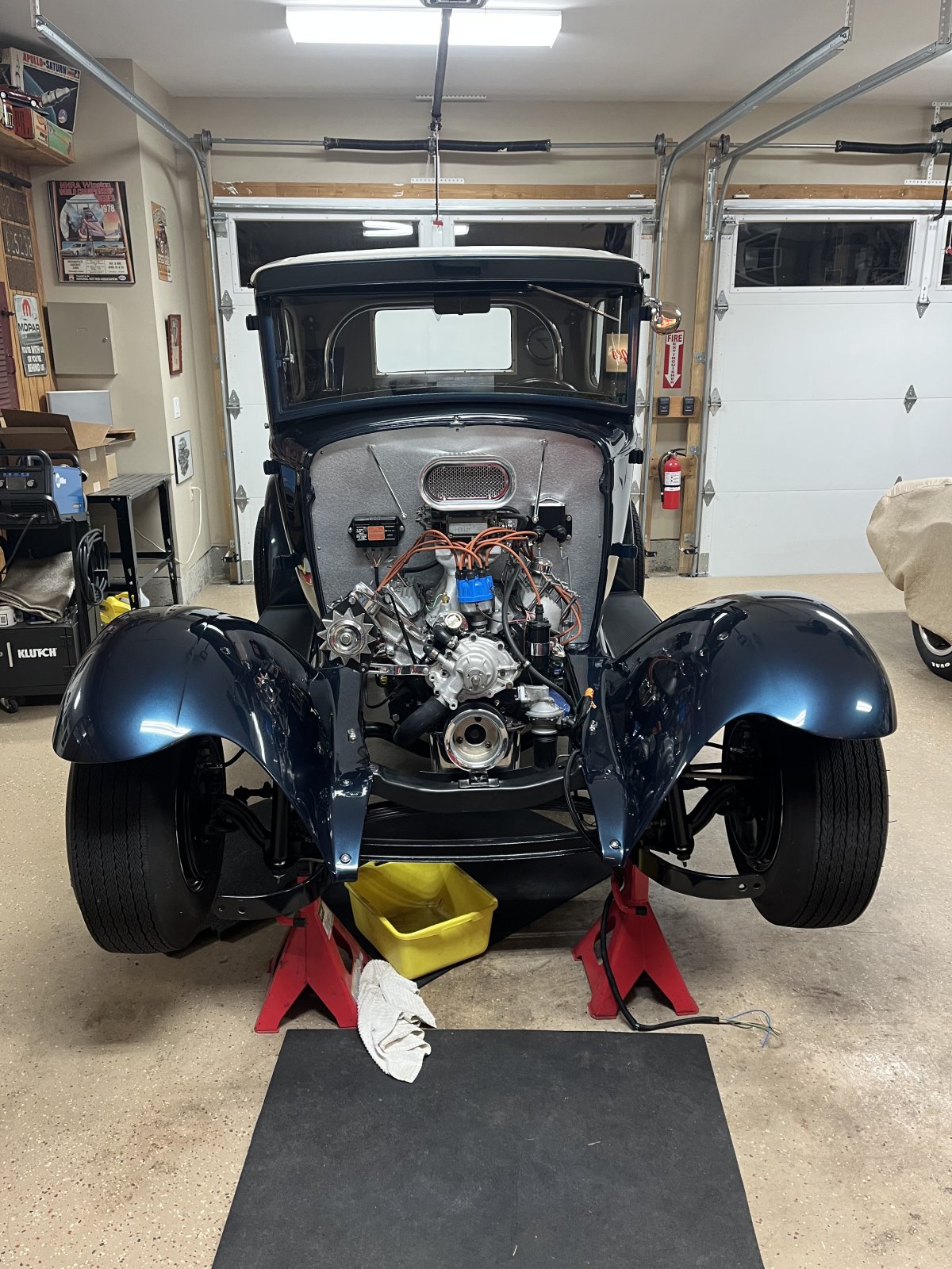

    I ran a stock 1930 model A radiator with a Ford 289 this year. It was a problem on hot days when the car was not moving. I am waiting for my new radiator to arrive. IMG_8740.jpeg

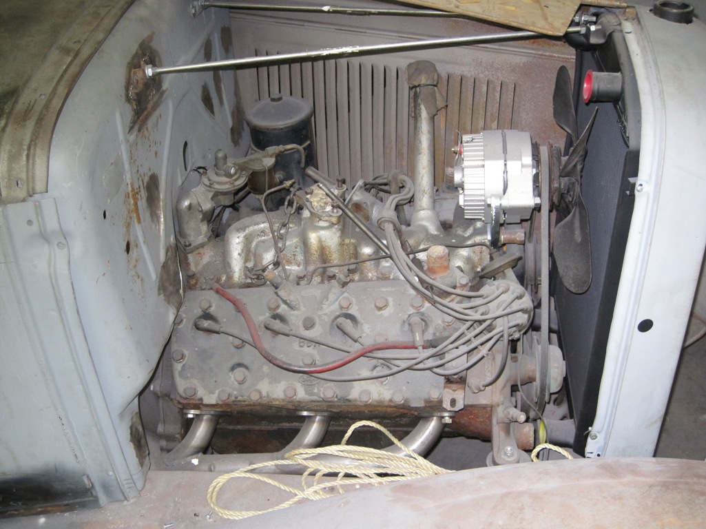

    My coupe is running an 8BA with the 8RT water pumps too but I had the front pulley machined off on the crank pulley and I'm running a 37 fan on the generator. When I mocked the car up I used an alternator and had an early pulley bored to fit the alternator shaft, that allows you to move the engine forward several inches. My flathead is an 8BA with the early heads, just have to plug two 1/4" water p***ages to use them, you can see the plugs at the front of the engine . I run a full hood and a 32 grill shell.

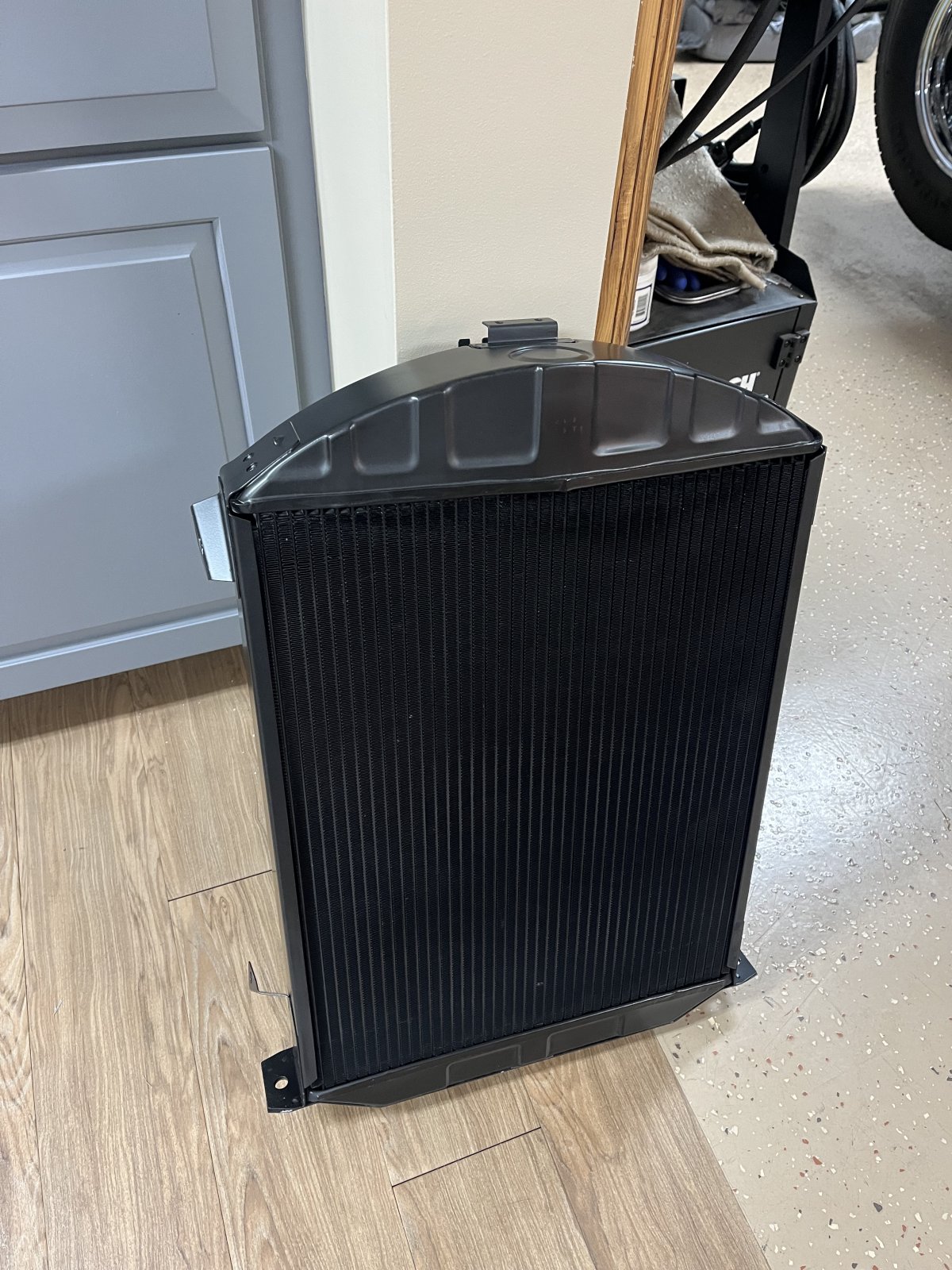

  26. ModelARon
    Joined: Jun 14, 2017
    Posts: 363
    ModelARon

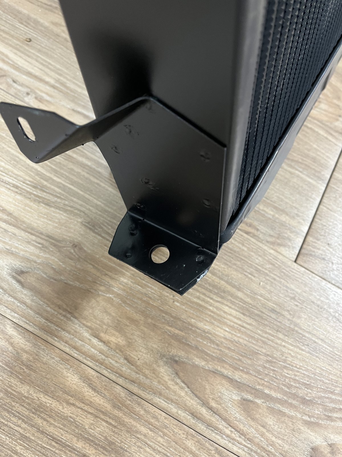

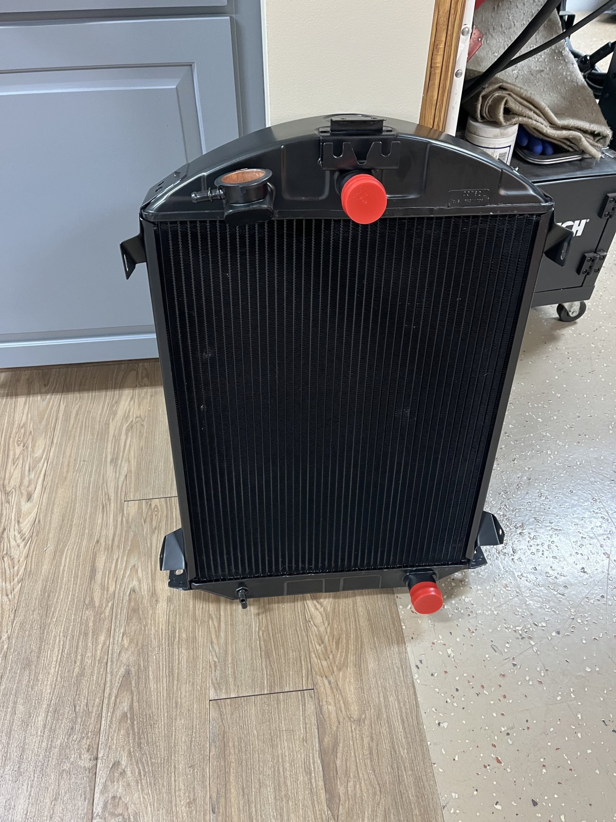

    I just received my radiator today from US Radiator. Took about three weeks from when i ordered it. They did a great job building the radiator. I should have told them not to drill the two holes where it bolts to the frame. I need to shift the radiator about 1/2" away from the fan. Check your clearance to your fan. Check the core thickness of the old and new old so you don't have clearance problems. IMG_8751.jpeg IMG_8752.jpeg IMG_8753.jpeg
