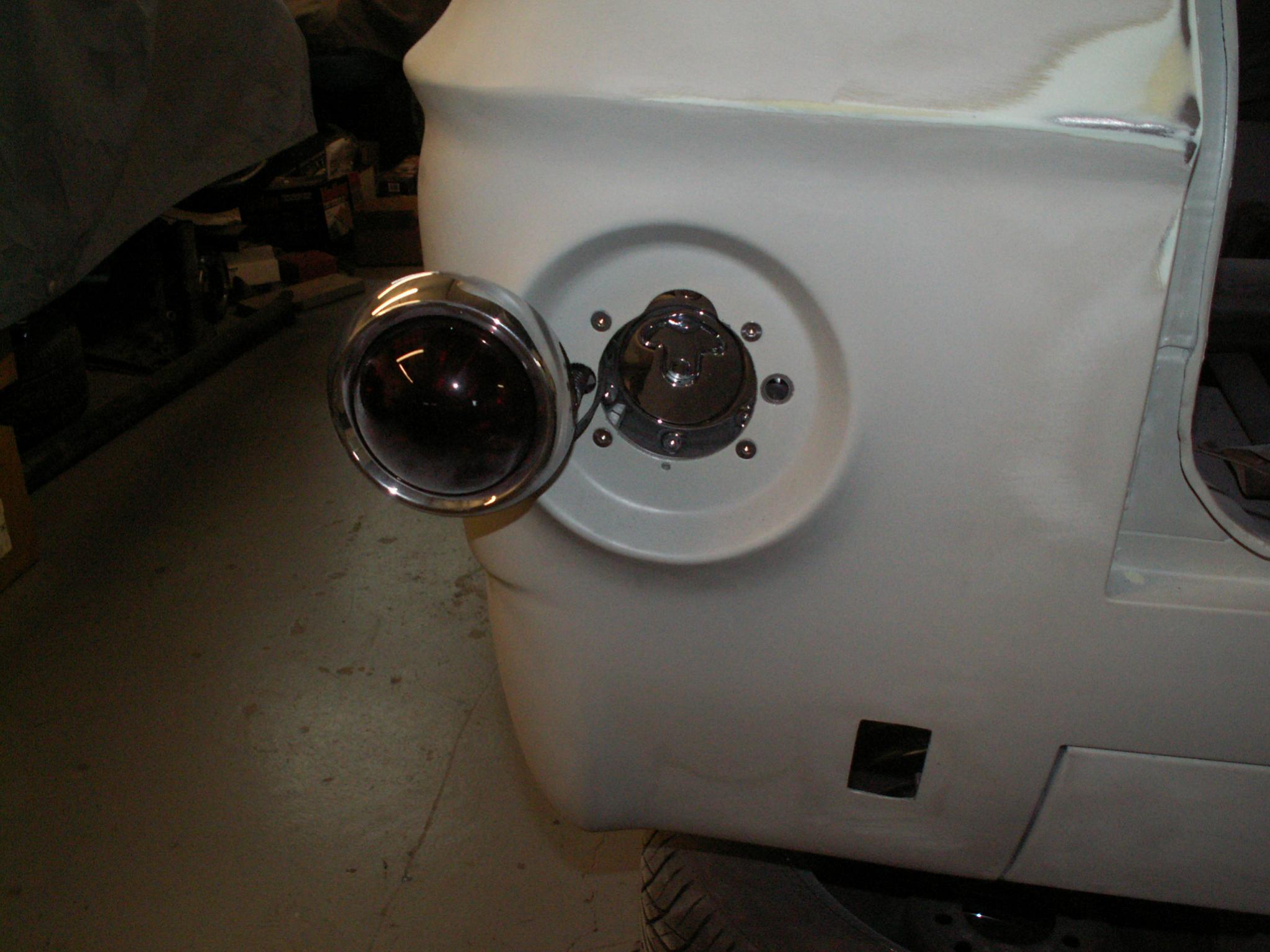

    One other small tweak I've done, is the fuel filler. With a 1950 Pontiac LED lamp and some scrap tubing and Round bar.

    That upper shock mount to coil spring mount brace is ingenious! Very well done! The fuel filler is great too. I couldn't tell exactly how it's held in place, but no matter really. My first thought was that maybe you had mounted the LED light on a NASCAR style fuel filler door. I had a pop open one on the side of my old 63 American, got it from some Jap car while I was stationed at Kadena Air Base, Okinawa, Japan, back in 87-89.
