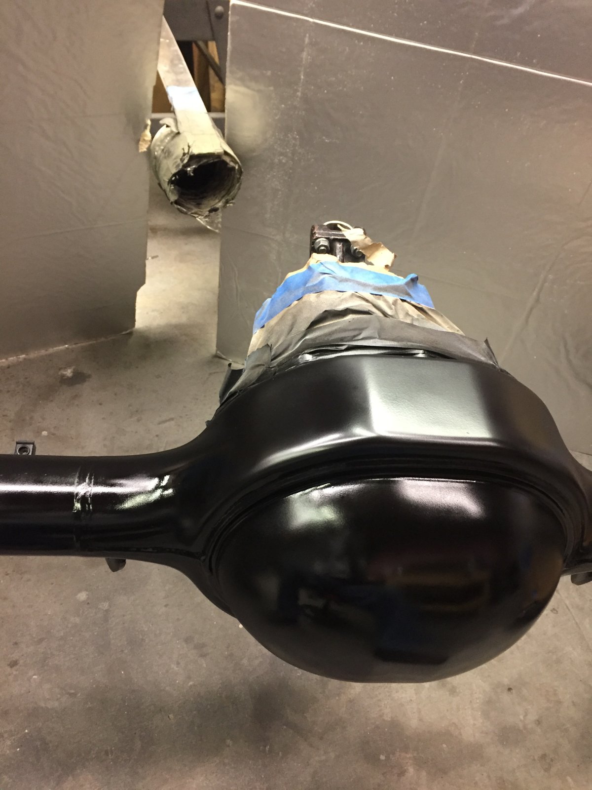

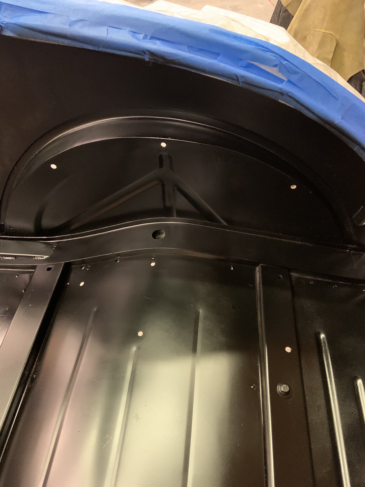

  10. Dino 64
    Joined: Jul 13, 2012
    Posts: 2,536
    Dino 64
    from Virginia
    I’ve used the 2K epoxy with excellent results. They also make a 2K hot rod flat black which is also an excellent product IMG_5743.jpeg IMG_0368.jpeg
  11. Bandit Billy
    Joined: Sep 16, 2014
    Posts: 15,805
    Bandit Billy
    That sure doesn't look like a rattle can job. Excellent!
