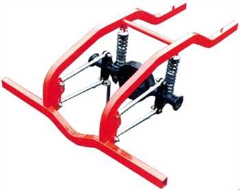

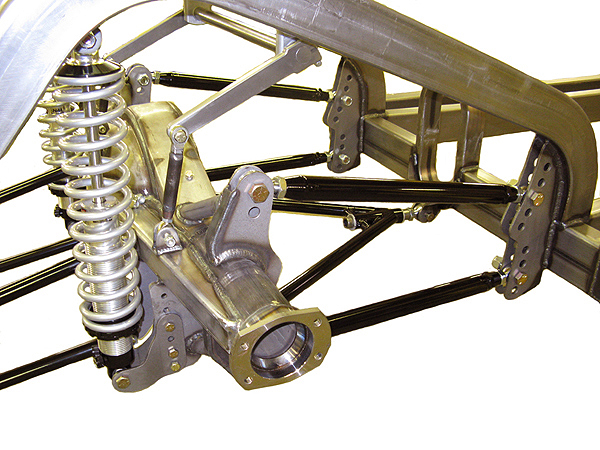

    If this were for the street, laying the shocks over makes sense. Since the articulation in a drag car is different all the builders I've found mount the shocks vertically. Art Morrison, S&W, etc below. am4l.jpg aw4l.jpg sw4l.JPG

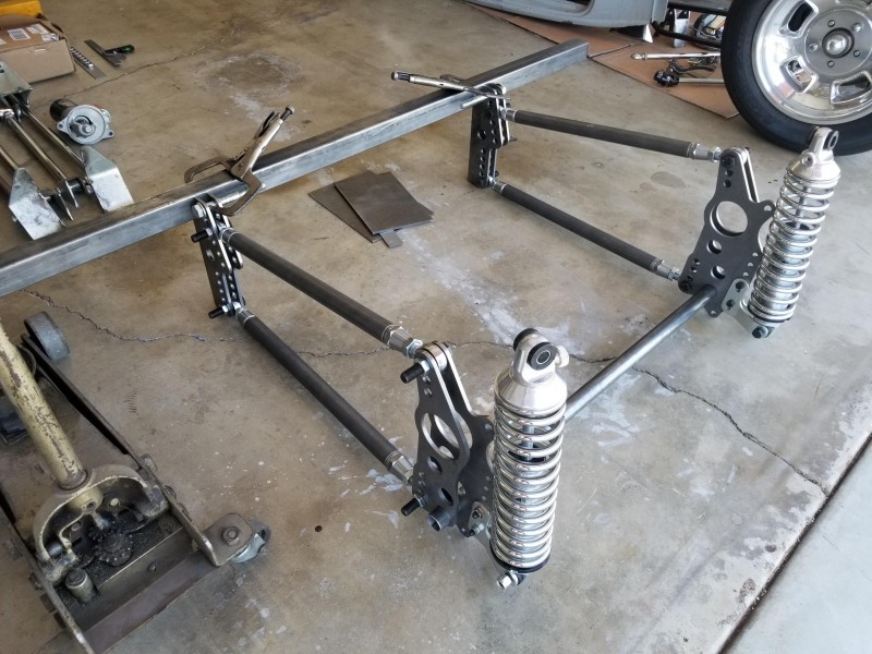

    Got the old setup in the classifieds and the new on the way. The existing coilovers may work, but won't know for sure until I get the new suspension mocked up.

    Stuff's here! Frame's not back yet, but I need to go scrounging for steel at the metal supply tomorrow. Going to be a unique suspension/crossmember arrangement, but you don't know 'till you try, right?

    A little glimpse as I start fitting. The upper front brackets are notched into the x-member, but not flush on the top. The roll cage pad will be notched into the top of the member so it's flush and the top of the bracket can be welded to the bottom of the pad making it all strong as hell. Sounds complicated and welding needs to be done in a certain order, but when it's done it'll tie the roll cage in as a stressed member. Going for light and strong.....

    Cut, grind, weld, repeat...... you guys know the drill. Pretty pleased with only 1 days work. Next up, trim the bars to length and tack 'em.

    After getting the 4 link mocked up, I'm going to use 1/4" rod end spacers so there are no potential binding issues. Be here in a week or so, so I'll have to find something else to amuse myself in the meantime.

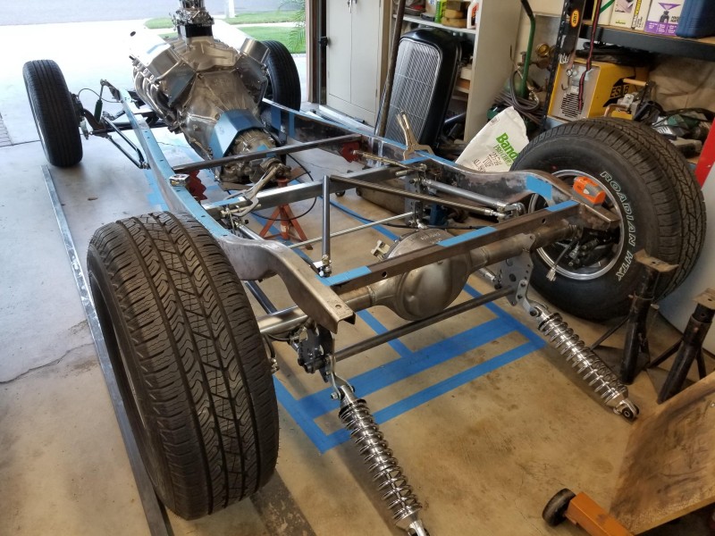

    Frame's back and it's time to build me racecar...... (top of the 2x2 xmember will be flush with the top of the frame rails) frm6.jpg

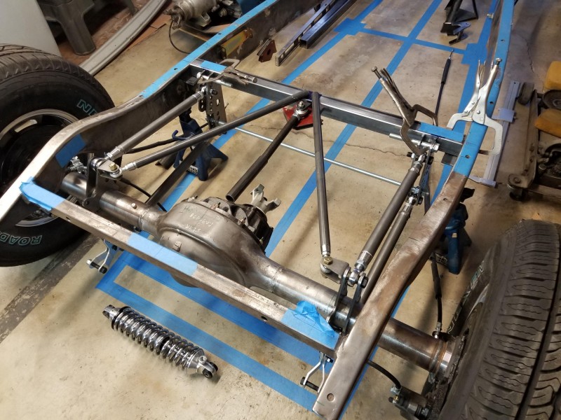

    Put blue painters tape down on the floor, leveled the frame and layed out the frame dimensions on the floor. Got the wishbone brackets tacked back in the correct places..... got 'em within a 1/16". Taking my time laying out the rear end and 4 link points so it all is perfectly aligned. Tomorrow I'll start fitting the front 4 link bracket x-member to see if I need to add a hoop for driveshaft clearance.

    Tonight is the perfect example of why you tack things in place until everything's fitted. Started fitting the coilovers and found that my plan to have them as far outboard as possible had complications. Good news is there's a real benefit to making a relatively simple change.
    I need to cut the inner brackets off (cutting 2 tack welds each) and put them back on making them the outside brackets. This moves the coilover and wheelie bar mounts inboard, but more importantly lets me move the bars 1/2" out making the lower front bracket cantilever shorter. Big words for something simple..... with the lower bars applying the power to the frame on acceleration, it will be stronger than before.
    One step back but 2 steps forward

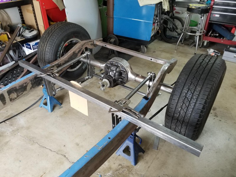

    Got all the housing brackets tacked in and swapped the sides (moving the shock brackets inboard). Going to have to remove the rear tube and move it forward to position the upper coilover mounts. Fitting the wishbone locator when I'm comfy all the dimensions are right. Going to fit the engine and trans again tomorrow since straightening the frame changed mounting positions slightly. Finally making some progress.

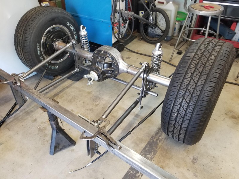

    It's been a real productive weekend, though if you think about it all I've done is get back to where I was before finding the frame was jacked up. Much happier having an adjustable parallel 4 link than the diagonal 4 link that was in it. Getting kinda excited about it now, thinking this thing will be a really beast to drive. I'm used to driving short wheel base cars but nothing with the 800ish HP I'm expecting from the 545.

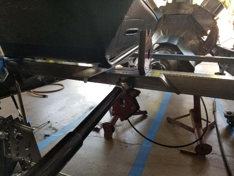

    Front floor x-member is fitted and tacked in place. Put the driver's seat in place for the first time to see where the bracing and seat mounts need to go. Gonna make a really cool custom seat bracket for the rear inner mounting bolts. Should have that factory-ish look to it. Get to take the torch out too...... :)

    Tonight was fun and what I really enjoy about building. With as short as this wheelbase is, there are basically only 3 areas..... engine/trans, seat and rear suspension. With more wheelbase it would be way easier to lay out frame reinforcements and mounts. With this, I need to be a bit creative, combine function when possible and still be conscious of weight.
    Here's what I came up with to mount the rear inner seat tracks and leave room for the harness tabs at the correct angle (not shown yet). There will be 2 gussets under the bracket and on each side of the wishbone rod end so the seat mounts don't rely on the span of the bracket for strength.
    What hasn't been shown yet is the lower crossmember tying the front 4 link brackets together on the bottom, cantilevered to the bottom of the frame rails and verticals that will add rigidity as well as acting as a driveshaft hoop.

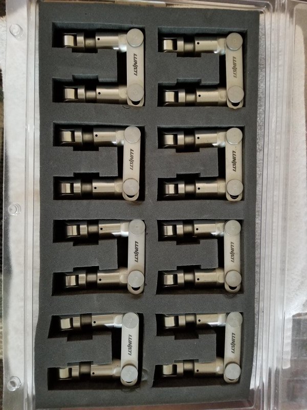

    One more piece of the puzzle. Made a stop in Beaumont on the way back from the river and picked up this set of Lunati (Morel) solid roller lifters for a song. lifter1.jpg
