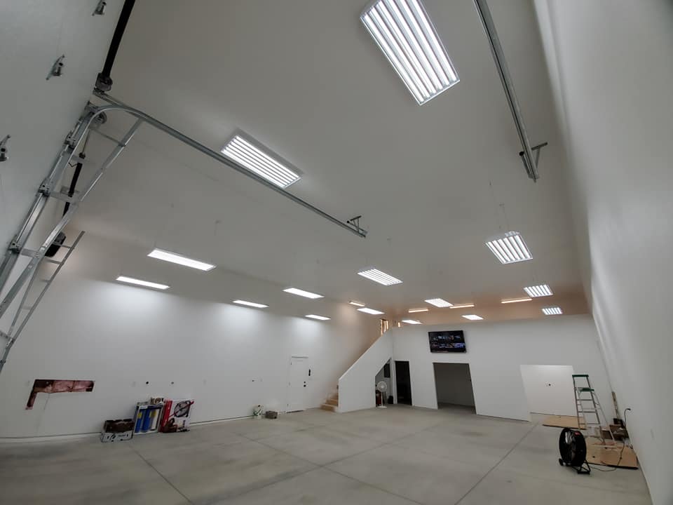

    So my last post was just before we broke ground on the new garage at what WAS "The River Party House". Absolutely nothing has been done on the'32 due to lack of space in the old garage, but that will change soon. We're a couple weeks away from signing off on the new garage, then escrow starts on the "old" house. We'll have 30 days to move all the cars and equipment to what will now be our full time place at the river. The 2 car hoist will be here soon so we can store 2 on top and park 2 under them. A 2 post lift will also go in near the unlit room in the pic.
    Electrical is done and I'm happy my lighting design came out perfectly. 5K LED lighting totaling around 250,000 lumens with no shadows.

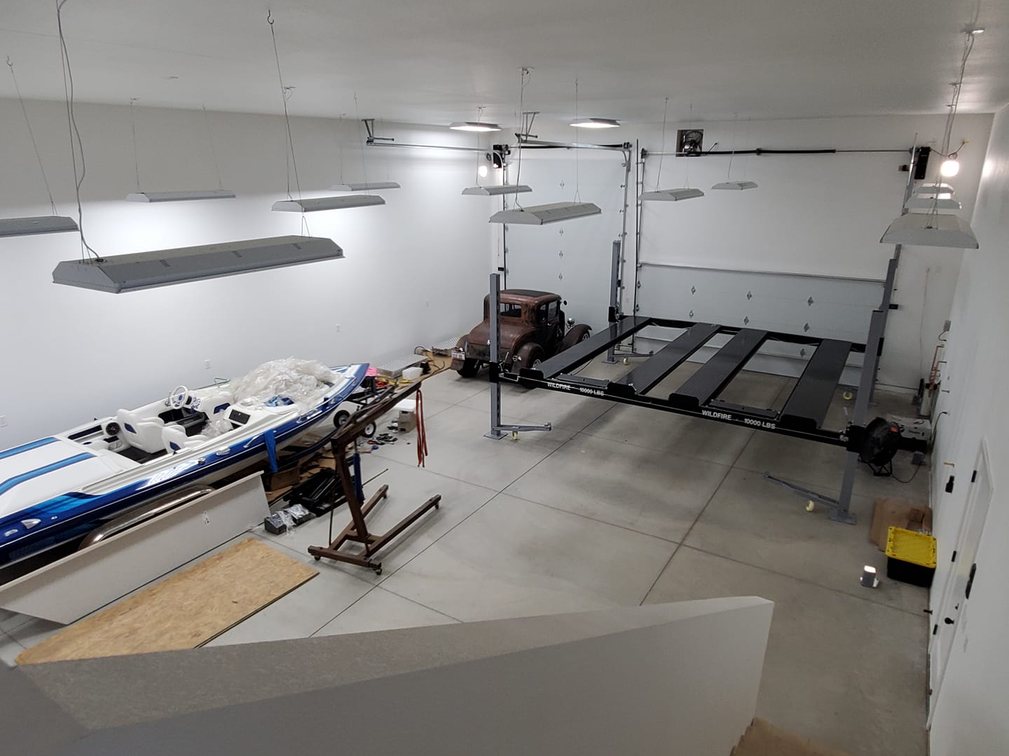

    The '31 is here now, lift is ***embled and the Deuce will be here Sunday. The wife's cars come in the next couple trips and then the '32 gets blown apart..... again, to finish the frame work. 31a.jpg

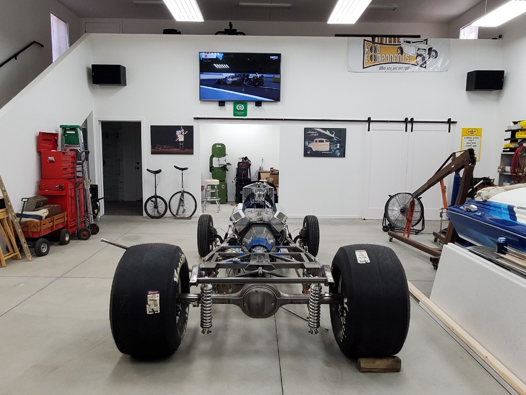

    Brought the next load in. The mess is starting, but don't have the benches here yet. Gotta do some organization today...

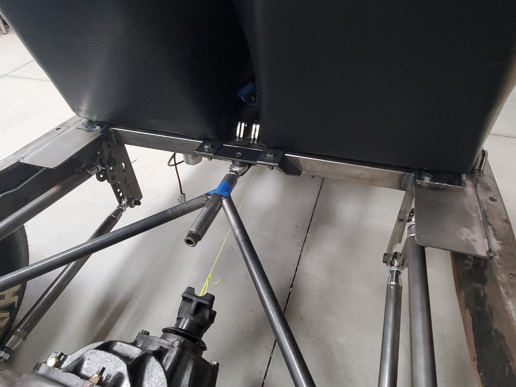

    So after being sidelined for a year and a half to build the garage and get moved (promise no more garage stuff), I finally got the trans crossmember trimmed to fit. Now I'll get the bracket for the tailshaft mount fabbed up and blow all this apart! The broomstick is where the strut tying the front 4 link bracket to the rail will go. Am I the only one that uses broomsticks for layout?
    Feels good to be moving forward again. It'll be even better when the compressor I ordered gets here... in December. xmemb1.jpg xmemb2.jpg xmemb3.jpg

    Ready to come apart after getting the seat mounts done. Have to weld the front seat mounting nuts in before the crossmember gets welded in.
    The cars previous mission of being street legal is evident in these shots. If it had started out as strictly a track car I wouldn't have used '32 rails, square tube, power brakes (under floor at that), etc. Looking more and more like I'll be building a more purpose-built car after this one is done.

    The lift was the best money I spent on this garage. Was out of room before the ink on the plans had dried, so it basically gave me half the garage back.
    Started riding over 50 years ago and it's like riding a bike... you never really lose it. What you DO learn at my age is how to fall without injuring yourself too badly! Small wheel is for stu nts and the big wheel is for speed.

    Been a long year. Garage done, compressor finally came, lift is in and operational.

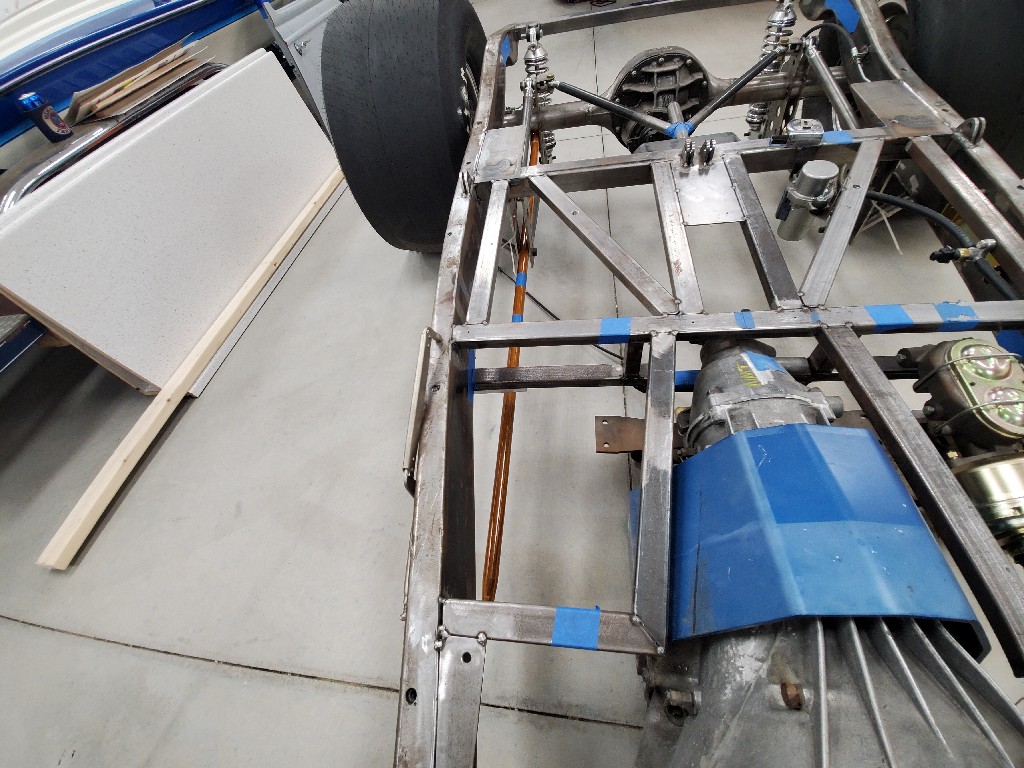

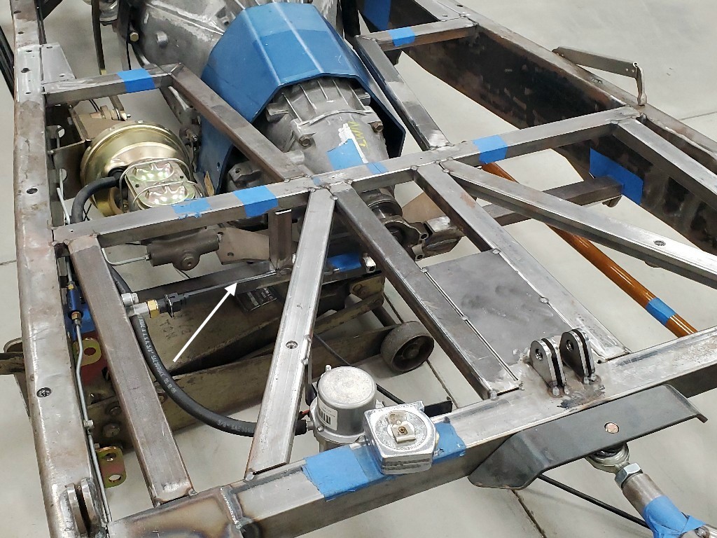

    Geezus... FINALLY some progress. Drive angle is set, trans crossmember was fabbed up today! On the monumental scale this probably doesn't seem big, but it means I can now blow all this apart, finish the engine build, rollerize the C6, finish weld the frame and start fabbing the roll cage.
