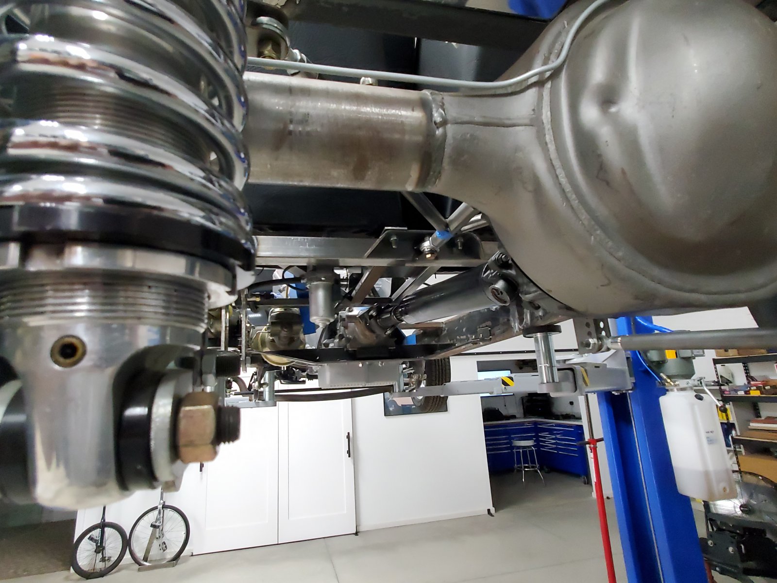

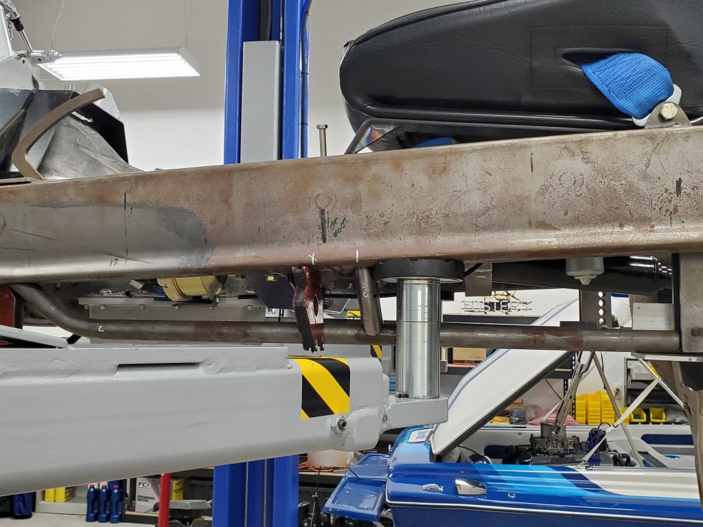

    More progress. Made up the driveshaft hoop and swapped the driveshaft around. Looks odd, but the mandated hoop location makes more sense now. looks tight, but still allows another 2" of lift if I need more clearance. Gotta go buy a bender to make the 4 link bracket braces (next up for my Memorial weekend fun). hoop1.jpg
  11. Mr T body
    Joined: Nov 2, 2005
    Posts: 2,227
    Mr T body
    Alliance Vendor
    from BHC AZ
    Memorial Day project is to eliminate a potential issue with using the '32 rails and a parallel 4 link. Right now, the bottom of the bracket is unsupported and won't handle the load that'll be placed on it without trying to rotate. To eliminate this and actually make the power transfer more efficient, I'm making lower braces that will transfer that energy far forward on the rails (hopefully) reducing frame flex in case it tries to pull the front wheels. When it's all done I'll shoot it a dull black so no one will even know they're there.

    Didn't think I was done just making up braces did ya? Added a vertical brace to strengthen it and realized I need to go buy a tube notcher if I'm going to be making many more of these. xmemb7.jpg

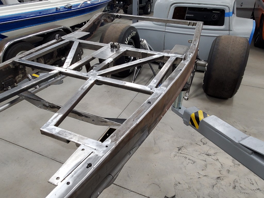

    Last day of the 3 day weekend and I finally got all the braces fitted. Couldn't do any more until I found the plates to box the front brackets and of course couldn't find them. Found them hiding where I put them a couple years ago and got to tacking. Even though I won't be starting out with a transbrake, I wanted something better than just '32 rails to handle hp and driveline shock.

    So what's the coolest thing about putting a lift in to work on cars? It's SO friggin' easy to pull the engine and trans! frm4.jpg
    Blowing it apart to finish weld the frame and move this build forward. Cars parts and pieces all OVER the damn place...

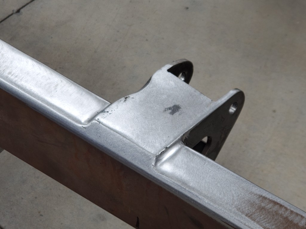

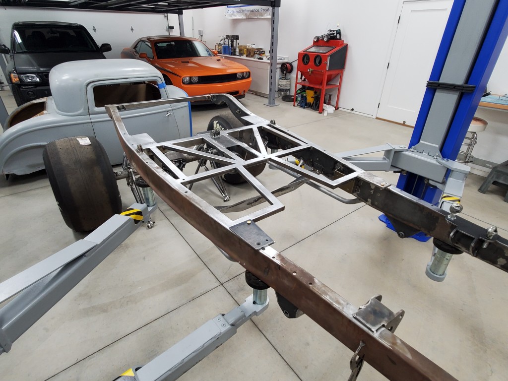

    1st day of welding. Started on the floor reinforcements and got the left motor mount roughed in. There will be a flat floor in this, so the top must be flush. When I'm done with this I'll be flipping it to finish the bottom welds.
    This is my first track car and it's hard to get it in my head that the finish level is different than I've had on on my show cars. Good thing I don't really have a timeframe for this to be finished. frm7.jpg frm6.jpg

    Day 3 welding on the frame. About 90% done on the top, almost ready to flip it and do the bottom. Belated lesson from my old neighbor Brandon Thompson ... the grinding discs he gave me a LONG time ago aren't as aggressive as they looked and give a MUCH better finish than just the flap wheels. Shouldn't have hesitated so long in trying them... live and learn I guess. frm8.jpg

    Only got 1 thing done yesterday. Did some metal finishing on the right motor mount and that was it. The ground away portion is clearance for the header. Hope to get the topside finished today and flip it. frm9.jpg

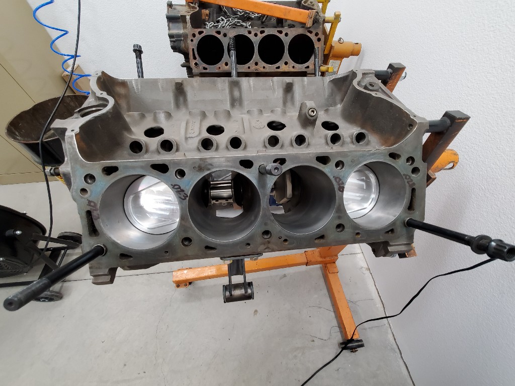

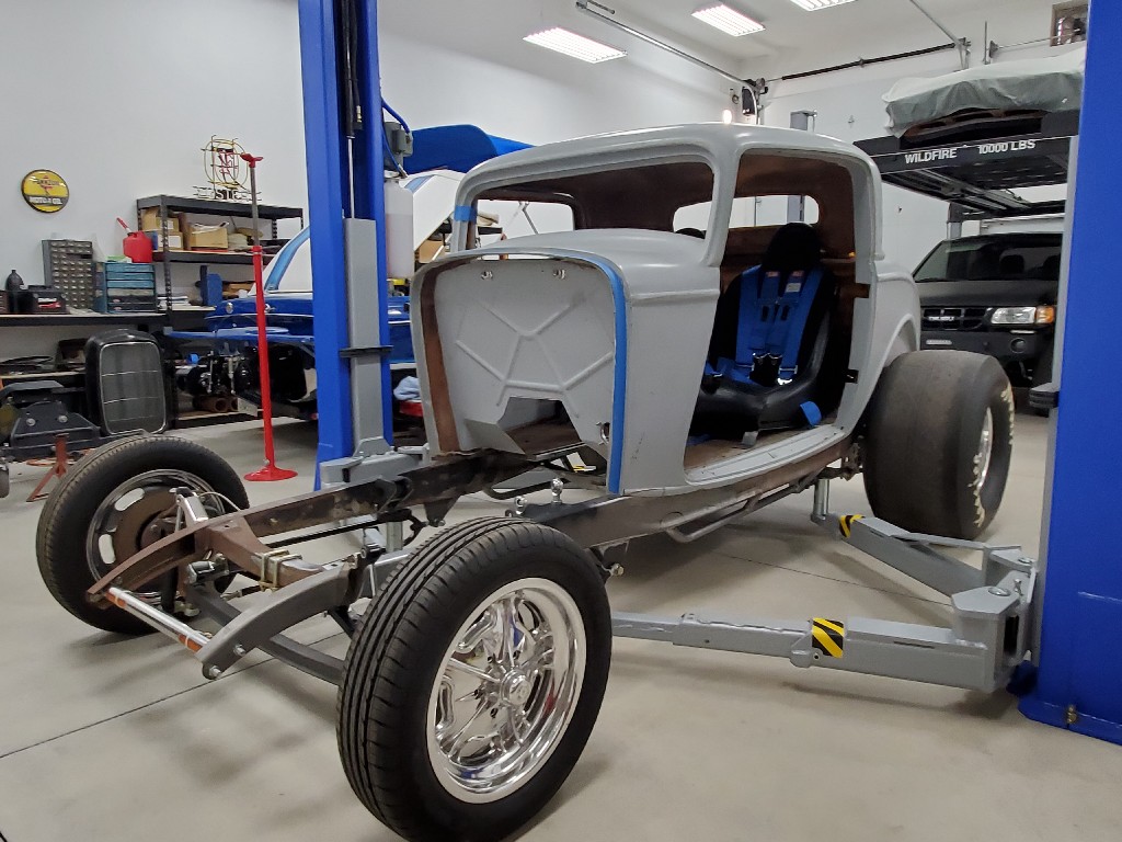

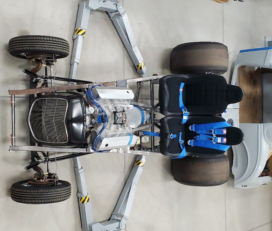

    Had a good couple days. Welding is 99% done (the remaining 1% when it's torn down again for paint), got it flipped , suspension back on and the body is back. Gives me a shot in the arm to push this thing on.
    Measured the block for zero deck, will be getting the pieces to rollerize the C6 and on to the roll cage.

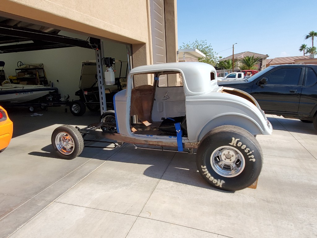

    Man that thing looks so bitchin with those wheels and tires.I run 10x15 wheels with 10.00 firestones that are pretty close to a 30'' tall tire.What size tires are your slicks. IMG_0065.JPG

    The Hoosiers are 32x13-15

    Block went out and got squared and decked. Fitting rings this weekend with short block assembly Tuesday and Wednesday. Found a roller cam core and is being ground for my application. Finally got the cam belt drive in as well. Only coming in around 700hp, but have the other block that'll be built a bit more. It'll get different heads and more compression, so looking to bring that one in over 800.

    i know this is a little late but nhra has in the rule book that you aren't supposed to grind down your welds.
