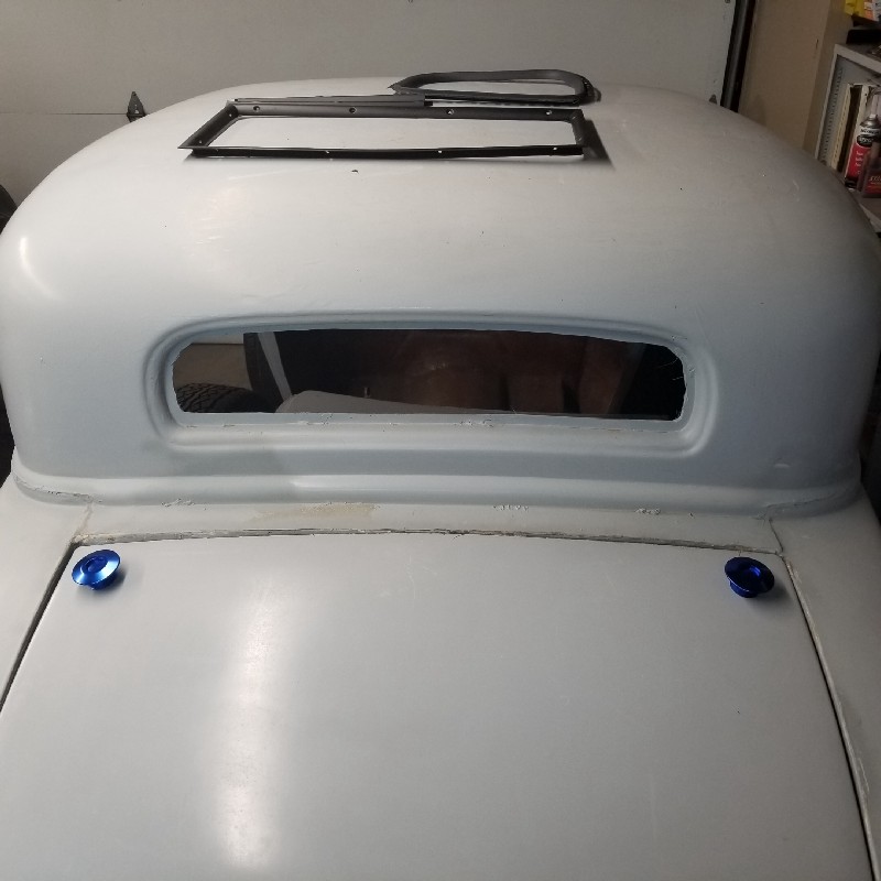

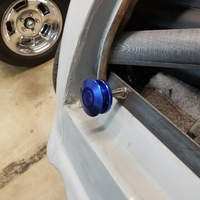

    So, hear me out before you judge. I don't want the trunk lid hinged and don't much like Dzus fasteners so came up with this. I used a QuikLatch on the '31 dash and was impressed with the holding strength. These are about twice the size of that one, but will using 4.... one on each corner. Yes, they're blue but there's a real good reason for that. This car will be painted and I already picked the color.... Cobalt blue (I LOVE that color). These should blend in pretty well once it's painted. Just push the center and it pops up..... push the panel back down and it locks. So to access the fuel cell and battery will take about 10 seconds and the lid will weigh about 3 pounds total. This will be on a serious diet throughout the build to make it as light as possible.

    I considered that route, but this is one of those compromises..... a little more weight but since this will be "street driven" should hold up better after the mods.

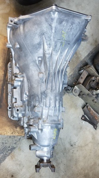

    Well, the trans is here and something was noticeable real quick...... there are different short tail C6's. This one must have come from a 4x4as it has no provision for a speedo cable. That doesn't bother me too much as I drove by tach for years. I have a line on another short C6 from a 2x that has a speedo cable that is pretty inexpensive. I guess I'll start hoarding short C6's........

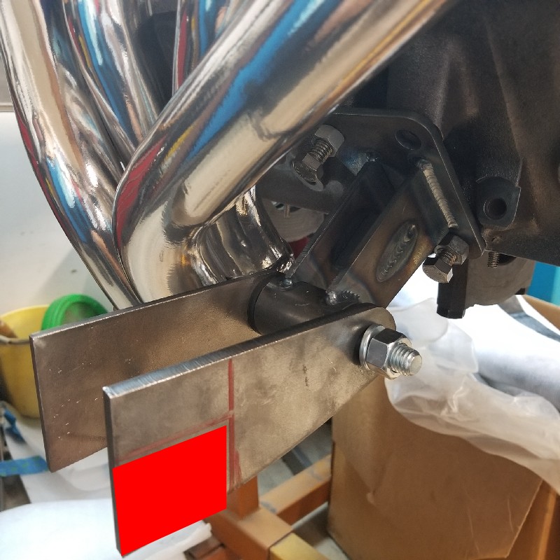

    Mounts came and bolted them up to see where we go from here. The red sections are where the frame rail is with the top of the rail being level with the pan rail. Planning on pulling the body this weekend and starting block/trans position. Might break out the sawzall and cut out the firewall while I'm at it.

    Spent the evening cleaning the trans up. This version is 27-1/2" from bellhousing to the end of the tailshaft housing. Compare that to the standard C6 that's 33-1/2" saving me 6" in length. That means 2 really important things.... the drive angle is better in a short wheelbase car and the engine can sit a little lower in the frame with less centerline angle. Another added bonus is there's no slip yoke on the trans tail..... the yoke is bolted to the output shaft and the slip is splines on the driveshaft itself. Should be stronger and take more HP reliably.
    Oh, and figured out the speedo fix though it's not traditional. Going GPS speedo with one that looks relatively conventional.

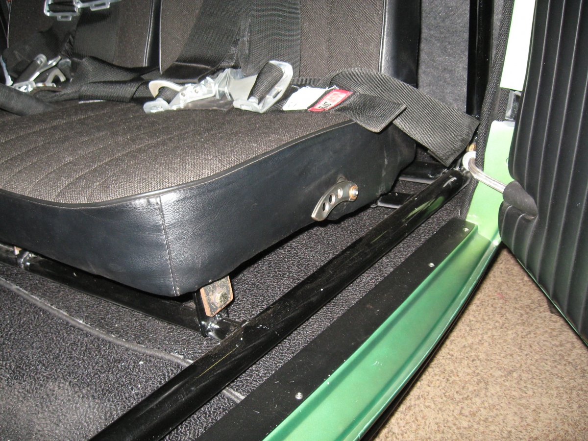

    Great build,luv the big ford engine.I like your seat choice,they should keep you firmly planted.My seats don't have the sides like yours and I tend to move around a little when agresseve shifting under full throttle.My seats are mounted to a low 6pt bar with 4pt harness. IMG_4197.JPG IMG_4196.JPG IMG_4201.JPG

    Thanks for posting.... gives me a couple ideas I hadn't considered before. I like how you mounted the seats to the low side bar, but I don't think I can afford to raise the seats that much (helmet/hoop clearance).
    Time to grab the tape measure and head to the garage.......

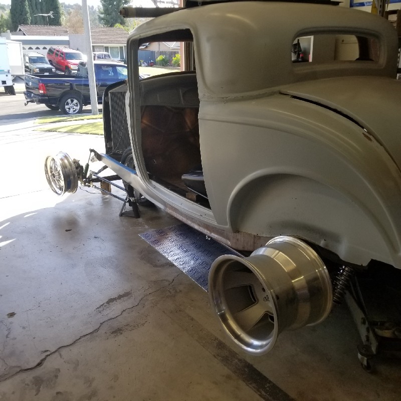

    Looking for this to have a more "traditional" look, so ran over to American Rebel for a couple wheels to mock up. 15x4-1/2" Starburst on the front and 15x12 Sprints on the rear fit just fine. Could go wider on the rear but want to run M&H 30/14.5-15 cheater slicks and these are just right. Haven't decided on as-cast or polished yet.

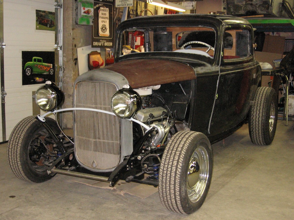

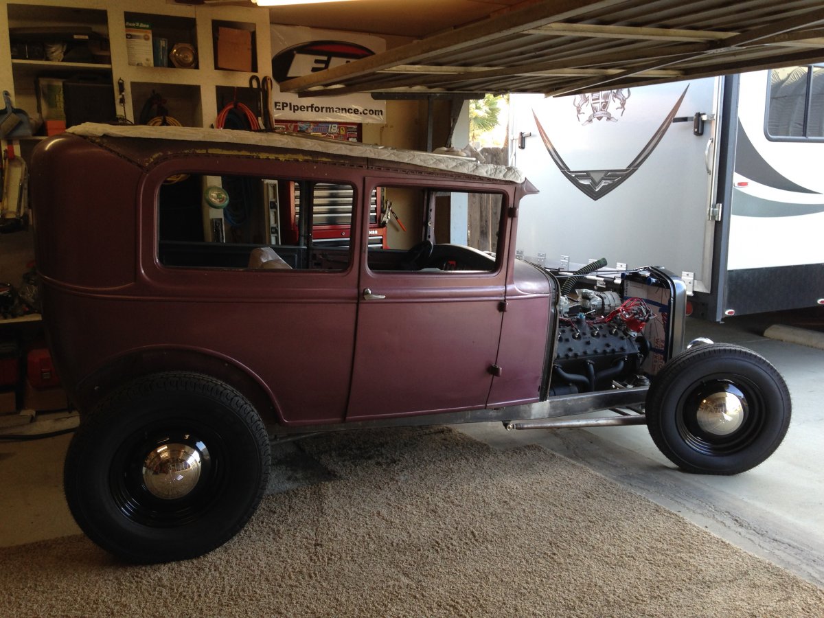

    Those flat caps just make those wheels.That sir is a very nice model a.I wouldn't even paint it.Im not painting my 31 project,but it was painted in the 60s so doesn't have the cool patina yours does. IMG_0847.JPG

    Thanks! It won't be painted or cleared... it is what it is. It WAS painted in the '60's..... with a brush. The outside will be what it was and continues to be. The rest is all new and my special brand of contradiction.
    Cool yours is a period AV8. You should probably have my license plate "31A V8".
