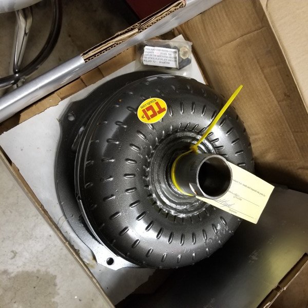

    Look what followed me home..... TCI converter, 1000 rpm over stock NIB for $225. Since this'll be street driven occasionally, I can't go real big on stall. Hadn't planned on buying it this early in the build, but couldn't p*** up saving this much money.

    Semi Hi stalls on the street aren't all that bad. Drove an OT Cobrajet with 3500 daily for years never even noticed it UNTIL you whack the hammer to p*** and boy it's like a second "p***ing gear". Just run a trans cooler and check fluid often.

    With the 545 and about 700 ft lbs of torque, it'll flash stall far higher than 3k, so I think this is a good compromise. If I need to go bigger I'm only out a couple hundred bucks. Cooler is already in the works

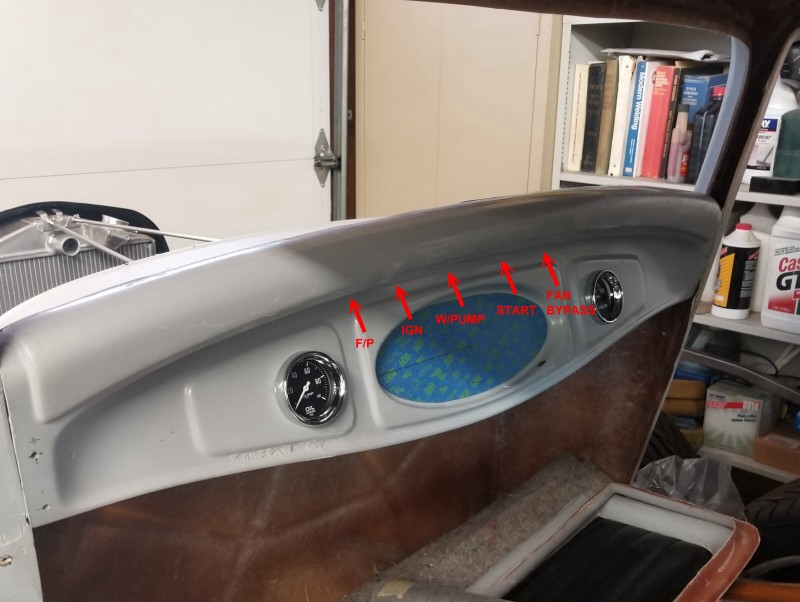

    Old habits die hard I guess. One thing that always bugged me about race cars is the switches and panels looking so utilitarian. I have to have rocker switches for things like ignition, fuel pump, elec water pump, elec fan and start, so while messing with the dash I saw I can mount them under the ledge above the gauges so they're convenient but somewhat hidden. More street car than race car I guess. The idea is that other than major components like elec ignition, relay block, etc., everything will be part of the dash panel. When I build the roll cage, I'll be welding tabs for the dash ***embly to bolt to the A pillar uprights. Kinda like what was done on the '31 but a bit more raw. If I need to service anything, just remove 4 bolts and pull the dash off in one ***embly. I'm getting too old to be crawling around under dashes.......... gauge2.jpg

    Cool idea on the mounting tabs. Years ago I was at a local shop and they had welded head rest brackets to the dash so you could slide it out a few notches to get behind the panel and pull the plugs, then depress the latch again and removed the panel.
    Gotta love creative engineering. Keep up the great build, watching and enjoying

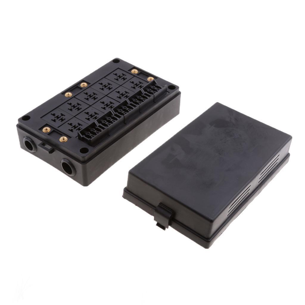

    Probably kinda geeky, but found this on Ebay (from China of course) and wish I had found this long ago. Cool part about this is it can handle up to 10 relays (starter, ign, water pump, fuel pump, horn, etc), 15 fuses (this really is the cool geeky part) and 3 Midi fuses. The cool part about the fuses is you can fuse the circuits in AND out of the relay in one box or a few individual non-relay circuits (if you use less than 7 relays). I'll have to wire the car from scratch, but this'll mount really nice under the dash. Apparently I'm easily excited..... s-l1600.jpg

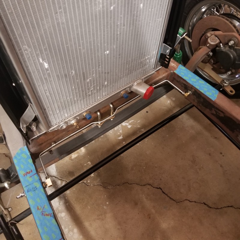

    Now that the '31 is mechanically done, I'm focusing on getting this going. First up is the easy stuff to get it rolling. Front brake line was a 2 beer effort......

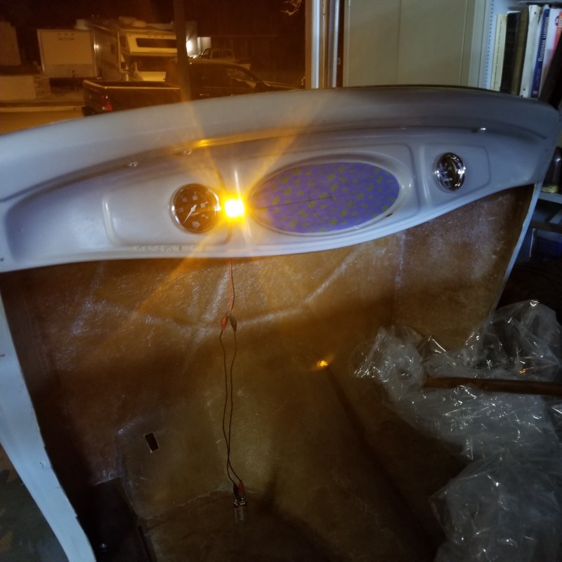

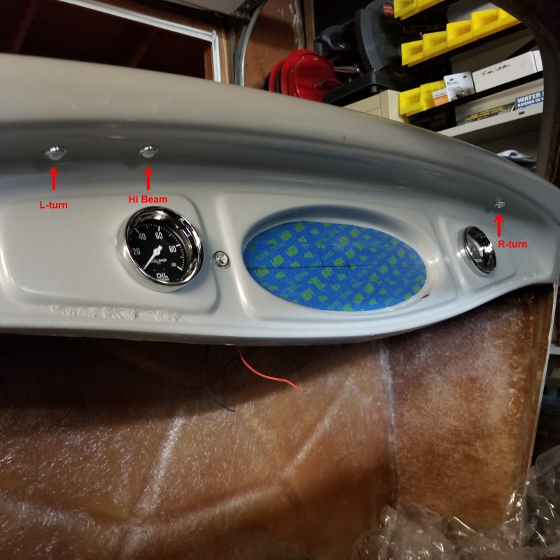

    Since this will be "street legal" it needs turn signals and a hi beam indicator. Got these LED's, but were a bit bright to mount on the dash face, so took a page from the '31 and mounted these under ledge.
    Don't really have the real estate for a shift lite (and hate the look), so came up with something a little stealthier.

    That's nice work on the brake lines.

    Thanks. In a previous life I did hydraulic and pneumatic systems R&D and prototyping so it's kinda second nature.

    I like that electrical panel. Do you have a web address or the type of search you used to find it?[​IMG]
    I had never heard of a MIDI fuse before. Seems like I learn something new every time I come on the HAMB! So looking at the picture you supplied do these fuses bolt externally on the three sides of the panel ? What are the dimensions of this panel?

    Kinda geeky electronics stuff, but will make the install so much cleaner. The midi's bolt to the 3 pairs of br*** terminals with the wiring into and out of the fuses on the backside of the panel. I can have 3 main circuit fuses for the relays, just need to look at the functions and group accordingly. I'm going to mount this in the "trunk" next to the battery along with a small fuse only block for non-relay circuits. It'll make wiring so much easier and adding the master cutoff a piece of cake.

    The relay box came today and though I'm not quite ready for it I looked it over and am actually pretty impressed with it. Not cheap lightweight plastic, fairly substantial weigh-wise and pretty well made. Who'da thunk it from China?

    Thanks the info on the relay box. It looks like a nice,neat way to mount relay circuits. It looks like it would have enough circuits to wire a simple roadster project. China.... yep, just about everything is made there these days.
