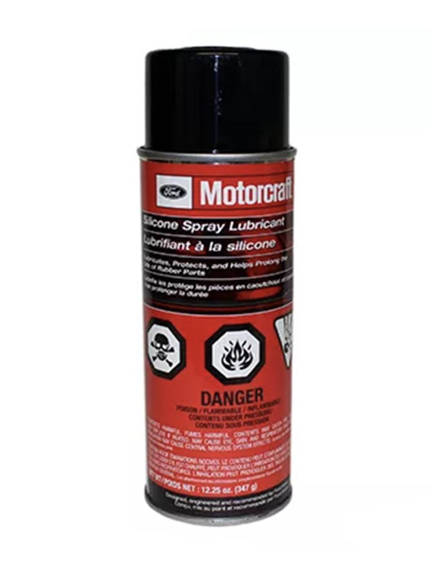

    Mmmmm.
    I must doing it wrong.
    I used Motorcraft (Ford) silicone spray on all my window channels.... no ill effect on either 57 and the windows run smooth in either direction.
    I also used velcro on the vent windows.. worked real slick and the adhesive was a 3M product.
