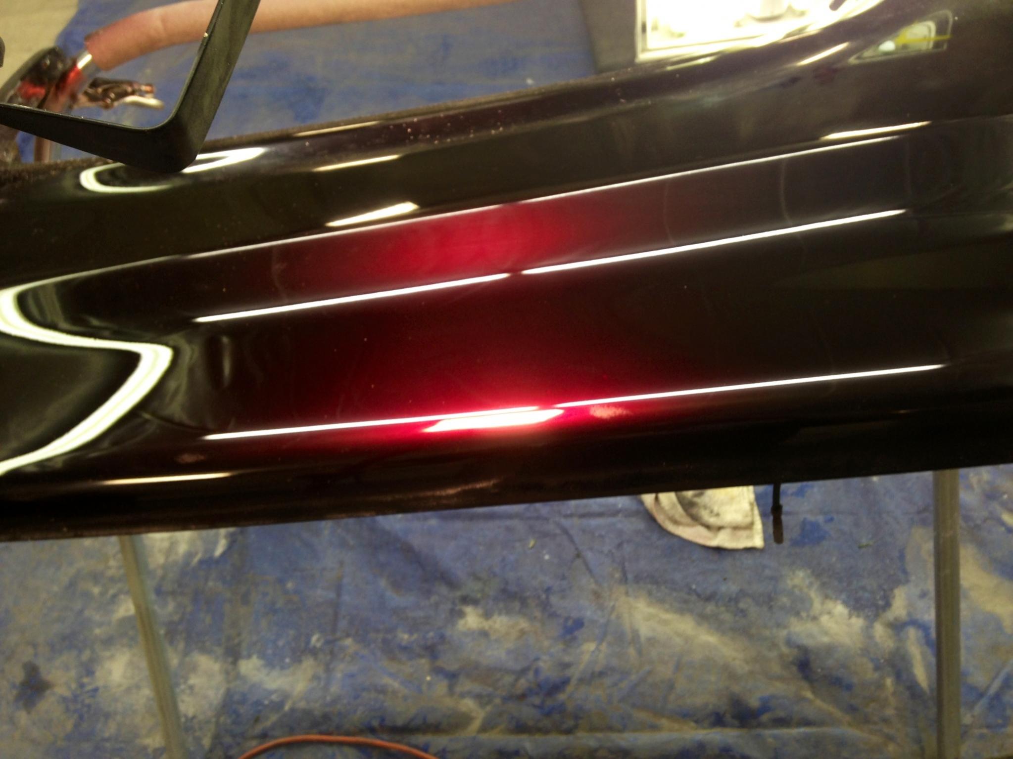

  11. Here's that fender out side Only moments ago.
    This thread prompted me to get it off the shelf again because I almost forgot how neat it is to play with it.
    It's black as black can be, maybe even blacker and purer than any black I've seen unless the light hits it just right and then it pops candy apple red. The kind Of red on the candy apples i used to get at macey's when I was a kid.
