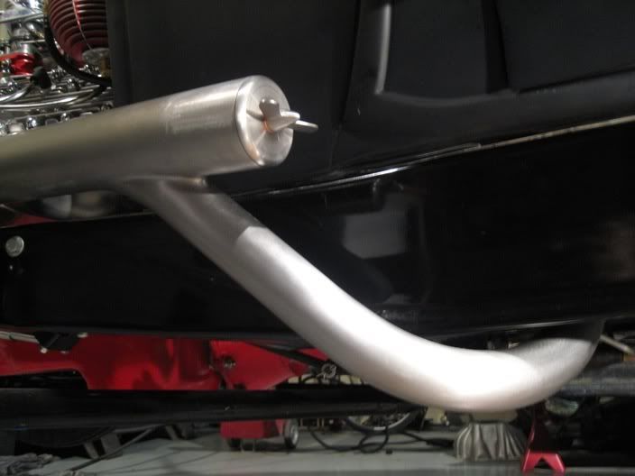

    This is for he post that JaysinSpaceman sent, up couple up.. I like this one....... I have a conscience... in what I do and dealing with customers and jobs,, There's soo much I could go into detail on this.. best example,, the header job,, 36 Ford drive shaft.. I ate 140 hrs on that job.. I subbed the rear exhaust out to a exhaust shop for the tail pipes, up over the rear end out the back,, I spoke highly of the shop to the customer,, guy still gas welds all his exhaust work,, when me and the customer went to pic up the roadster,, and when went down in the pit and looked up at the exhaust,, I got SiCk to my stomach.. the bends the welding,, I thought what happen,, when we got the car back to the shop.. I felt sooo bad for what the exhaust shop charged the customer,, I told him,, go buy me all the "U" bends... I'll cut it all off, re machine all the flanges, and I'll eat the labor. Why .. its my name.. The polished weld job,, customer didnt ask for it,, I took it upon my self to do it,, I thought it would look SiCk,, i didnt even want to give them back.. 2nd I'm one guy her,, no one else,, phones, e-mails,, shipping chit ... sooo on..I deal with it all.. Every job is treated the same every product,, whether its a $500 job,, or a $50,000.00 job its all treated the same..Whether yer a BAller$, or a guy who just wants to build a car with a budget,,, I look at you all the same,, were all people in life.. no ones better than each other,, were all equals in life It's not the money..nor the fame, I just want to survive in life,, pay my bills,, if I can buy a house , or raise a family doing what I love then it was all worth it for me in life,

    Look for a how to Tech Artical in OLL SKOOL RODS , for this header build, 36 Ford drive shaft headers.. all the pics were sent last week..

    Steve, there are a lot of guys out there who won't get this and maybe you're one of them and if you are trust me this is a huge compliment... you're like the Les Paul of the metal fabbing world. Innovative, way ahead of your time yet down to earth and humble enough to talk to the common man and a sense of humor too! What more could we want? What we’ve seen on your myspace page is amazing. Don’t be shy and post some more here for us to see.
    Any chance you could give us a sneak preview on how those header caps attach on the inside? Those headers are beautiful!

    Bro I came up wit da chit while i was designing them,, i was wasted ,, too much CaPn CoKe!.. I think.. I'll post pics,, What has all ways bugged me when you see a set of caps on headers never see one that didn't leak.... This didn't leak a sooT!.. I'll post some pics.. very simply yet when you looked into the end,, all you see is a Steel ring.. The copper washer and wing nut is what seals the stud, Copper bung is pressed into the cap about a 1/2 inch , the flat surface on the wing nut seals to the copper.. There is a stainless ring welded,, well fused on the inside of the header,, it's has a stepped edge,. around the I.D ..Ring is stepped inside about a half inch,, Soo it goes ring welded inside,, then a gasket with a steel ring around the I.D of the gasket when tighting the wing nut the Stainless header cap KrUsHes the gasket,, soo step around ring metal ring around gasket,, then cap it all gets krused by the cap,,
    Soo know those little tabs in the pics or the drawing where yo see the caps these are welded on the end of the stud soo it looks kinda like a T at the end.. you jus stick it in side ways, hook the back side of the ring,, slip gasket, cap tighten wing nut Done!!! Now trip what happens to Stainless ,, expands fer even a greater seal..
    F!@#!@ I hope you guys understand what i'm tring too say.. I get some pics soon ..
