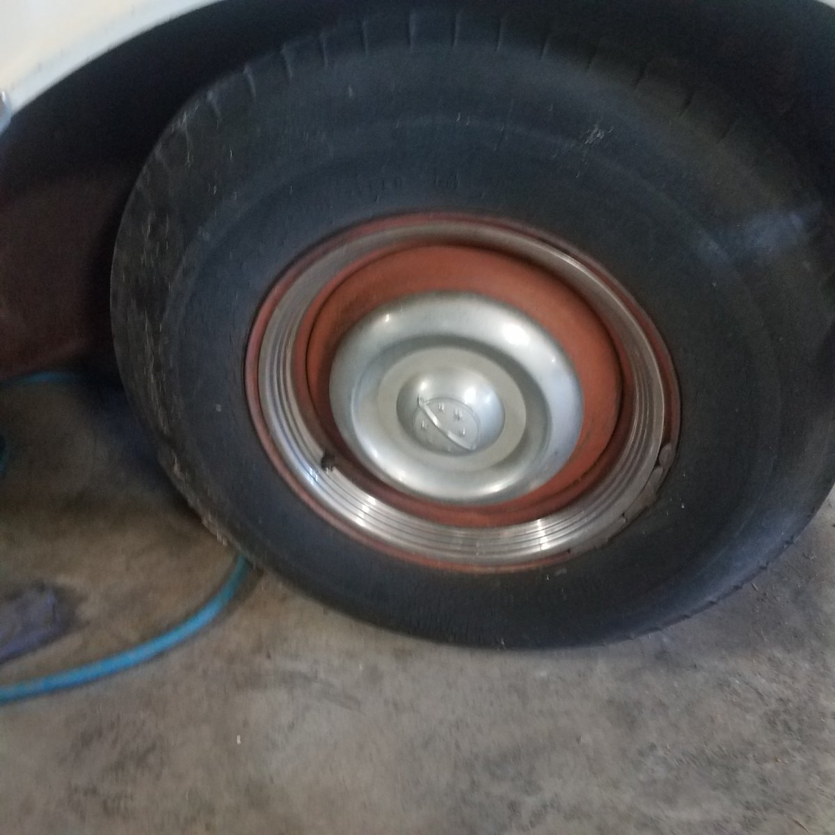

    Hello, I recently purchased a 56 olds super 88 that I would like to build as a 60's style car. I have a 394 out of a 63 olds that I'm going to swap in and keep the stock trans for now. I'm thinking about going with chrome reverse wheels with wide whitewalls and lower the car a couple of inches. Should I reverse and chrome the stock wheels or can I buy them aftermarket? I see speedway has new ones available. I'm not sure what to do with the interior, I think I am going to paint the car rootbeer and cream 2 tone so those will be the colors for the interior. I need to go through the brakes and fuel system where is the best place to source replacements parts? Does anyone know what size tire I should be looking at also? Thanks for any tips.

    Fusicks is a great source for parts. Be aware you will struggle to get a rim wider than 7" under the back guards. I think I ran 235/75/15 on mine.

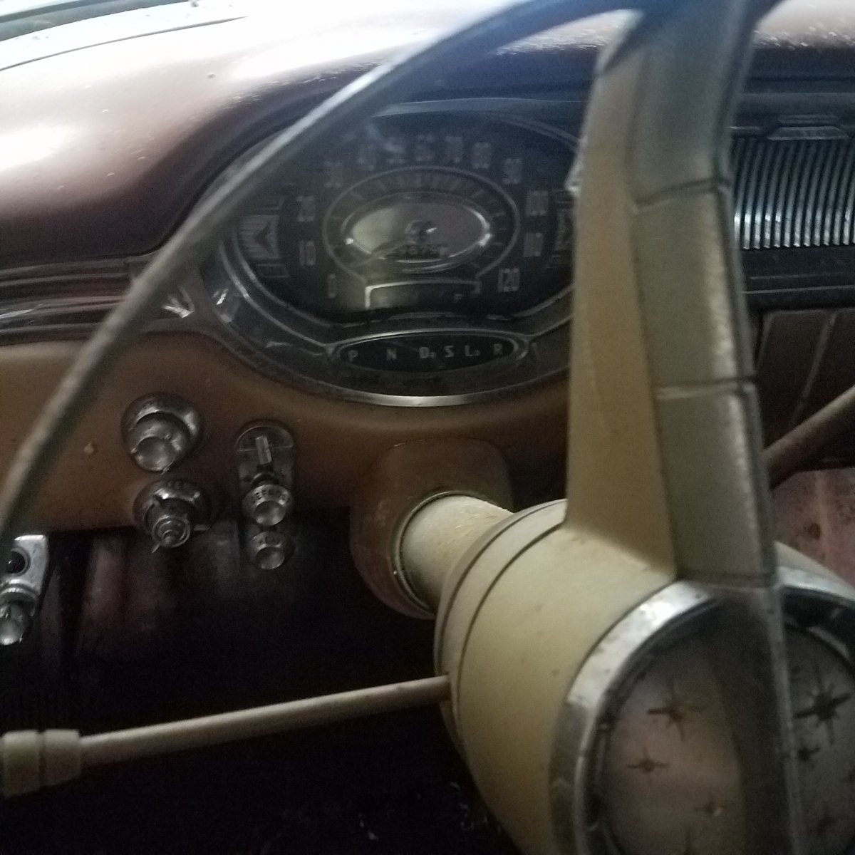

  6. So, is this an 88, super 88, 98? Is it a tudor sedan, hardtop? C'mon, help us out here. If it's an 88, does the trans have a "park" position or does reverse gear act as park after the engine is shut off? If no park on the quadrant, it may be tricky putting a '63, 394 against that trans. If it's got the Jetaway, things get easier.
    If it's an 88 tudor hardtop, it's a beautiful car IMHO and will take the tutone paint scheme really well.

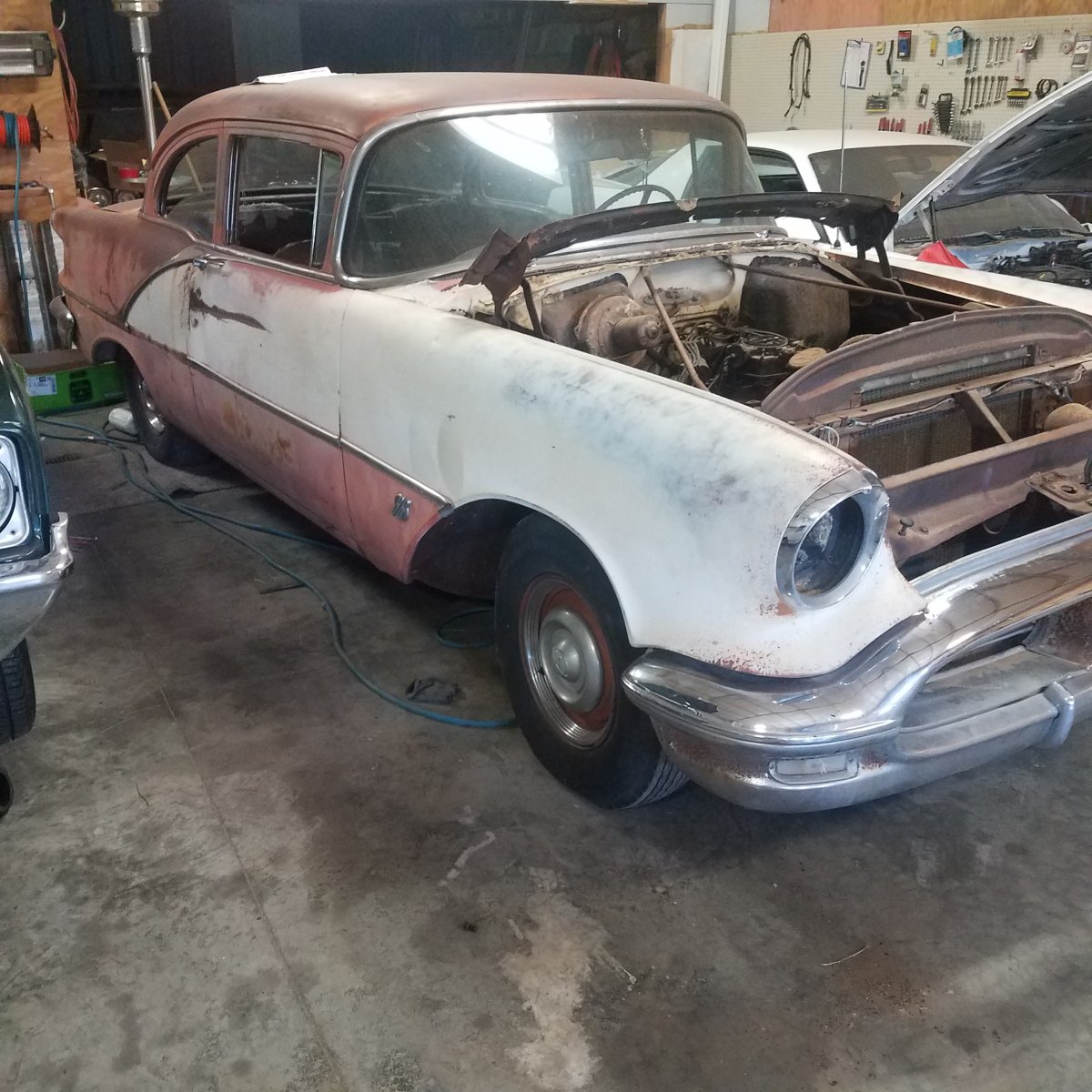

    A few pics. 20190804_123517.jpg 20190804_123456.jpg 20190804_123441.jpg 20190804_123420.jpg 20190804_123409.jpg

  13. I think all I'd do if it were mine is make it run, stop, safe, and some cool wheels... VERY COOL!

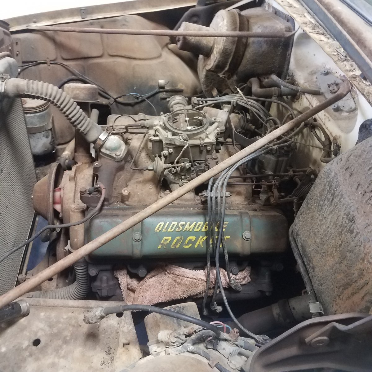

    As far as the fuel system is concerned, rebuild and detail the original Rochester in your picture. Anything else you put on it easily will be a downgrade, unless you are a very experienced carb guru, and don't object to many hours of tuning, and additional parts.
    If you wish a bit more difficulty (and an intake is available - DON'T USE AN ADAPTER); a later Rochester Q-Jet from a 1969~1972 Olds would be better.
    Jon.

    I plan on using the stock carb from the 324 that way I don't have any issues with the trans linkage. I have a book on quadrajets, is there a good book I can get for the 4gc carb to help with the rebuild? Also I assume I can set it up with the specs from the 63 394 to get the metering right?

  24. carbking
    Joined: Dec 20, 2008
    Posts: 3,910
    carbking
    It doesn't work that way. The carburetors are different sizes, so the calibrations for the 394 carb would be incorrect in the 324 carb.
    In my earlier post, I suggested rebuilding the original carb in the picture, not thinking this was the smaller 1956 carb. Please disregard that advice.
    Suggestion:
    Use the 63 394 carb, and transfer the linkage from the 324 carb to allow the transmission to work.
    There are some factory Rochester service booklets on servicing the 4-G series carburetors.
    As far as aftermarket books - no; although Doug Roe did slightly touch on the G series in his book Rochester Carburetors. Acquiring a factory shop manual for a 1963 would have a decent section on the 4-G, and is probably the best single source of literature available for the 1963 4-G.
    Unless you are going radical on modifying the engine, build the 1963 carburetor bone-stock.
    Jon.
