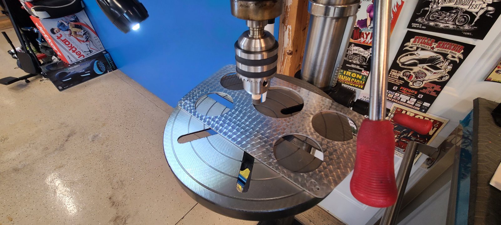

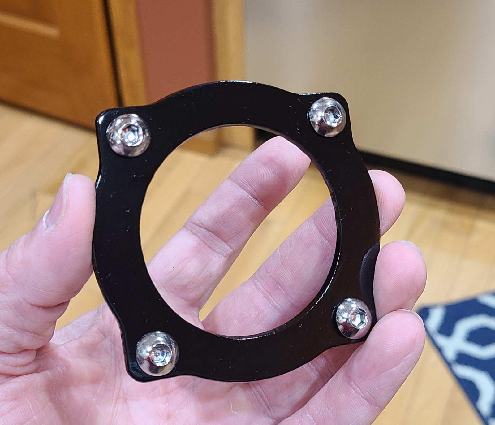

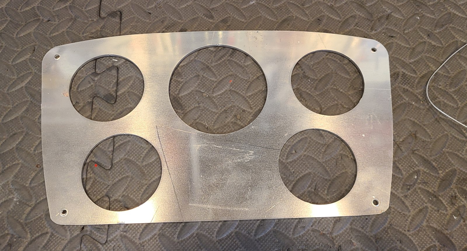

    I can list many reasons why I'm not too fond of Winter. Every year I eagerly anticipate the arrival of Spring. For those of us living in cold weather climates, Winter can begin to feel as if it's never going to end. Several weeks ago we had some mild weather so I took the opportunity to put together an aluminum dash. Several years ago a friend cut some panels for me, since this one was hanging on my dash rack, I thought I would bring it to life. I designed this dash which is modeled after the old Stewart Warner Navigator 5 panel.
    I found a set of gauge bezels that I though would compliment the dash and gauges.

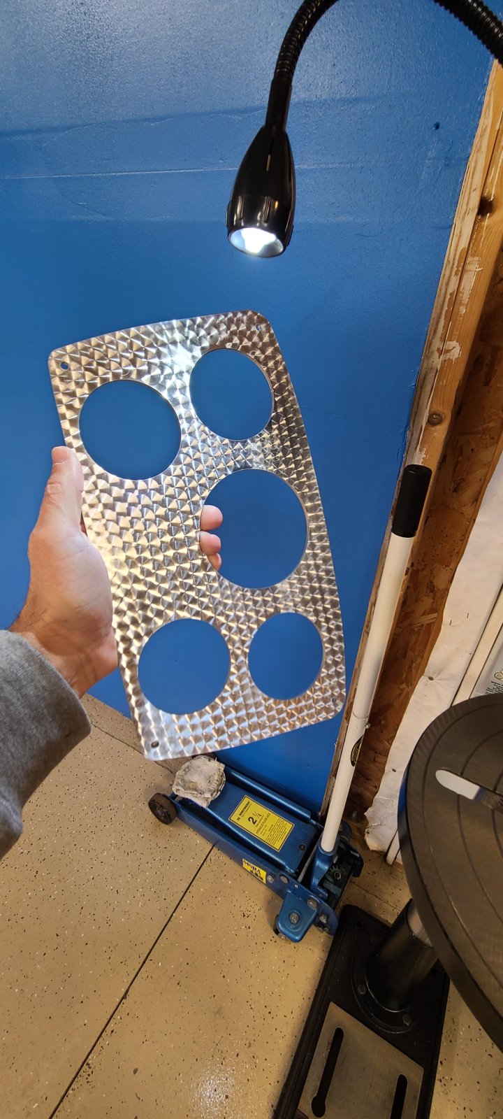

    After polishing the dash I placed it in my drill press for some engine turning

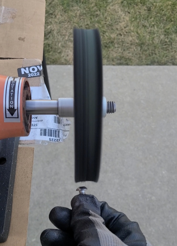

    I bought a bag of allen head bolts and gave them a good buff and polish.
    This took far too long, but they sure turned out nice.
    After some prep I was able to get the bezels painted.

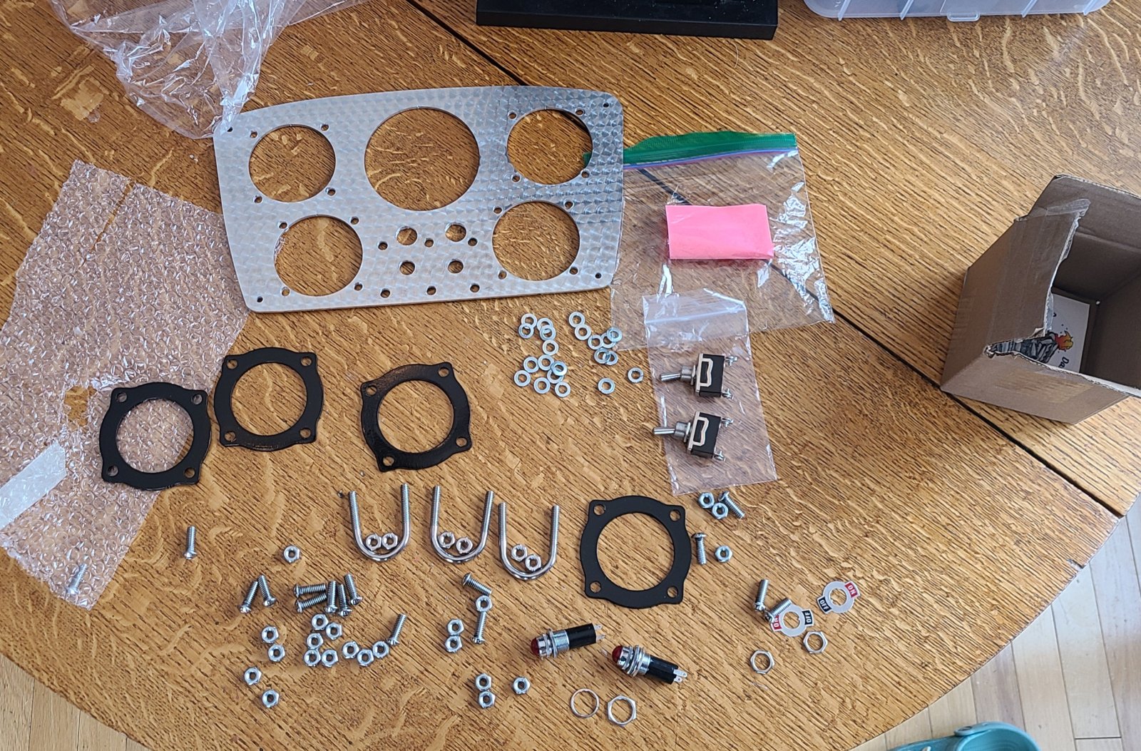

    After drilling far too many holes, it was beginning to take shape...

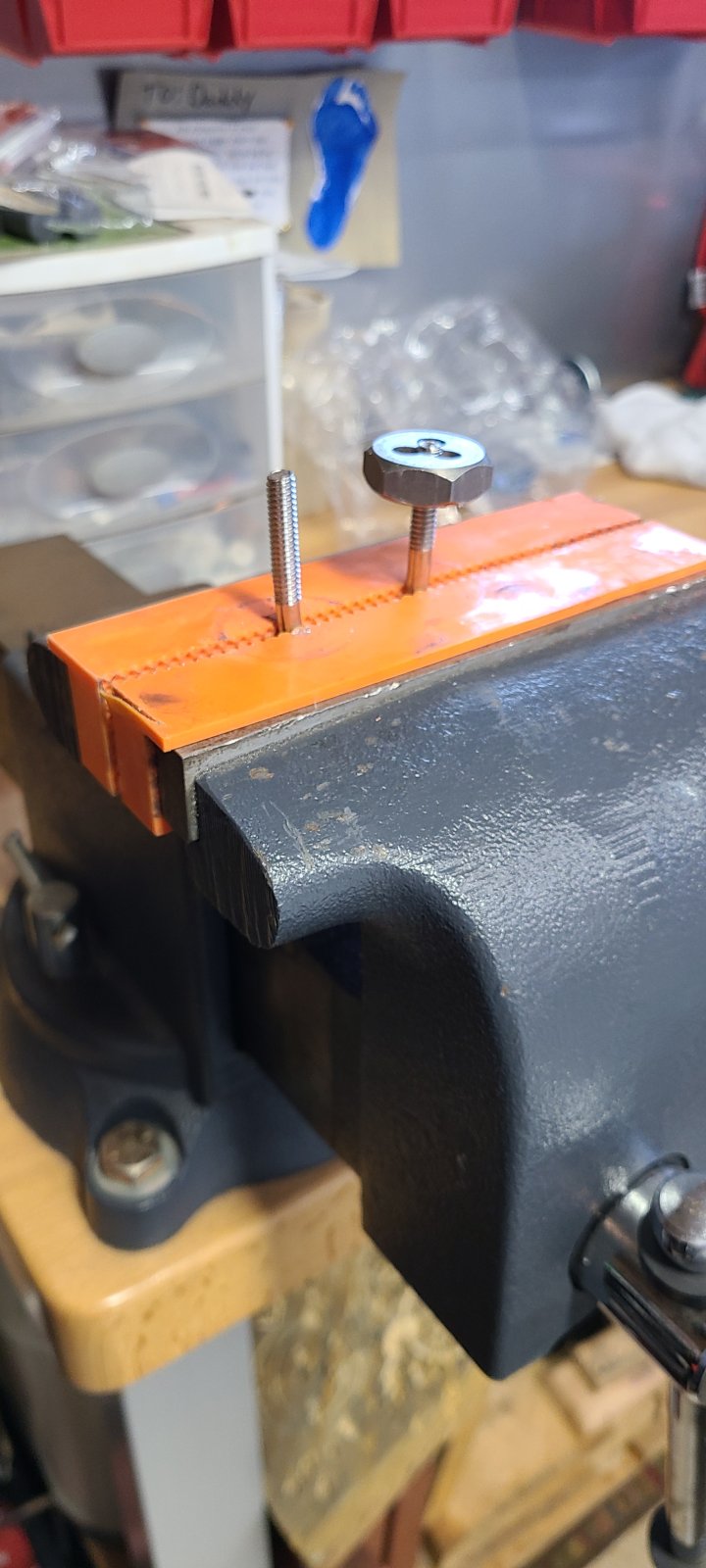

    Then it was time to put some threads on the toggle switch guards

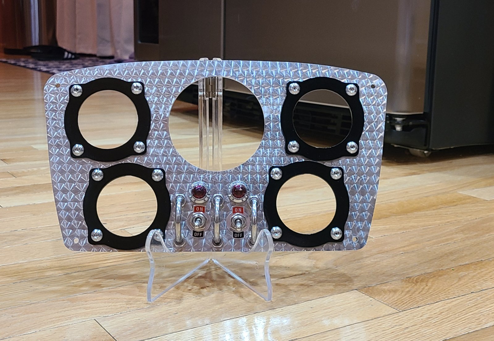

    Old Man Winter was nice enough to drop 12" of snow on us and dip the temps into the single digits. The good news is I was nearing final assembly so I could work on it at the kitchen table while the wife was at work.

    Nice dash! How did the engine turning go around the gauge holes? We used to engine turn the panels then drill the gauge holes. Really like the U bolts around the toggle switches. Bob

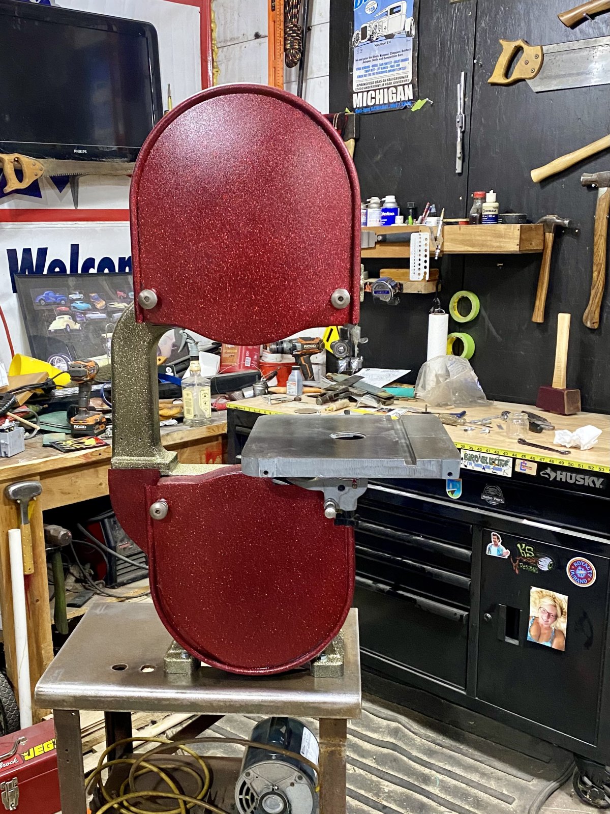

    Nice! I bought a 70 yr old bandsaw and gave it a rebuild with a custom paint job to keep my mind and hands busy.

    With aluminum such as this dash, it can get pretty tricky as the sharp edges around the gauge holes really mar the Cratex stick. This causes your swirls that are near your gauge holes to look rough as the stick mars when it catches the sharp edge of the hole. Also, because aluminum is so darn soft, you can only allow the Cratex stick to contact the aluminum for about 1 second at most. Otherwise you run the risk of creating a rough looking swirl. Because I used gauge bezels on this dash, I had a little fudge room and didnt have to run the Cratex stick against the holes.
    I find that stainless steel and copper are really friendly to Cratex sticks and you don't typically run into that problem.
    If you have access to a Water Jet, CNC machine, or laser cutter, I wonder if it would be best to engine turn a sheet of material first, then let the machine cut out the dash and holes. I think that would be best when using aluminum.

  26. flatheadpete
    Joined: Oct 29, 2003
    Posts: 10,634
    flatheadpete
    from Burton, MI
    I just got it going tonight so these pics are a week or so old. It works great and was a delight to work on!

  29. 210superair
    Joined: Jun 23, 2020
    Posts: 1,972
    210superair
    from Michigan
    That saw is hot rodded out Pete! Awesome!
