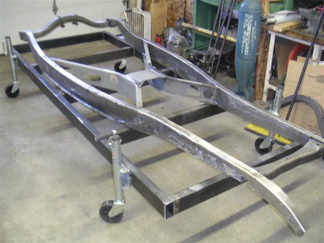

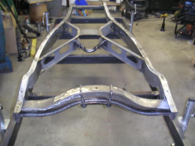

    This is my Rolf inspired 26T coupe build aka: Alien Brains. I thought I'd do something a little different for a T on put it up on rails. Next up will be a 6 inch chop and installing the 4 deuce Olds 324 with a T-5 behind it.
  2. I like the way the 32 frame fits the Model T body profile. Did you build it yourself? Any pictures of the fabrication?

    I put the body on a sheet of plywood and traced it for the profile. I then pie cut the rails front to back to follow the shape of the T. I think it was about 6 cuts total plus one more in the rear to bring the rear frame horns back out a little bit.

    Dammm you nailed it...that is how I would build one. I will be watching.
