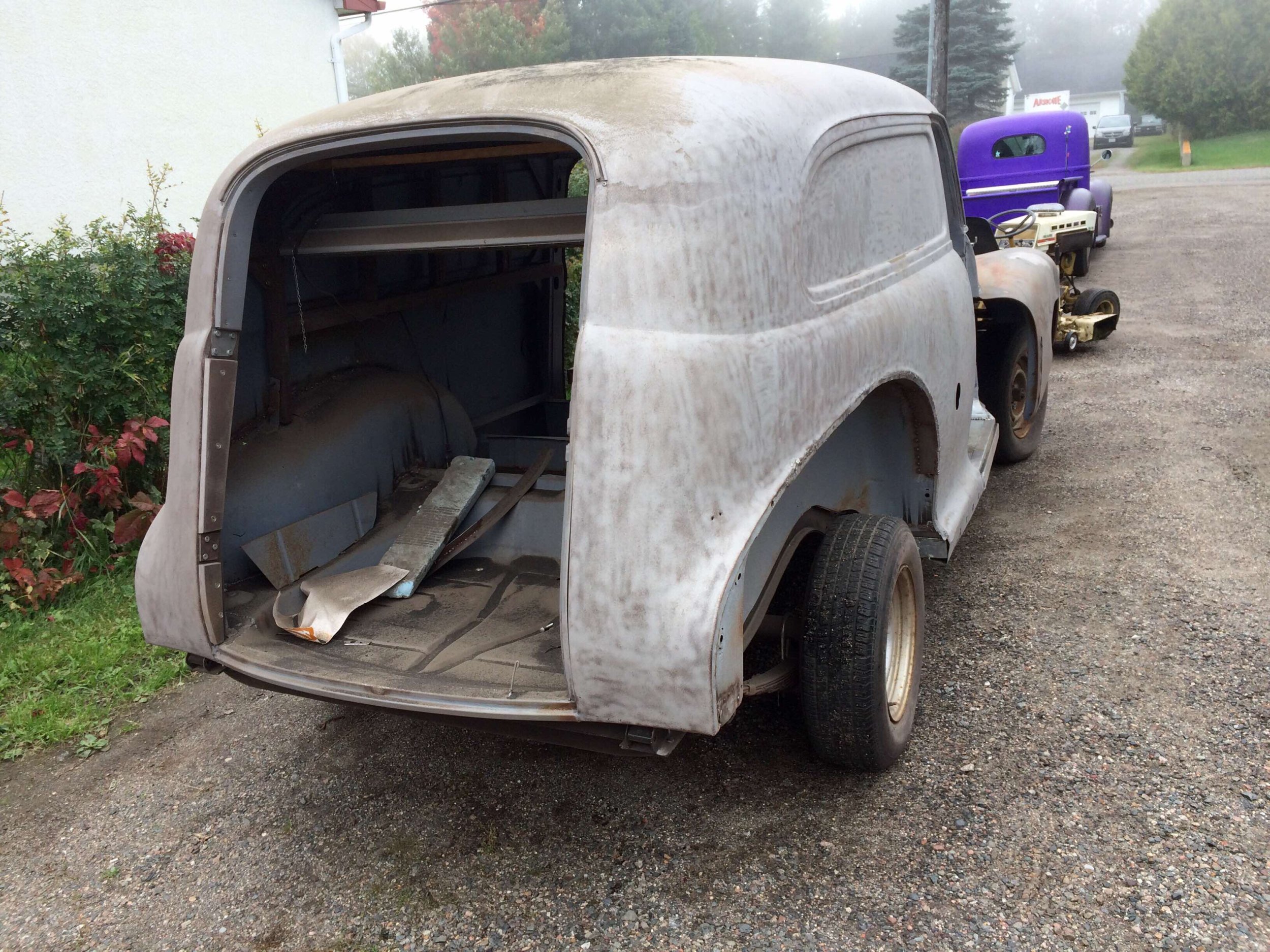

    Thats gonna need a ****load of bracing before it comes off the frame to be dipped!
  3. You might not get much back from the dipper. Can you find a better body tub to work with ?
    Resurrecting that old girl is going to be an adventure.

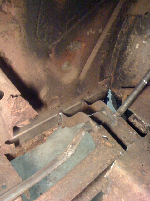

    It's already been braced a lot.
    I don't have a current pic and the floor isn't skinned yet, but the bracing is in. It's in the factory locations, but is made out of rectangle tube and thick steel, instead of trying to recreate bracing by bending and sandwiching sheet steel like the factory did.
    Since the car was not really supported at all, we used straps and jacks to get the body "square" and adjusted the doors so they closed nicely. Once the doors were in a good position, we welded in what you see here:

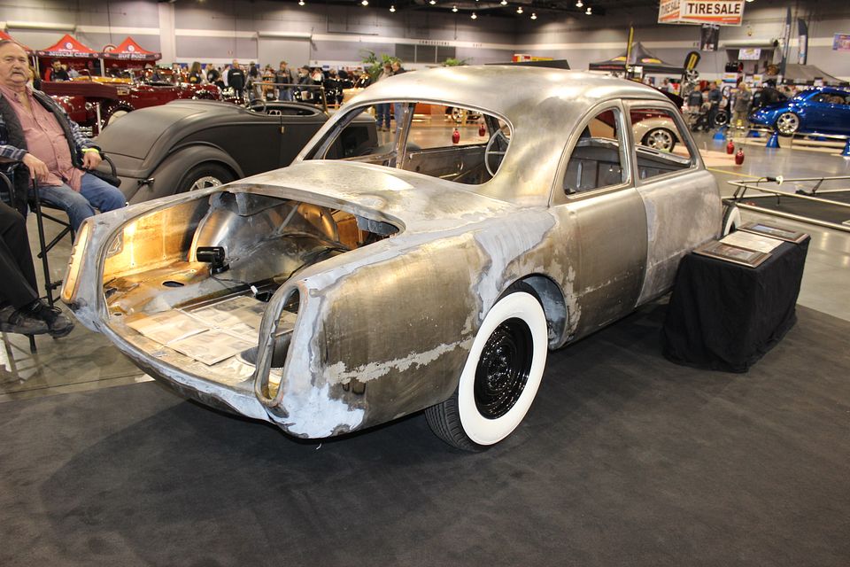

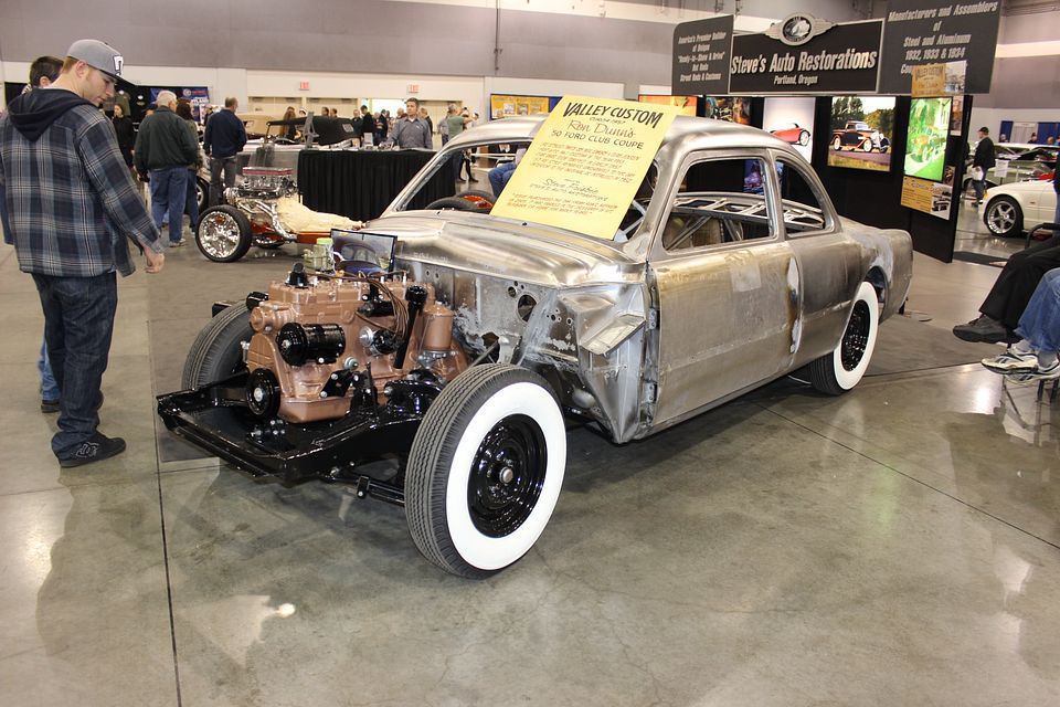

    Back in 2013 Steve Frisbie (Steve's Auto Restorations) had the Ron Dunn shoebox Ford at the Portland roadster show as it was bought.
    In 2014 at the roadster show they had it in bare metal after it was stripped.
    I'm thinking that the same shop that did Billy's hood did that car. The cost isn't cheap by any stretch remembering what it cost to have my hood stripped in Tacoma before it was Louvered in Bremerton in 1981.

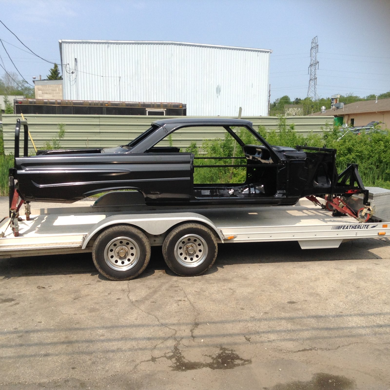

    As mentioned above I highly recommend Restoration Spe******t in Franklin Wisconsin. They have been doing work for me for quite a while with zero issues.
    The key to a good job is preparation!
    After the parts are chemically stripped they should be ecoated. ( you don’t paint a part without primering it first do you?) After ecoating the surfaces should be scuffed with a Scotch brite to promote adhesion. I have never had issues after the process, over the years I have had many parts and bodies stripped.
    Here is my Cyclone with the body stripped ( fenders and doors have been ecoated already) and the body after ecoating. I normally have the parts stripped “80%” then bring them back to my shop for metal work, when the fabrication and metal work are completed I send the parts back for a final strip and ecoat.
