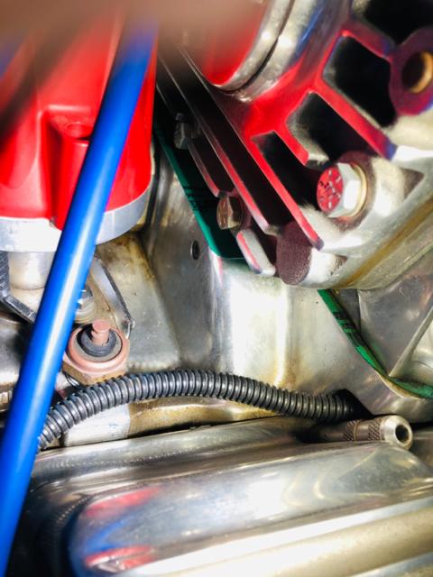

  1. I don’t see an inlet port between the blower and intake manifold to connect a boost gauge. It’s an older Hampton Blower. IMG_0160.JPG

    You may have to drill a hole and tap it 1/8” pipe thread in the intake manifold to hook up the boost gauge most blower intakes do not come with one

  4. It would be between lower flange of blower and engine? ....Thanks wrenchbender

    Maybe drill and tap the pop off plate.... That should be easier... No????

    Drill and tap is the answer , twist a small coil in the tube for vibration and back fire protection .
  7. Good idea, ...Thanks

  18. Thanks guys, I found a large Allen set screw on the lower flange of the HB Blower, it could be there as a port to connect a boost gauge or something that shouldn’t be messed with. Here are more pictures....any thoughts [emoji16][emoji106][emoji106][emoji106][​IMG][​IMG][​IMG]

    Looks to be a 1/8” NPT plug and yes, you can connect a boost gauge there.

    yes, this is the port where you connect the boost gauge. Just remove the plug.

    Yes it did and since it was afterthought it sure beat pulling the intake off and drilling/tapping.
