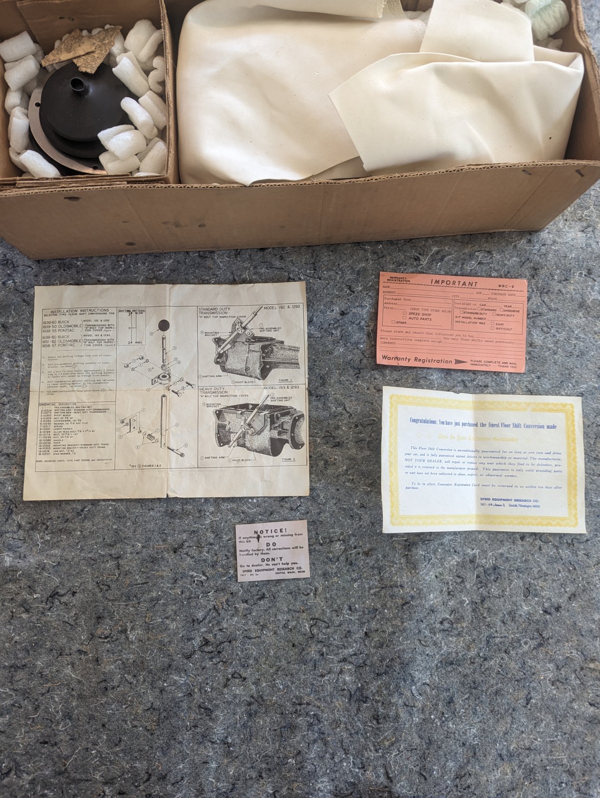

    I have a NOS Drag Fast conversion for sale currently. Unfortunately, it's for the 5 bolt cover Pontiac trans, not your HD 6 bolt cover.
    Zoom in on the installation instructions to see how the shifter for your transmission was set up.

  13. tubman
    Joined: May 16, 2007
    Posts: 8,223
    tubman
    Boy, the pictures in the Drag Fast instructions sure look a lot like the one I made. I'll bet the heim joint I used for the top pivot worked even better than what that shows. Same for the heim at the bottom.
    I don't think it doesn't matter that much whether it's for a 5-bolt or a 6-bolt. The only major difference is the mounting bracket, which would be easy to make. I used a piece of 2" X 2" angle mounted on the top bolts.
    Ahughes likes this.
