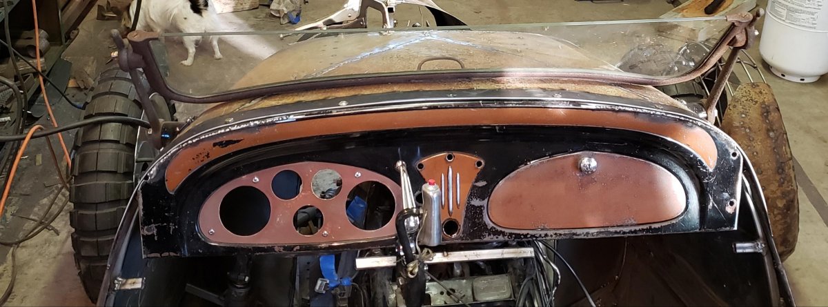

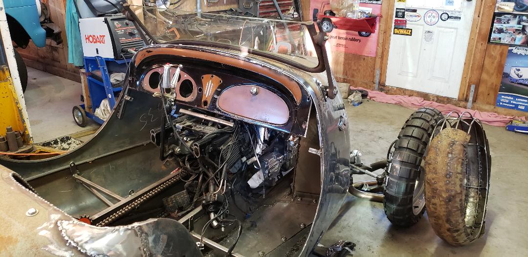

    Cleaned up a 34 Chevy dash and roughed in. Also neither me or Rex are impressed with my fenders progress. I'm too invested to stop now, hopefully will look better once I switch from big hammers to little ones.

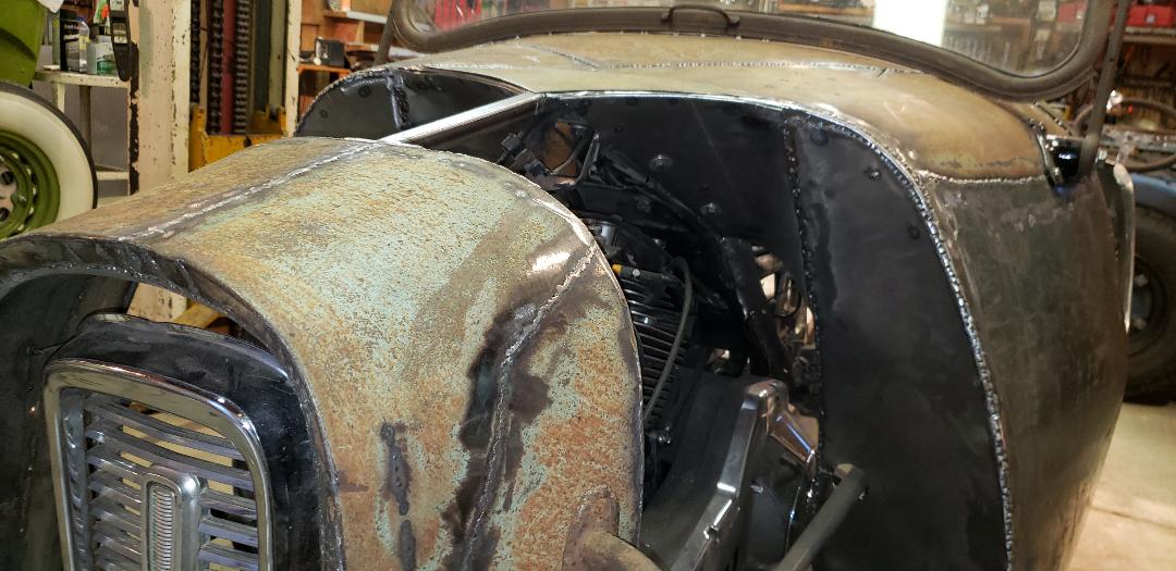

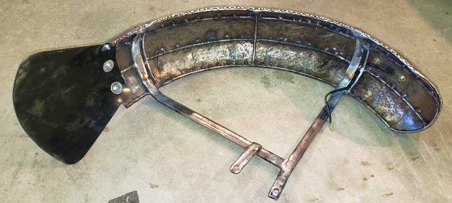

    made a little progress on fenders and grille surround.

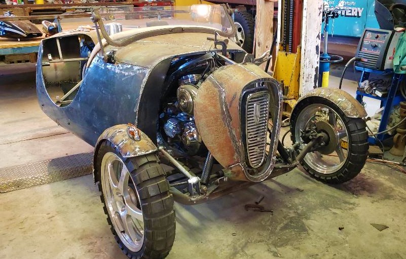

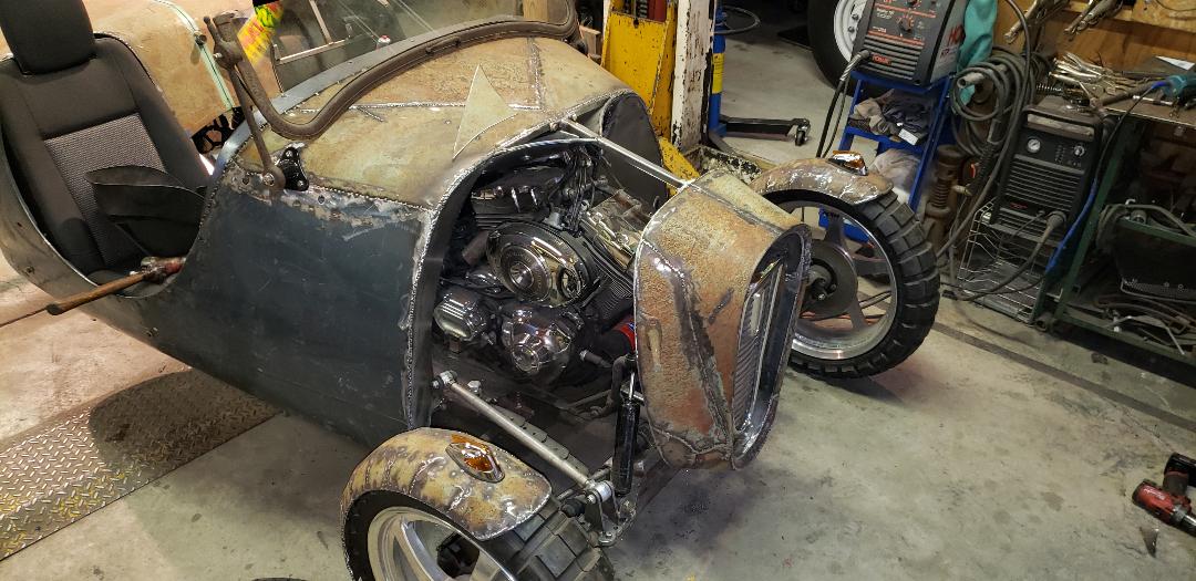

    Been working on structure under skin, I really like this 3/4" x 3/4" (1/8 wall) square tube. Also couple of current pics...

    nothing exciting, made some crude fender struts and mounted mud flaps. They are kinda springy when mounted, gonna add alittle more structure, just not sure what kind yet...

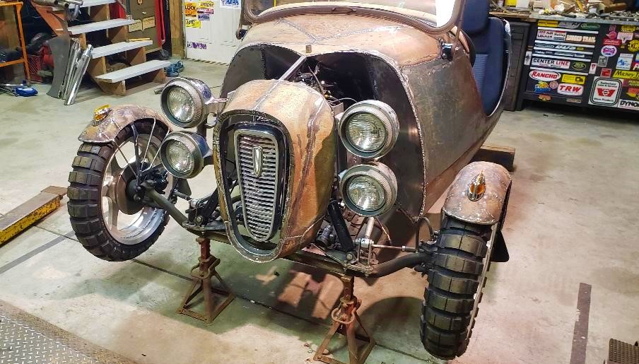

    Removed grill etc... final welded, sprayed some flat black inside and did an initial cleaning of headlights. Had to take a couple pictures out in the sunlight....Rex still don't seem very interested. It's also got pretty heavy, I added to more 2 mounting points (total of 5 using 8, bolts)
