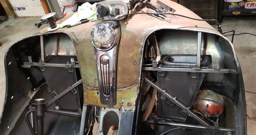

    Finished the chain guard and area between seat backs, (yup, I'm pretty sure the fuel filler will be under the original HD tank chrome/cap) and also mounted 3rd brake light.

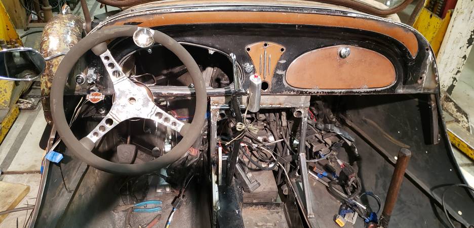

    Thanks Pumpman; just been working on the slow process of the under dash also....

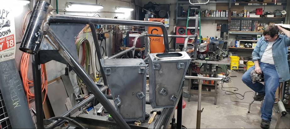

    Started on the fuel tanks, will be using the "guts" out of the factory tank and making 2 small tanks (one behind each seat) It's gonna be a quite a few hours of work...

    Got the fuel tanks tacked up and I'm lucky enough to have great welder as a good friend. (thanks Dave) While he's welding I'm routing fuel and brakes lines etc....
