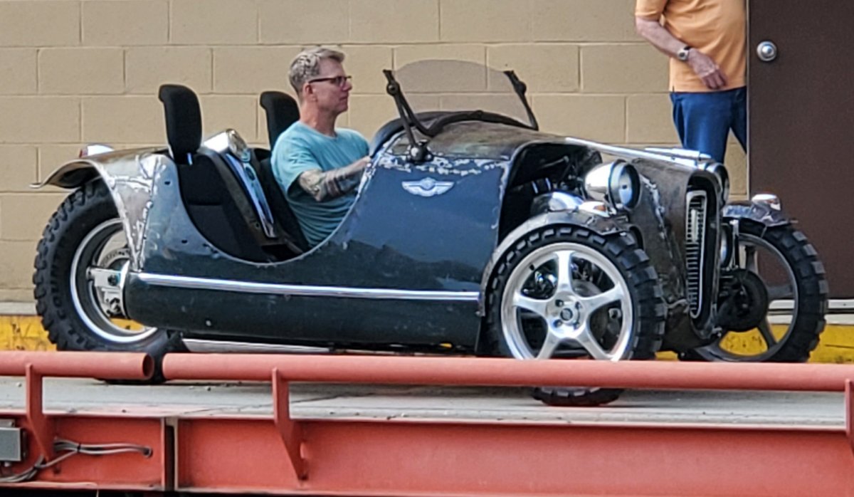

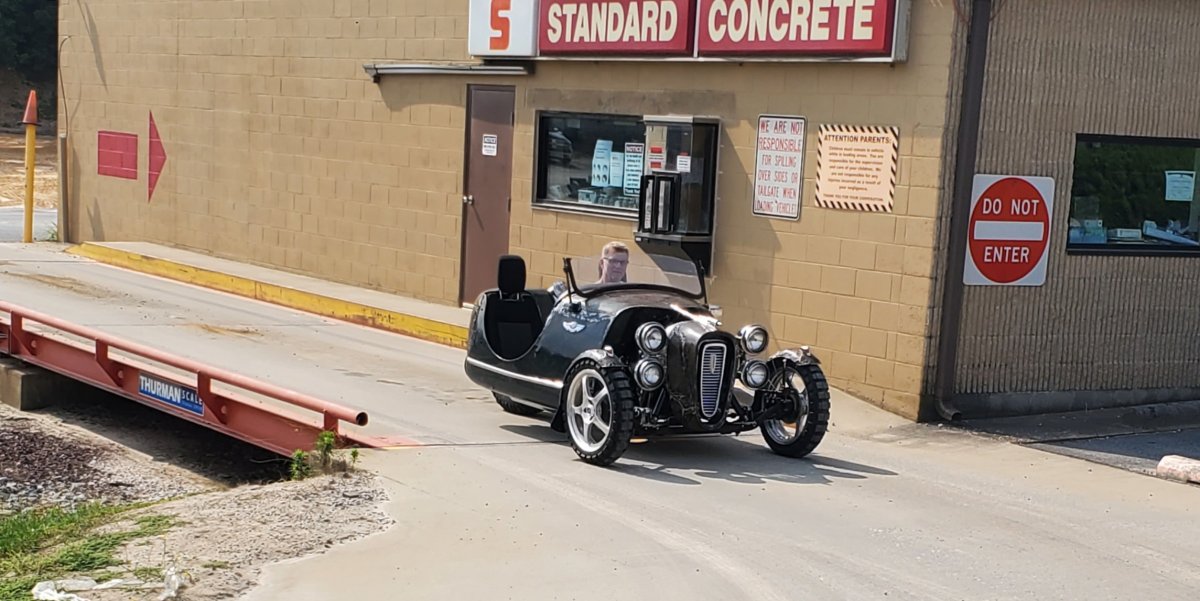

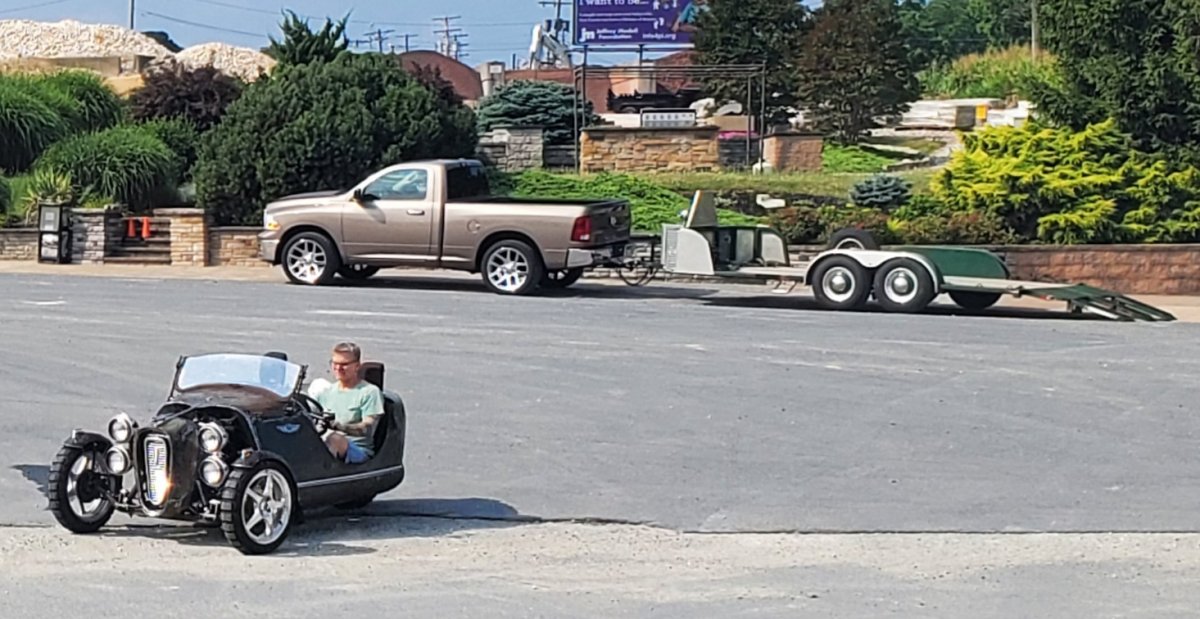

    Took to get weighed and a "Pre-Inspection" look at by PA certified "enhanced inspection mechanic" yesterday. Got few little things he wants changed, but now am ready to finish welding and painting ch***is.
    It weighted 1320 lbs. including me...
