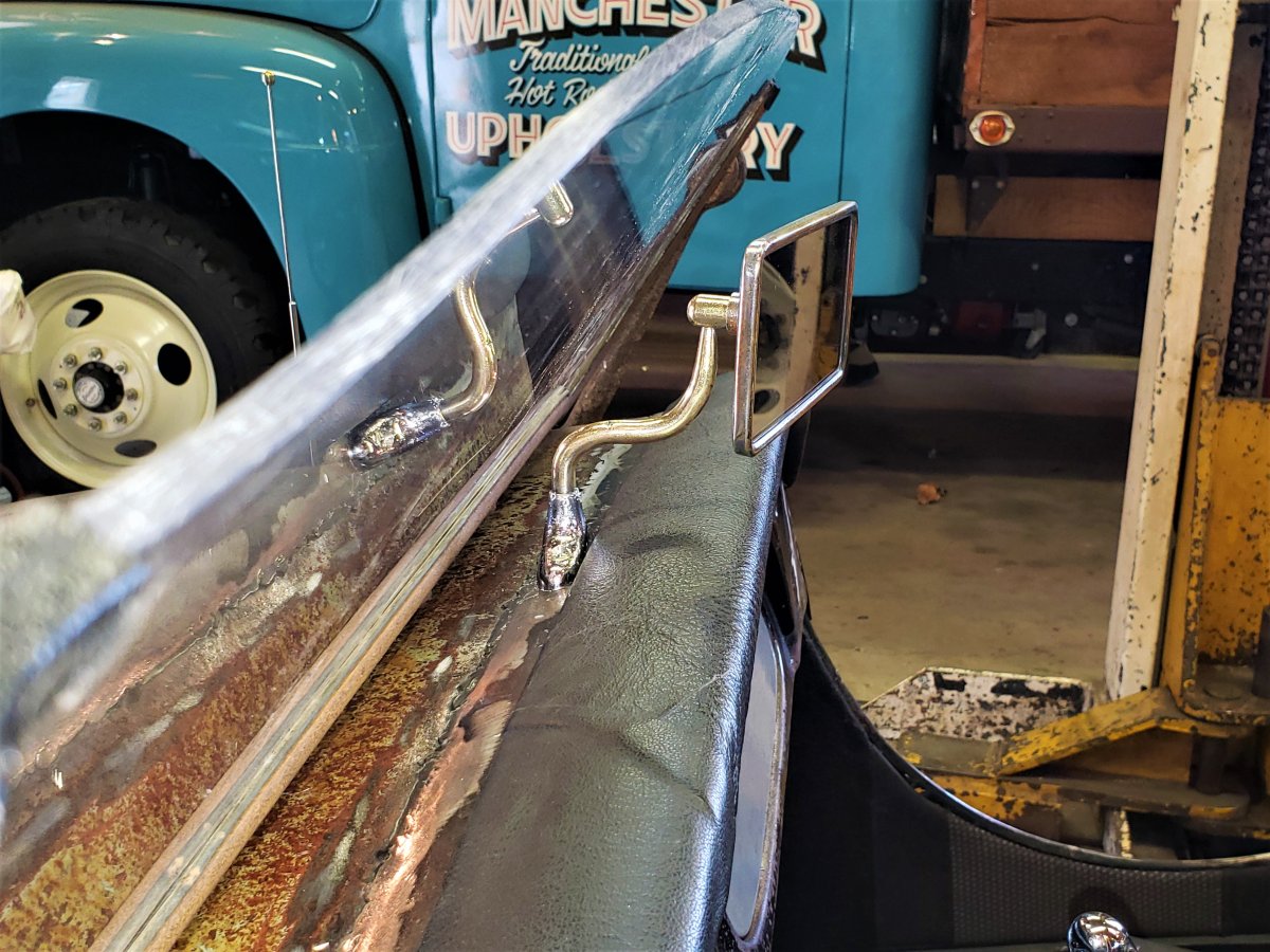

    Had the Trike out a couple weekends ago, got me motivated to get back on it...

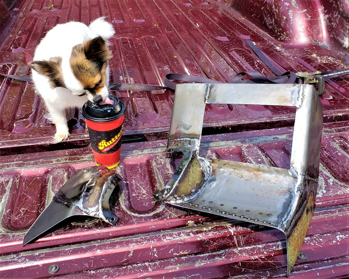

    Not sure what this rear view mirror came off, but a couple bends and it fits and will work good. Also made this center console, radio bezel, shifter boot hole thing using a couple little pieces of the hood I used for the body. (had to make out of 2 sections due to size of shifter/clutch lever)

    That little dog should get the caffeine monkey off its back lol;)
    '52 F-3 likes this.
  13. '52 F-3
    Joined: Sep 30, 2007
    Posts: 961
    '52 F-3
    from Central PA
    Yes, him and myself... lol
    He's a long haired Chihuahua and really doesn't need any caffeine. But if he ever gets a chance, he's all over my coffee cup. I wish I had 1/4 of his energy...
