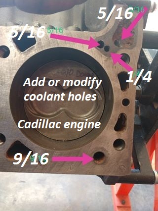

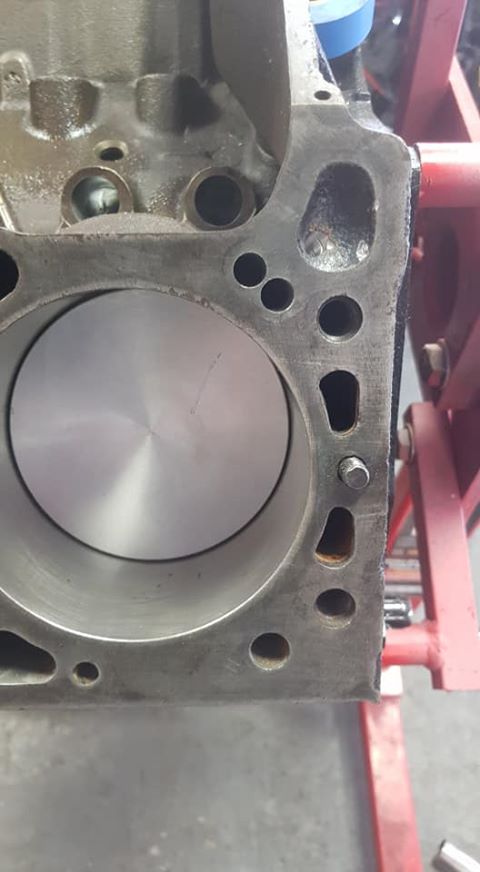

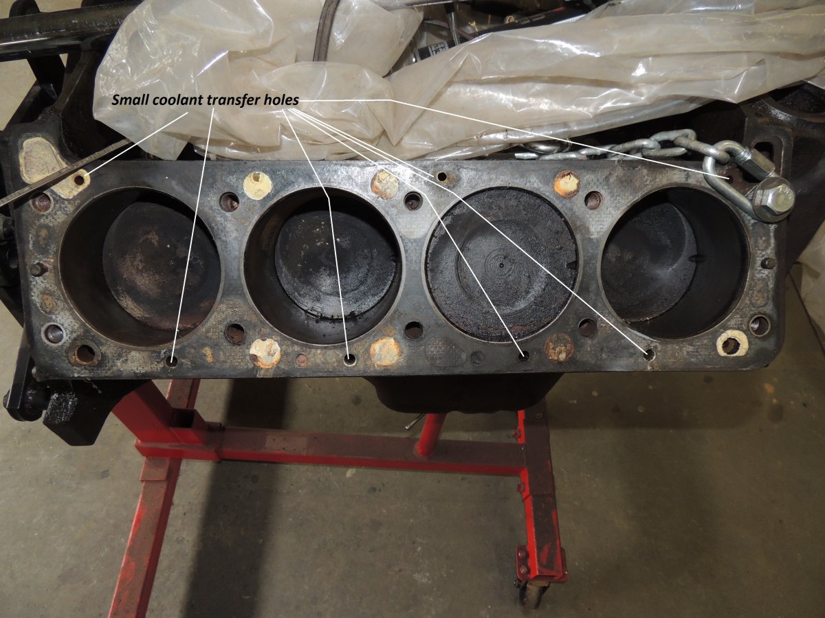

  5. ekimneirbo
    Joined: Apr 29, 2017
    Posts: 4,218
    ekimneirbo
    I'm not a Chrysler guy so I don't know specifics on them. If you look at the top of your block where the head sits, you will probably see that there are many open tops to the waterjacket that do not p*** water to the heads. You may see some that are only blocked off by the head gasket as opposed to the head itself. The question is how to create flow that works, and I can't answer with a blanket comment for all engines. On some 500 Cadillacs guys are working to get temperatures lower because many of them run hotter than preferred when installed in other vehicles. On the Cad there is a rather small hole at the rear of the block. The hole allows water from the block to move up into the head. Some have experimented with enlarging this hole slightly and adding a couple of extra small holes. This seems to be sufficient for cooling the engine. I think the idea is that the water needs to circulate from the rear to the front rather than possibly circling up too much at each cylinder and the water in the rear never completes the cycle back to the front. Again, I "think" thats what is happening. The gasket manufacturers must have a reason for blocking p***ages.
    Anyway, this is what some people are doing to 500 Cads if thats any help.
