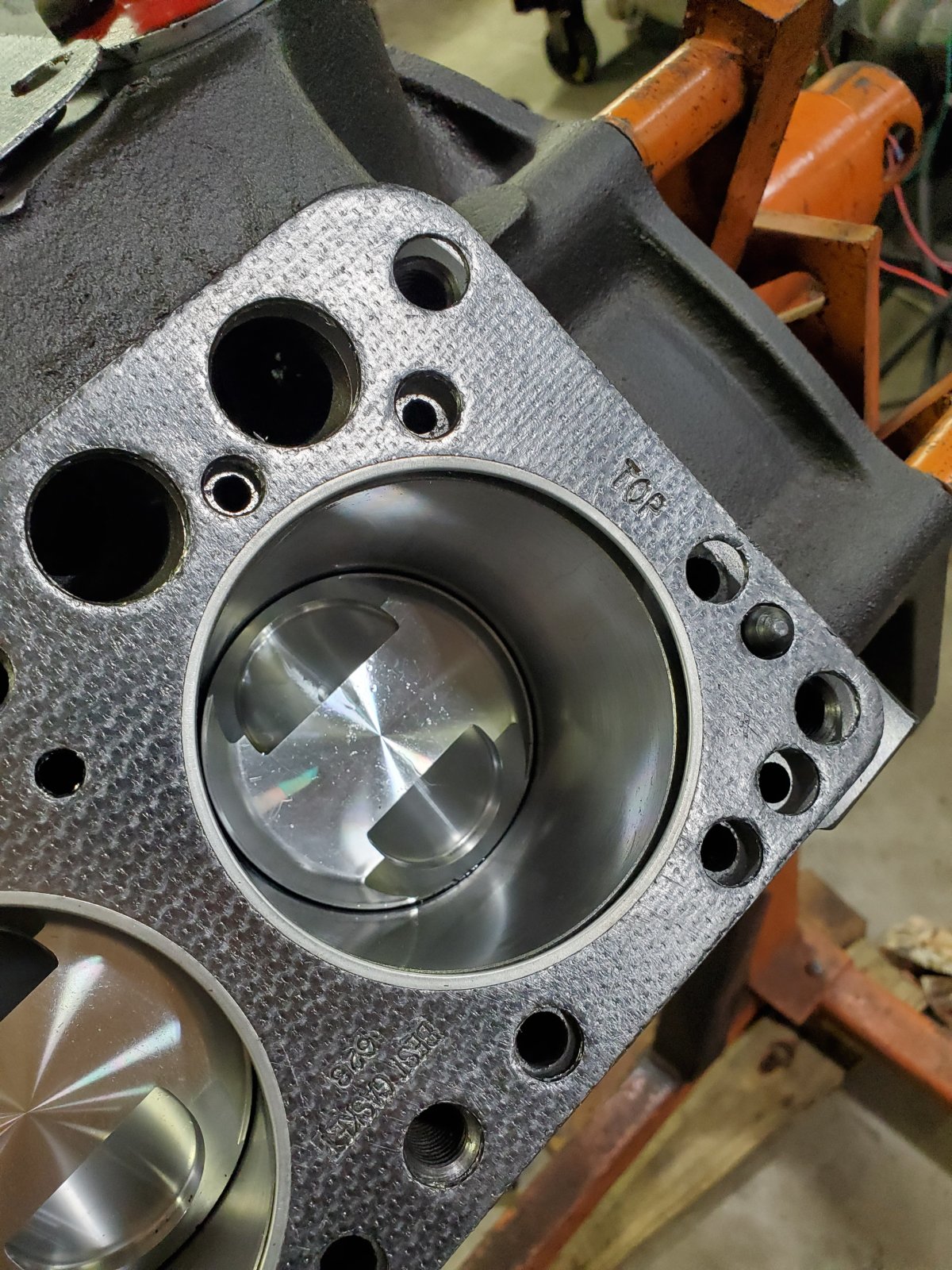

    fresh machined surface block and heads,
    241 dodge hemi, install the head gasket dry or spray it with something

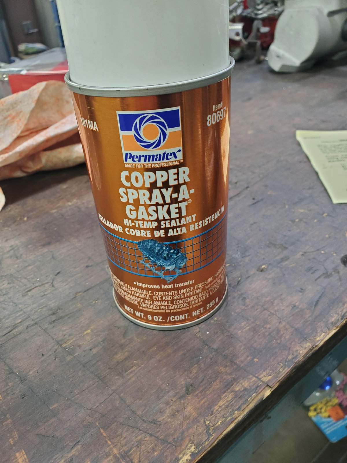

    I use this. Spray both sides. I’ve never had a leak

    It looks to be made of Grafoil which i believe you only install dry. The graphite bonds well to the machined surface and generally can not be reused because it bonds so well.

    Best head gasket for a 241 Dodge is #628G. Install them dry.

    I’ve done them both with spray copper seal and right out of the package on regular street engines and never had a problem. I would lean towards using the sealer for sure if the surfaces were in doubt but yours have been resurfaced.

    We have a can of that, but I'm leaning towards dry based on the type of gasket

    Those go on totally dry! They are graphite impregnated DO NOT use sealer or grease!

    Copper and steel shim head gaskets get a coat of something, but graphite gaskets go on dry.....

    Felpro and graphite dry. Steel gets copper spray. No failures so far.

    Thanks everybody, installed dry and torqued down,
