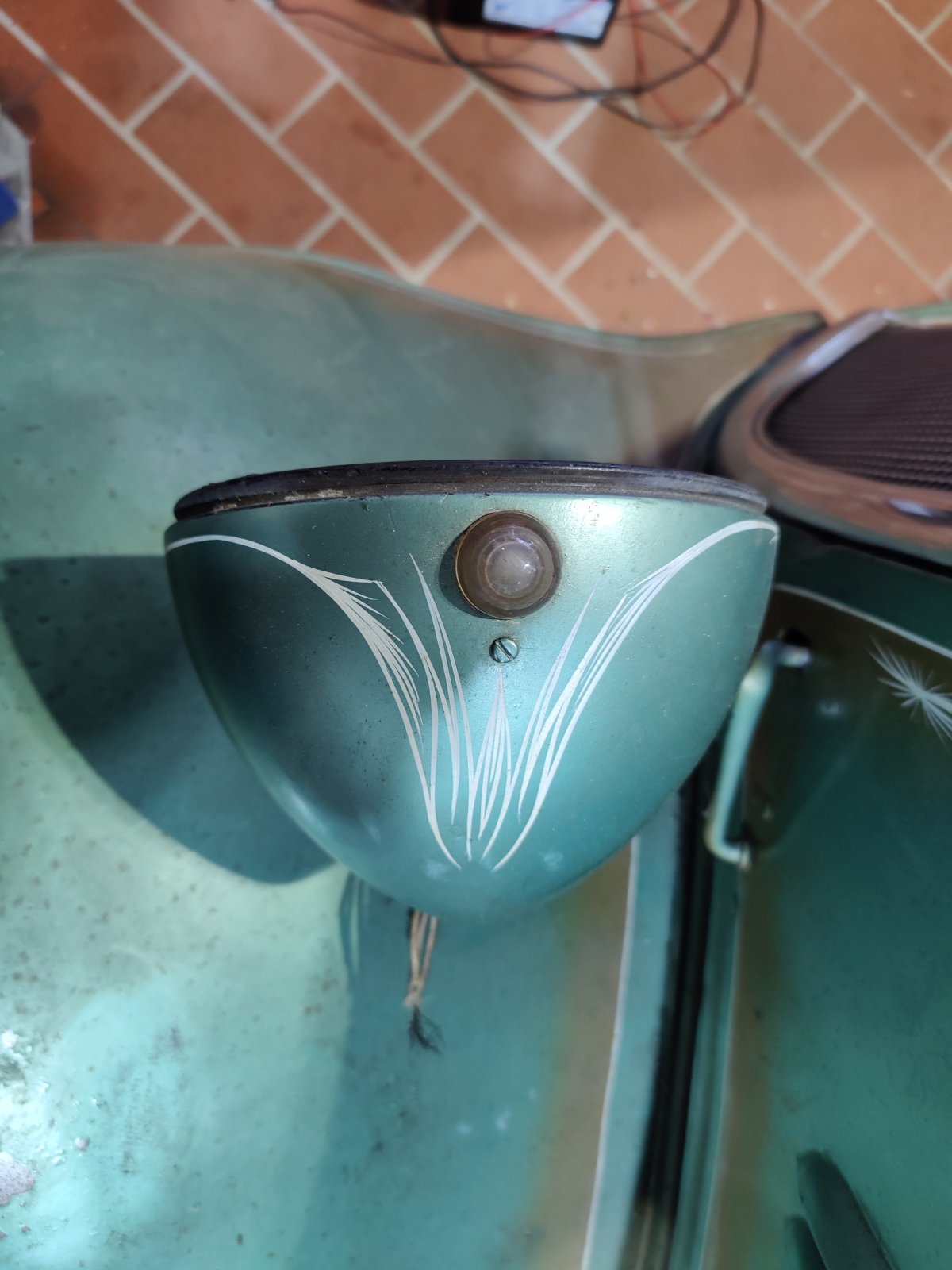

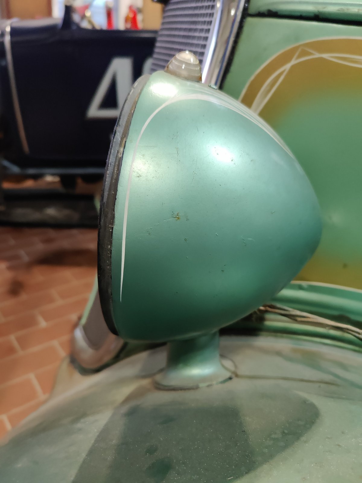

    I recently bought a '34 Ford Roadster that is an old hot rod/custom car and has sat unused for many, many years. As to be expected some parts went missing during this time... In order to slowly bring the car back in the road without destroying too much of its history, I am starting to collect the missing parts. Unfortunately also the headlight reflector inserts, rings and lenses are missing and I have no idea what type of headlights were used. They are smaller than the stock '34 headlights (about 8" diameter) and have a small gl*** marker light in the top (which could also have been added later)... I would appreciate any hints to what type of headlights these could be and/or where to get the missing parts... IMG_20210925_182500.jpg IMG_20210925_182512.jpg IMG_20210919_110120.jpg IMG_20210919_110124.jpg IMG_20210925_182517.jpg IMG_20210925_182452.jpg

    The lens on mine looks very similar. Maybe you are just 03E55546-6A7B-4931-B3CF-7F42FE62AC1E.jpeg C22C6D0C-D932-4462-B953-AF2A15784B10.jpeg missing the metal part that holds the lens in place.

    I believe they are Guides...no ID plates to be found?

    I think they may sell just the rings in chrome and or painted...or look in the cl***ified here...
    http://www.otbgear.com/GuideBLC-682-C-Chrome-Trim-Ring-P65.aspx
    :rolleyes:...trim ring link...
    :rolleyes:...required bulb...note these are gl*** and have a Hi/Lo Halogen Bulb and are non replaceable...just get a new bulb when it burns out...and they work pretty darn good...​

    I believe I recognize this Hotrod...does it have Bobbed lower fenders minus the running boards...It was featured here in a Thread a couple years back...
    Congratulations on getting it whether or not it's it...please tease us with a pic...the striping is talking to me...
    The notches in the bucket where the headlight rests are alignment slots for the bulb...

    Check out the B-L-C headlight guide on google, this looks like a 904 style light and it says that OTB has rings to fit. How about some more pics, looks interesting as it sits? Thanks, Carp.

    BLC 904 a

    That car was for sale here in the cl***ified's. Look like Dietz lights to me, usually something will be stamped in the bucket, sometimes at the back, maybe filled with paint and hard to see unless sand blasted.

    Many thanks for all the quick answers! The lamps Seen to be indeed BLC 904a and now I also know where to get the needed parts... The knowledge of H.A.M.B again amazes me...

    The gl*** lenses are nowhere to be found and not reproduced. I bought a pair to get 1 cracked lens to replace the missing 1 on my avatar. I did buy some Lucite to hopefully turn some lenses on the lathe but that hasn't happened yet.

    I think that every normal 7" headlight insert should fit, using the reproduced OTB outer rings and insert rings... There are many different 7" inserts on the Market and I even can buy some over here that comply with the local government rules to be street legal...

  16. BLC 904 A , I have a pair at home , away for the week , pretty sure they use a standard high beam/low beam headlight .
    Also known as a perculator headlight as the gl*** lens on top is similar to a coffee perculator. Great Lights !!!

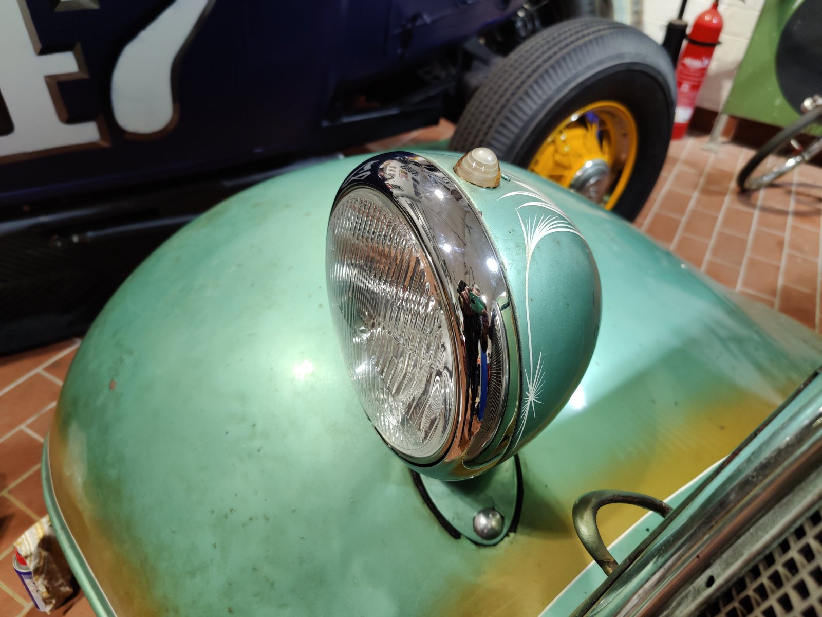

    Just a quick update: The OTB rings arrived quickly and fit very well...at least the car has eyes again now... Thanks a lot for the helpful tips! IMG_20211015_212923.jpg IMG_20211015_212941.jpg
