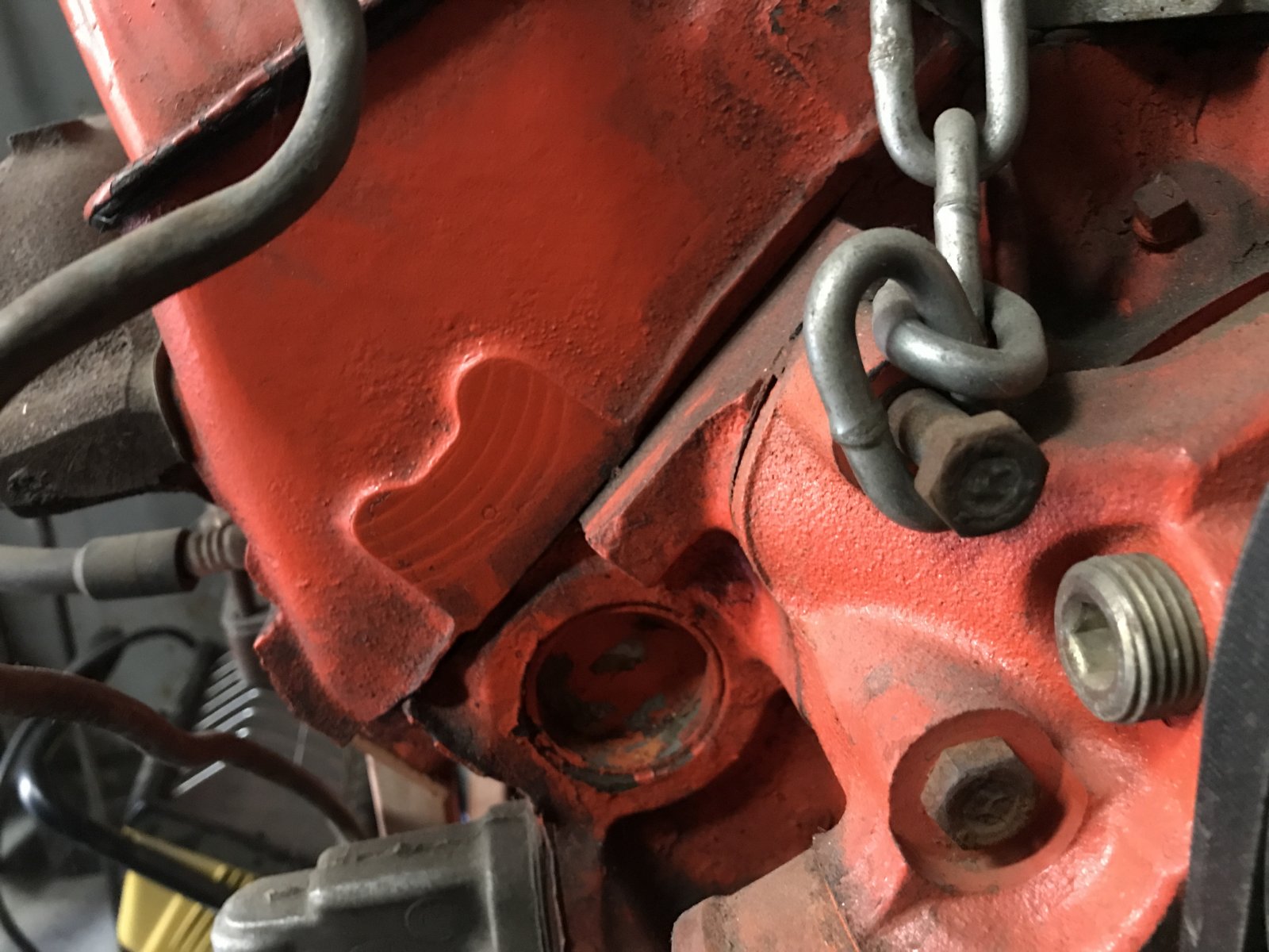

    Hello all, I'm in the process of tearing down and redoing a 1940 chevy, it has a 283 small block that sounds like a mild cam in it and runs good. Anyway trying to figure out what the heads are. The stamp looks like 354484 but I think it might be 354434? I ***umed double hump by the two castings. I can't find anything that would be a camel hump with that number. Thanks for any info. 20220717_115850.jpg

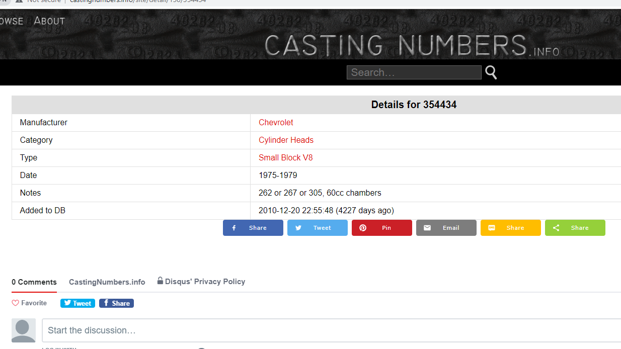

    Josh....for the purposes of terminology...those are casting numbers. 354434 is a 262/267/305 head...Chevy had some weird small V8s in the mid to later 70s. The casting date J26 76..is October 26, 1976 for a 1977 car. Sorry no camel humps here..

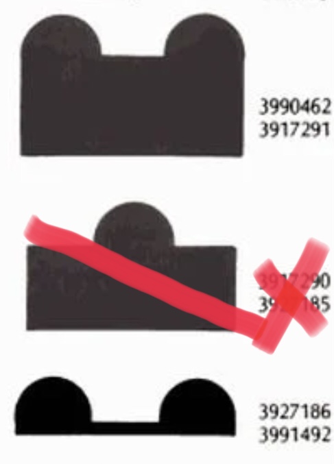

    The top image is the original “double hump” casting identifier and even though some do not consider the bottom one a double hump it is, but was modified because Chevrolet changed the heads to include accessory bolt holes.

    yours is not two humps...it's a rectangle, with a round notch in it.

    The symbols cast into the end of the head is for the foundry worker and ***embly line guy to identify them. They don't have time to read casting numbers. All the heads have different symbols cast into them so they can be identified on a rack..quickly. We have come to ***ociate certain symbols as high performance or desirable heads...while that is a lucky tool for us...it wasnt GM's original intent behind them.
