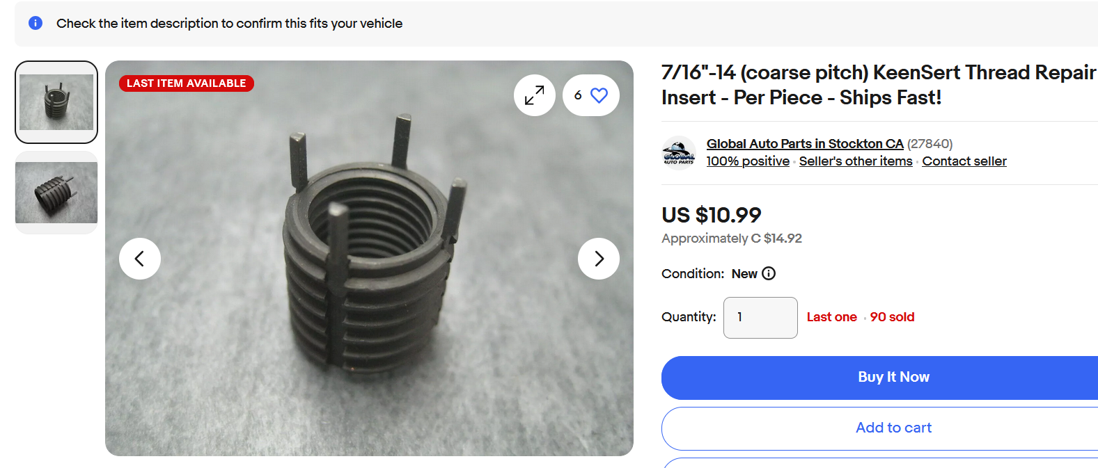

  18. Beanscoot
    Joined: May 14, 2008
    Posts: 3,697
    Beanscoot
    One brand is "Keen-serts", another is "Time-serts".
    I'd look into borrowing / renting a mag base drill to insure squareness of drilling / reaming etc.
    sdluck, Budget36 and Bandit Billy like this.

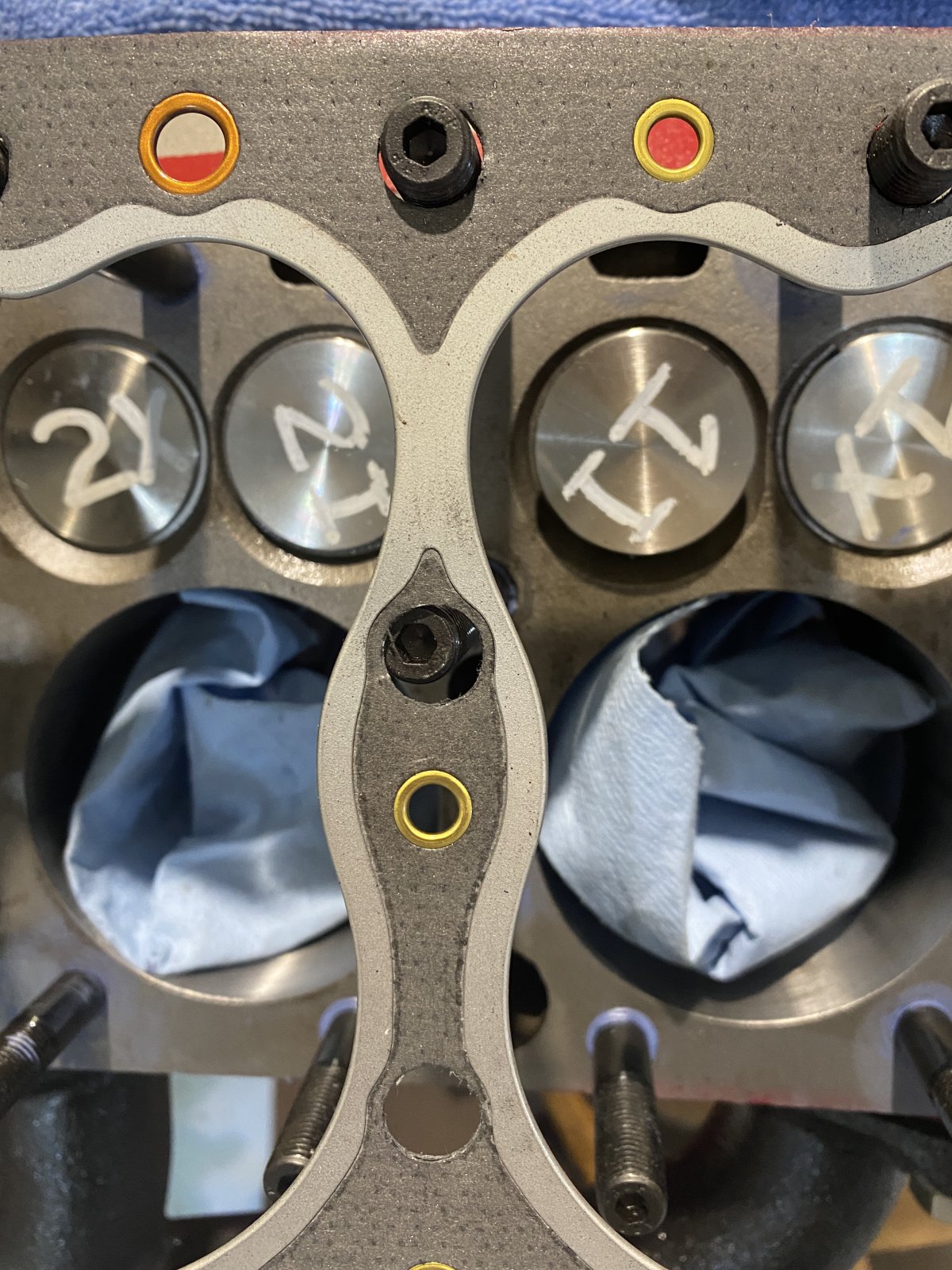

  22. Shoeboxdriver
    Joined: Dec 10, 2006
    Posts: 372
    Shoeboxdriver
    from Holmen, WI
    Bandit, Thank a million for your info, pic and wise advice. Getting together with a friend who has DCA Racefab here in town to plan our attack. Thanks to all else who contributed to this thread.

    This is the sort of insert I was referring to:
    It has a "standard" outer thread, but in this case that is 9/16 NC, not exactly a common size tap.
    I believe they are sometimes made with a fine thread outside, which I would prefer.
