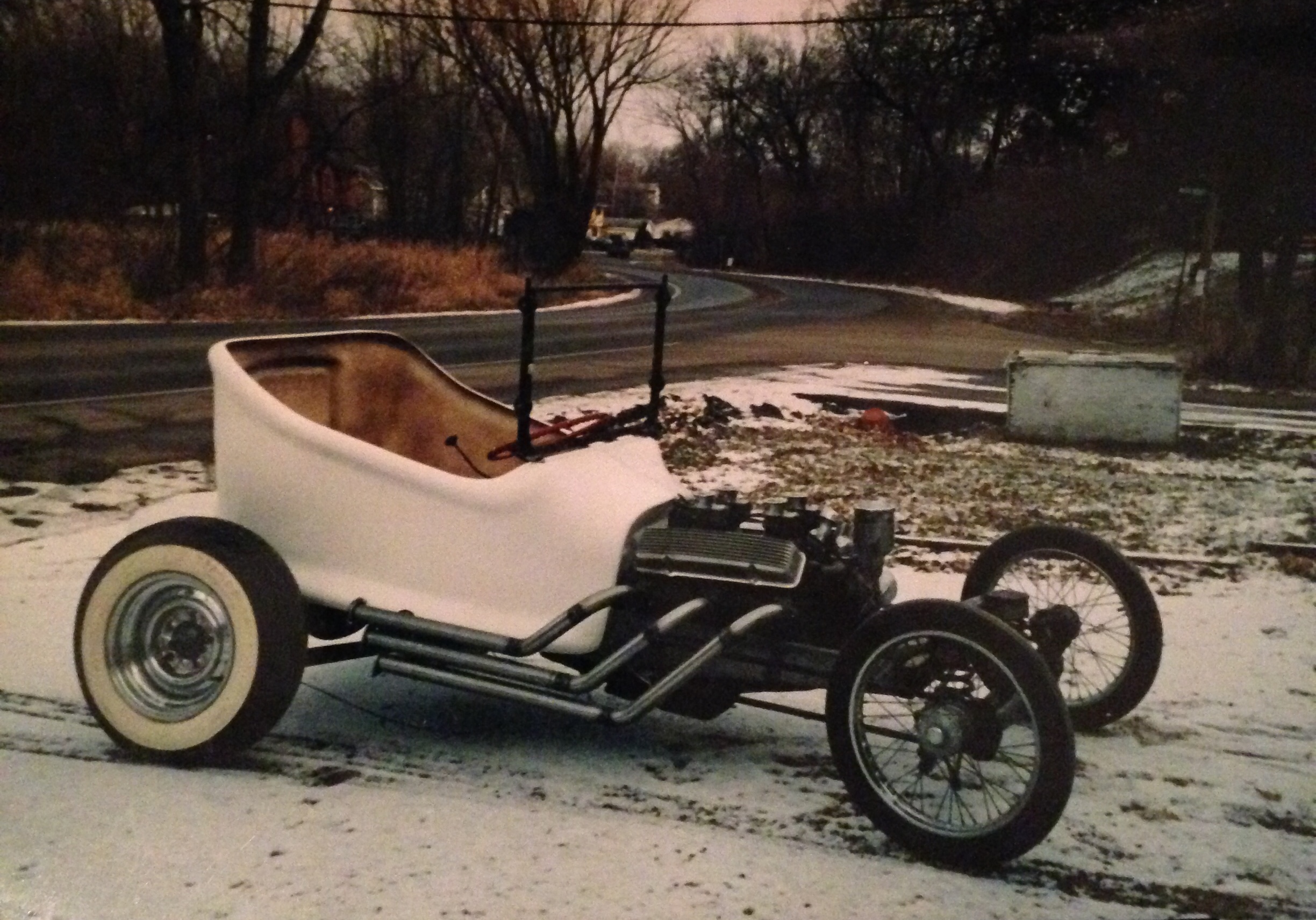

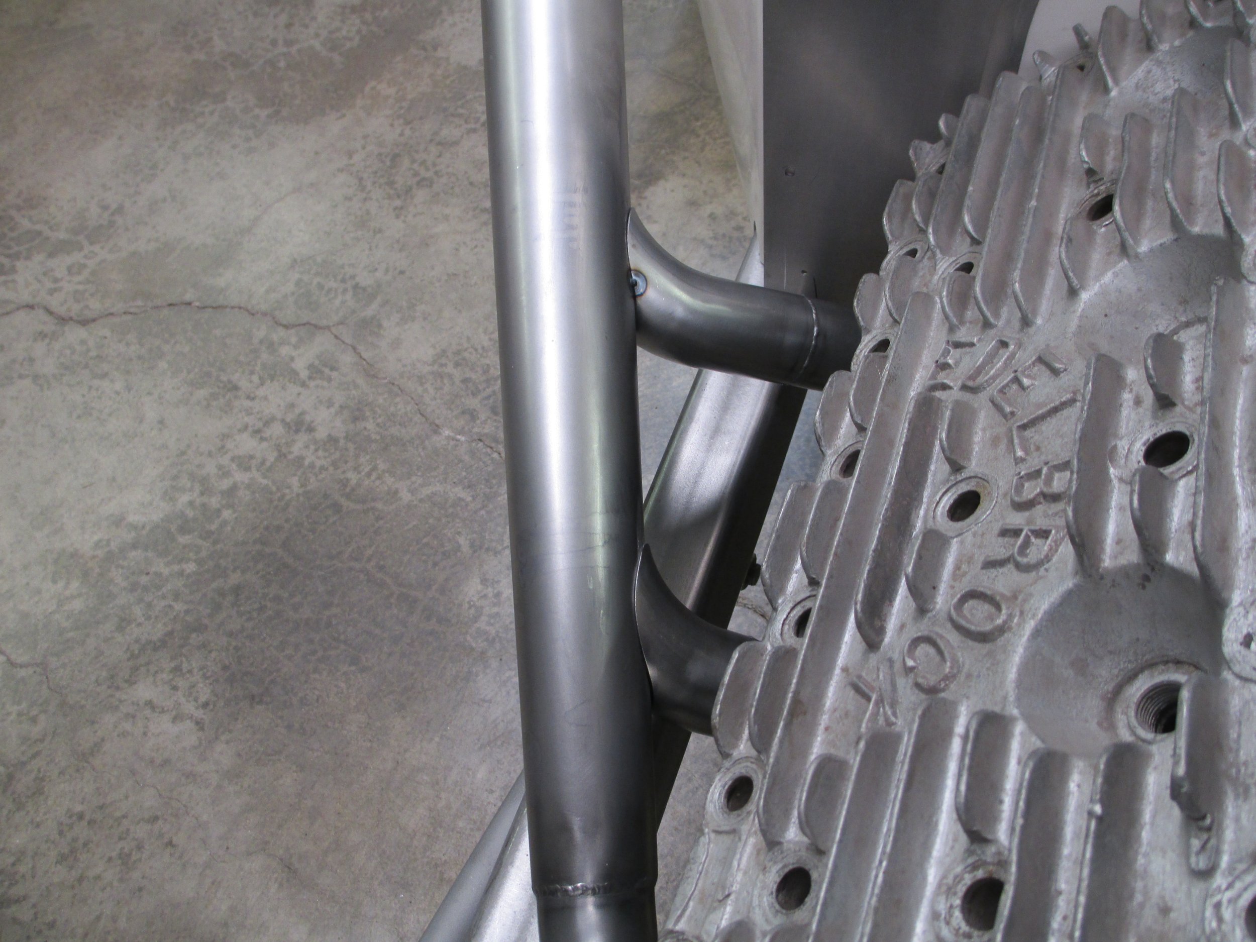

    I made these out of stuff I had laying around. Mig welded, sanding, filing, some more welding and sanding. They came out good and cost me almost nothing. WIN_20240517_17_37_17_Pro.jpg

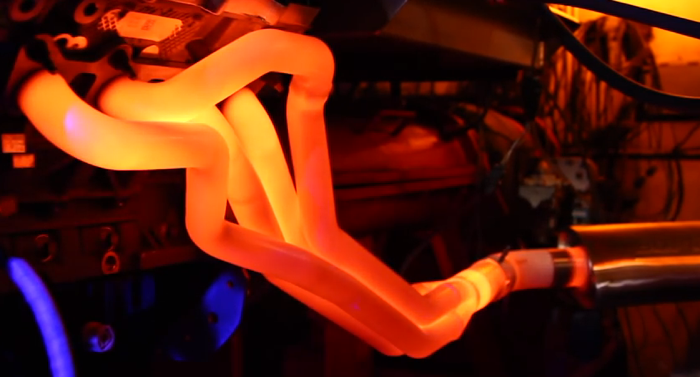

    If that pic if not a Thermal pic ,
    What RPMs & for how long,
    That looks to be Higher then average
    Rpms for long period of time,
    Glowing looks to be around
    950 - 1,100 degs .
    Thicker gauge tubing (wall-thickness)
    so you can have good penetration after grinding / sanding , or @ all welds use slip joint tubing , inner ring,
    So if your primary tub has a
    2.000 I.D. Your / use the inner ring thats has a 2.000 O.D , , will give more support & a thicker weld & penetration.
    May be look into making headers out of chromoloy.

    That's standard fare for engines on a dyno. Full load, full throttle. Once it has it's shoulder in it, the headers glow. Tubular and cast iron alike. I've seen iron so hot, you could see the wall thickness through it. I have a fibergl*** car. It runs into a wall of air and gearing at about 90mph. If you hold it foot to the floor for a minute at night, you can see the header glow through the translucent white floor. We used to turn the lights off in the shop to marvel at the cherry red glow coming off of engines on the dyno.
    As far as dressing up welds, make it big everywhere, sand and grind it down, hope for no pits and bubbles, weld the inevitable pits and bubbles, sand and grind some more. Porting kits have a selection of shapes that come in handy. Mike

    Takes a only few seconds for the header to get to that temp on full load (WOT). I have seen this on numerous occasions on a power run on a rolling road dyno, not continuous load.

    I am thinking now , I will needed to set up a GoPro on my headers to see if they
    Turn cherry /orange on one of my pulls,
    6 sec, 1/8 , I know driving steady rpms around 65 ish will start & to cherry @ 4 into one / collector
    Okie Pete, mad mikey and '29 Gizmo like this.

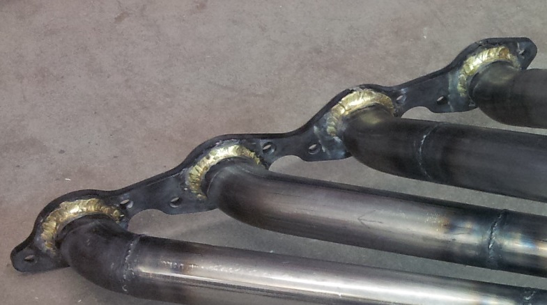

    558.JPG Yes, you can tig weld silicon bronze rod to fill imperfections in your lake pipes if you want to chrome them, the silicon bronze rod flows almost like solder at a high temperature. Some people use it to weld the headers but I think it would fail, best to weld tig weld the headers with normal filler and then touch up areas with the Silicon bronze, it is bronze in color if that matters.
    I did this set of pipes made from 35 ford driveshafts, full length, tig welded and finished with silicon bronze rod prepped for chrome plating (not done yet), not all imperfections can be removed but it is good enough for the plating shop to take it to the next level.

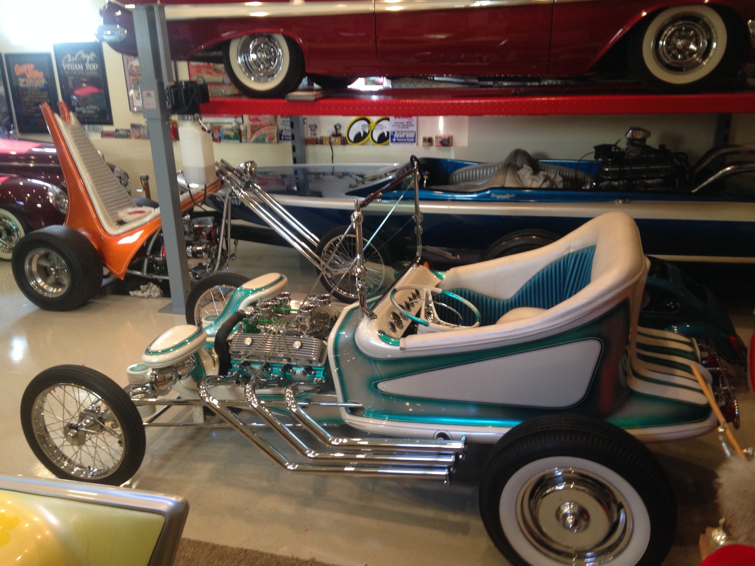

    I'm old school, gas weld header tubes. MIG weld the tubes to the flanges. With average quality welds, as stated above, some work with carbide bits, sanding disks you can blend the welds perfectly. I still did a bit of brazing filler on a couple joints. I too braze the tube/flange joint for heat transfer/strength, not necessarily for looks.
    On my Mysterion project I smoothed the header before chroming but on closer inspection I discovered Ed had his welds raw before chrome. I am pretty sure he had a third party construct the exhaust on the car.

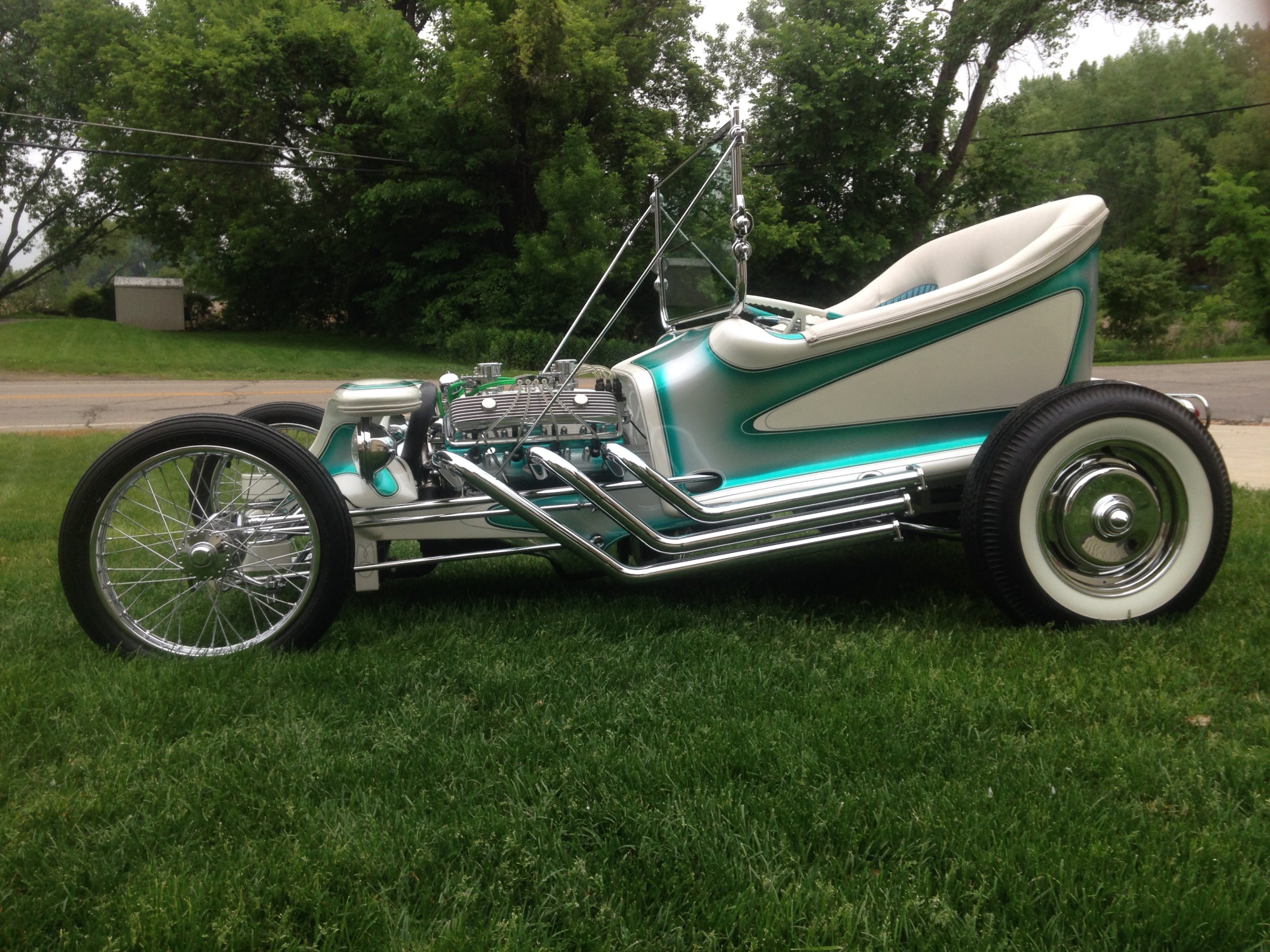

    I think he is referring to Lake Style headers and the sweeping joints. Only with Tig, could you run Silicone Bronze after welding and , smooth them out. At the flange, I always stop the pipe short of the inner flange surface by at least an 1/8", and seal weld inside, and follow up with Silicone Bronze on the outside. IMG_4829.JPG H28.JPG

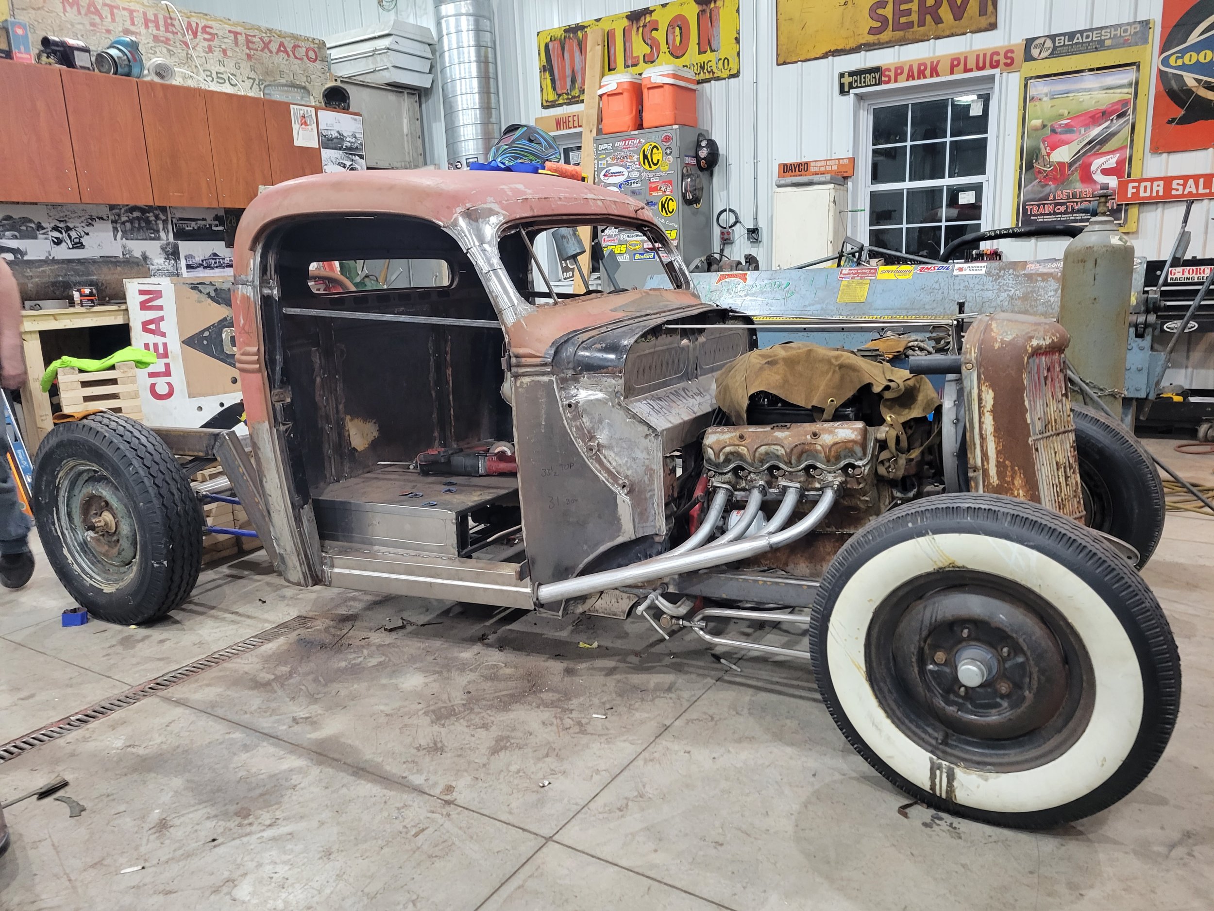

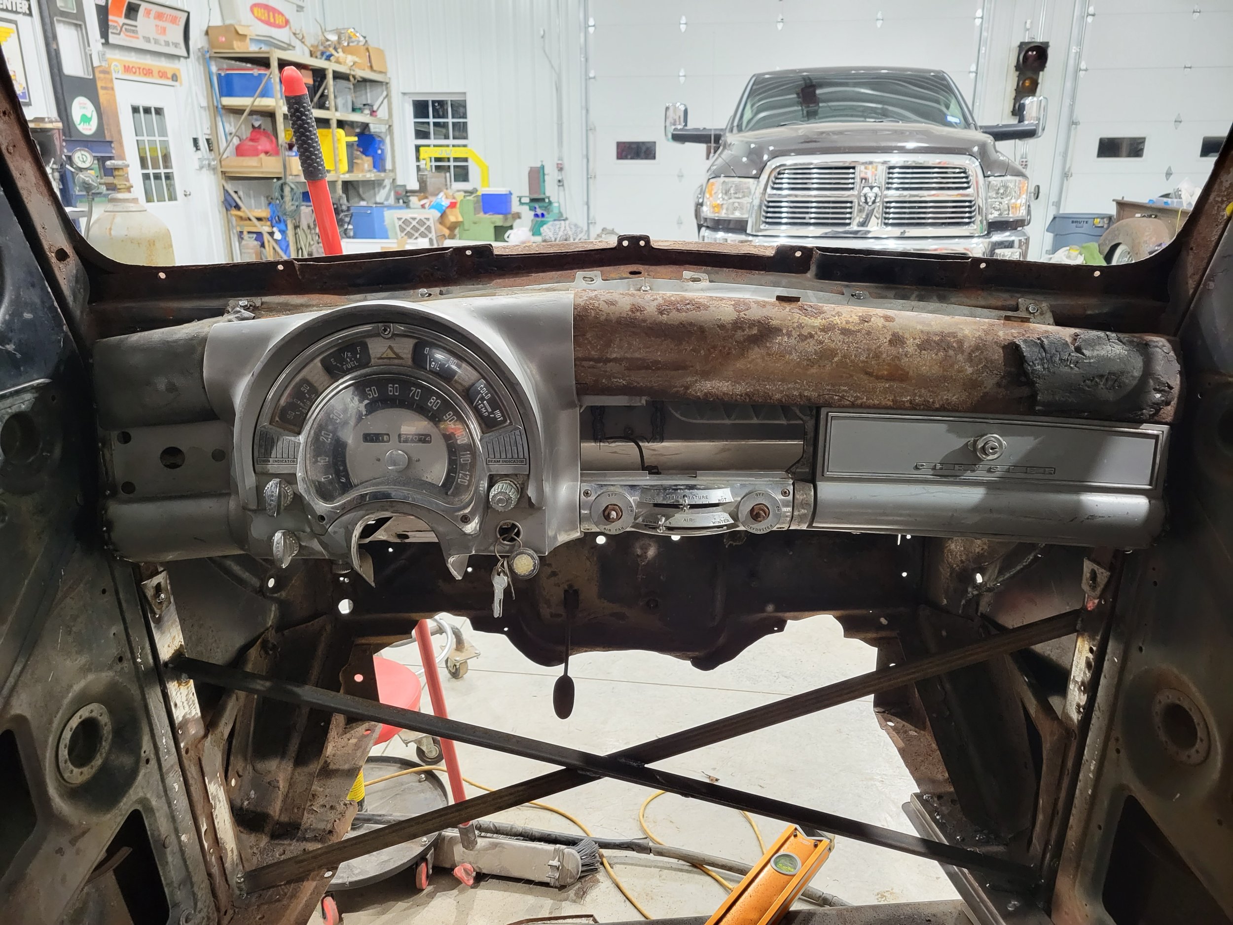

    Have you done this before. It's along the lines of what I'm thinking to do. Altho I've mig welded mine up. Here's what I'm working with

    more pics of this project please. or start a build thread.

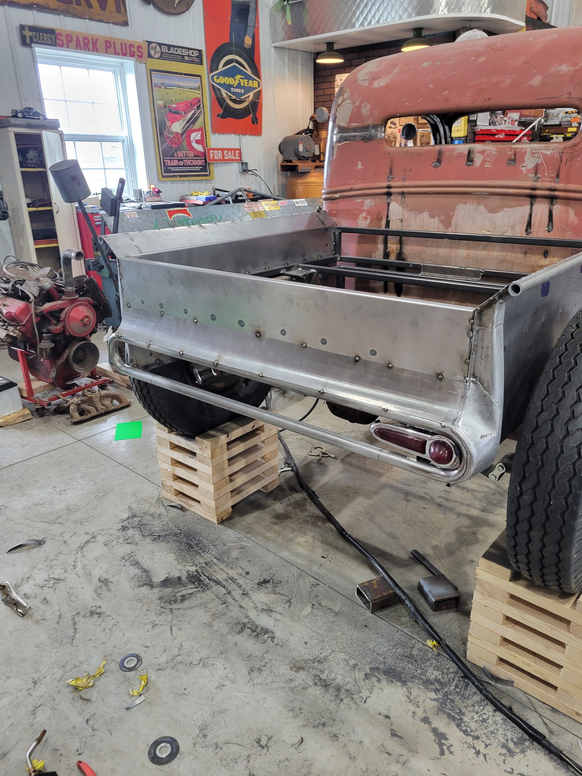

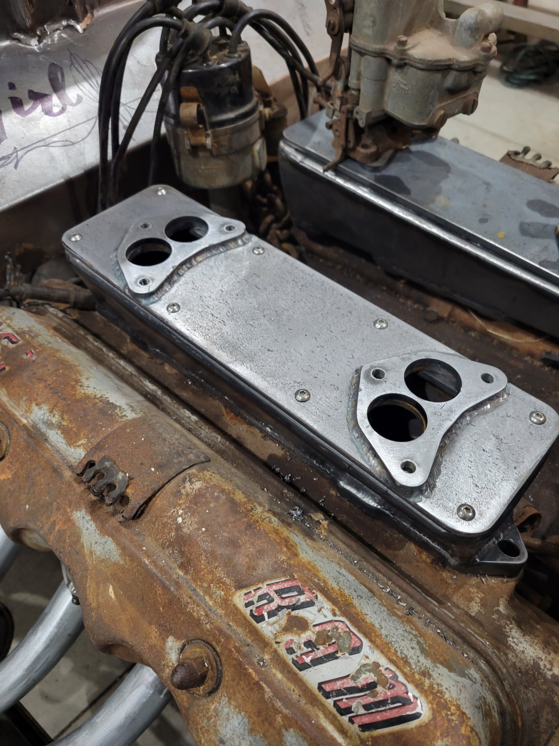

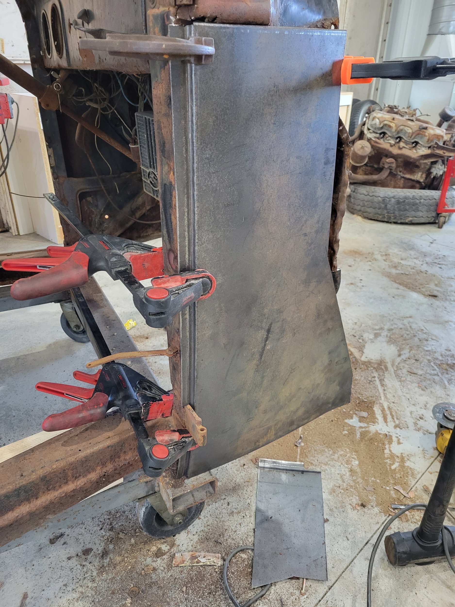

    here's pics of the build so far. Going for a little pages style hot rod

    These headers were fully TIG welded with steel rod, but then blended in preparation for chrome with silicon bronze
    20240519_184528.jpg 20240519_175922.jpg 20240519_175916.jpg 20240519_175643.jpg 20240519_175617.jpg
