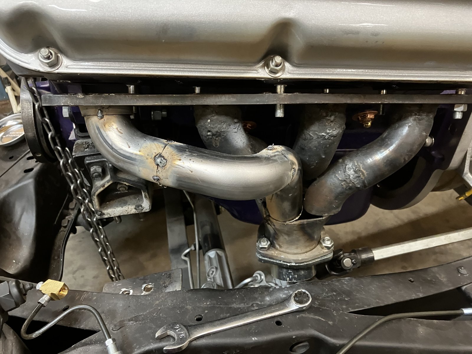

    I bought a set of block huggers for the 331 hemi I put in a '40 Plymouth. Had to cut and weld reroute a couple tubes on the driver's side. Both looked like the one on the left originally.
    If it is a minor interference, just dent the tube with a ballpeen hammer. Won't affect performance in the slightest.
    Done and JetHot coated
    P***enger side was fine
    Had to rebuild the driver's side

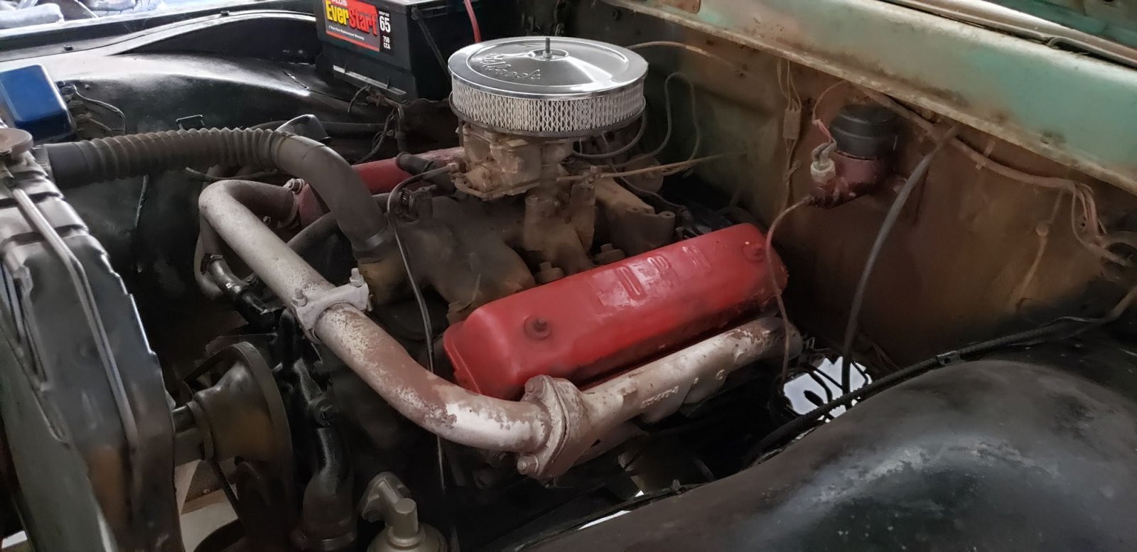

    You could always resort to the way the factory dealt with it on the Y block
