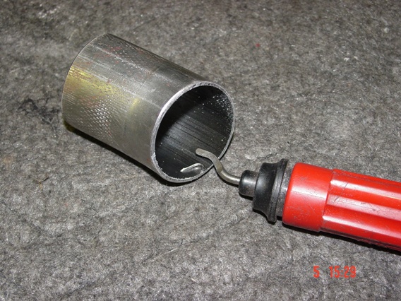

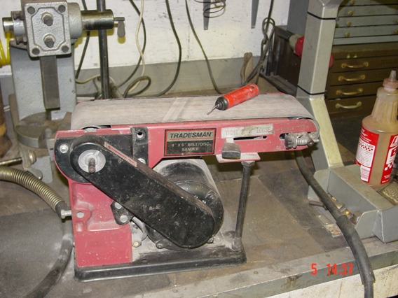

    Theres a few tools that are handy; a bandsaw, beltsander, offset grinder with flapper disc and deburring tool. When you cut the tubing it will be full of trash, i roll the outside edge across the beltsander and do the inside edge with the deburring tool. The pics show typical cut and how clean the tube needs to be. Any trash left in the tube can go straight to the engine during a reversion pulse, so the tubes have to be spotless.

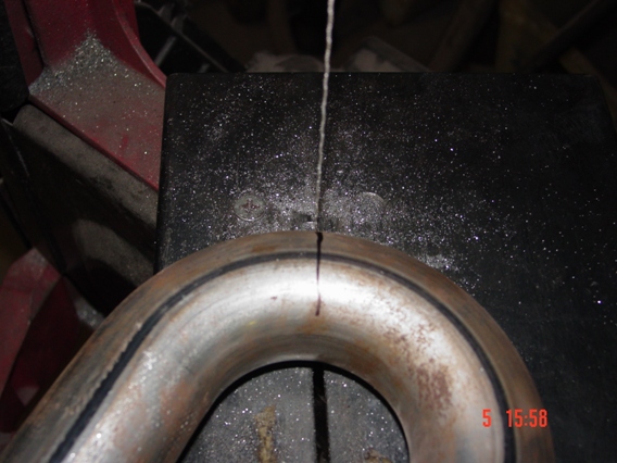

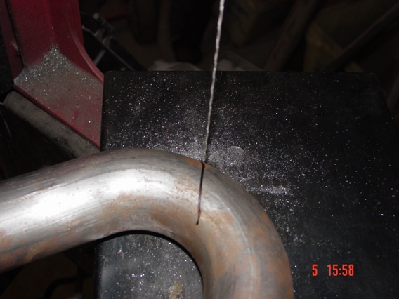

    You need a good selection of tubing, i get different radius' as well for on good set of headers there'll be tubes inside of others and to do that you need different radius'. A nice thick flange with holes slightly larger than the od of the tube so you can stick the tube well into the flange and that helps hold it in place.

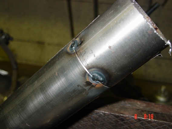

    Pick a tube to start with - picking the right tube can be a painful process but the hardest part is getting started. When you mark to cut the tube the cut must be square, the shortest possible distance across the tube. See pics 2 & 3, pic 2 with the exaggerated out of square cut will give you a tube mouth that is shaped like a lemon, you don't want that as welding lemons is a pita so makes all your cuts like pic 3. I cut and then true the cut on the beltsander, when cleaning the cut do not remove much material from the edge or it will be beveled and you'll habe a hard time welding because it is so thin.

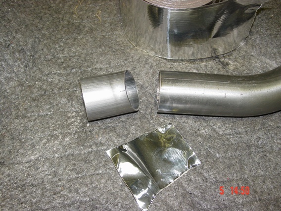

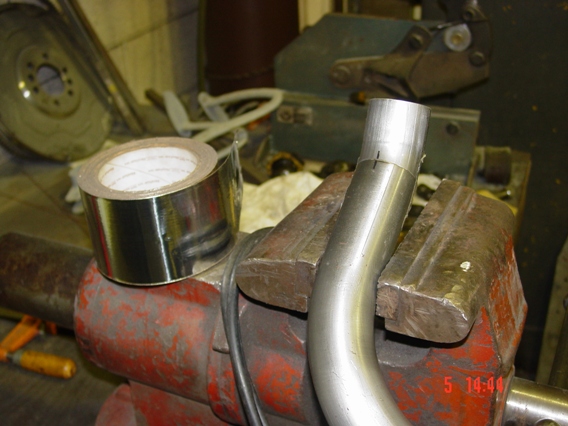

    When i get good alignment i make a witness mark on the tubes and go to the bench. I use aluminum foil tape to join the tubes and align the witness mark, then tack. While the joint is still warm i pull the tape off - i use carb cleaner to wash the adhesive off the tubes as it will leave a stain on the pipes when you finish weld - BE CERTAIN YOU LET THAT CARB CLEANER DRY/EVAPORATE BEFOR WELDING it'll give off lethal type g***es if you weld too soon.

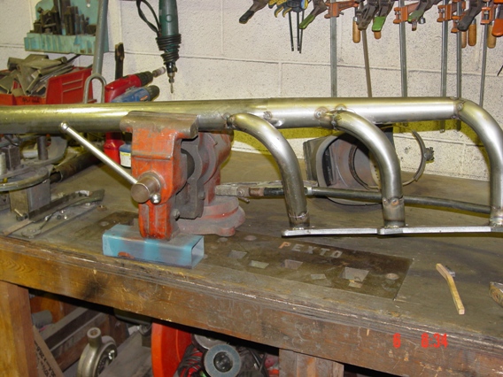

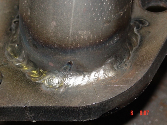

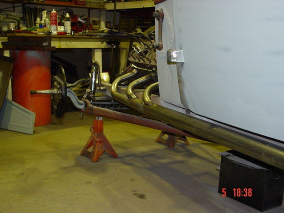

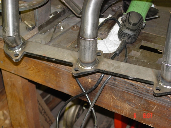

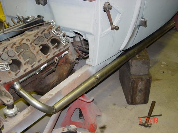

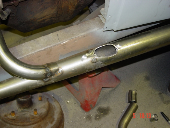

    The next pic is the tube we tacked on the bech is now tacked to the flange - 2 tacks at the flange, 12 and 3 o'clock will keep it from moving - and joined to the side pipe.

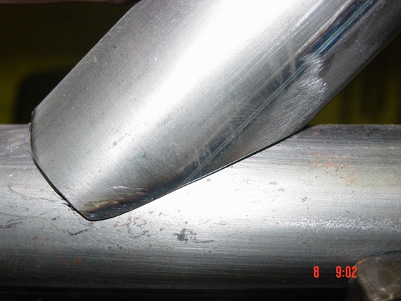

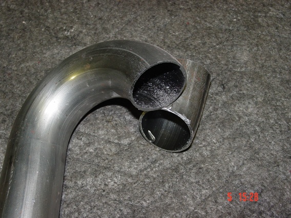

    Pic 3 shows the hole in the sidepipe for the 3rd header tube, tack that tube in place and it is ready for welding.
    Start the welds at the flange, when the tubes are welded to the flange then go to the other end and weld the collector, or in this case the sidepipe. With the 2 ends nailed down you can then weld the individual tubes without them moving.
    I have a vise that i just move around to wherever on the bench, it moved a lot making these pipes. I've been doing it for decades and i have never dropped it off the bench - i have a bigger vise that is bolted if i need it.
    Weld the seams and joints up and grind to taste - this set is not going on a ridler contender so i just hit the 'high' spots.

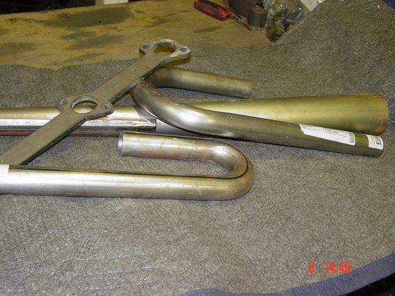

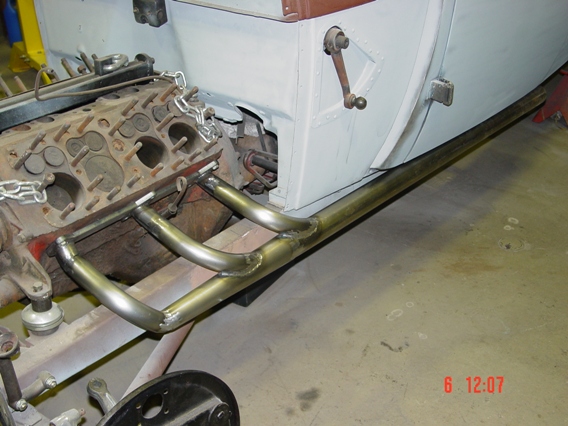

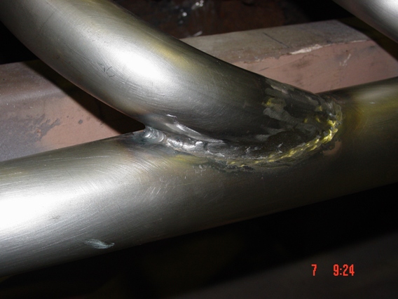

    Finshing pictures.
    When making mutiple curves you cut the section of curve you need, don't try to angle cut the tube. I hold the two pieces of curved tubes in my hand and rotate them around until i get the alignment, give them a witness mark, tape them up and tack weld joining them to the fixed pieces. You really don't want to have more than 2 pieces taped.
    When you make the cuts and alignment the 2 pieces have to fit very tight, you have a welder not a calking gun to fill the gap. Tubing is cheap.

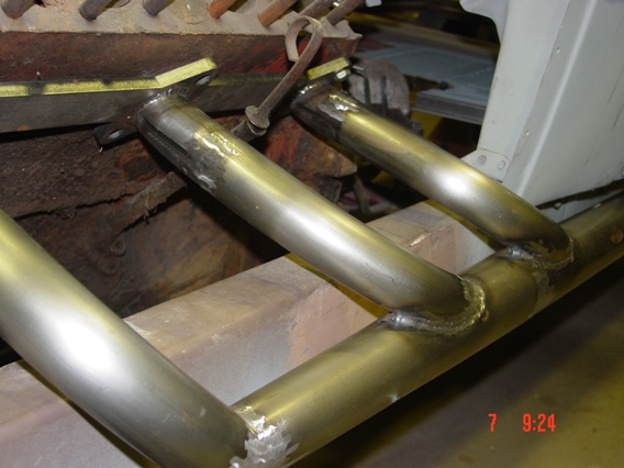

    Something i didn't show is finishing inside the flange, when the ouside is welded i ballpeen the tube ends inside of the flange opening, i ballpeen them back tight against the flange and run around them with a weld.
    Making headers is slow work and tedious, a good set will take a few days. The pipes in this example were quick and easy, they were tacked up in 4 or 5 hours and welded complete in another couple hours.
    Hope you find this useful, thanks oj

    tig welding usually is prefered, more penetration and less heat, but over time they all crack at some point. The heating, cooling cycle, vibration and stress from the engine and exhaust system all play a factor as does the fitt up and welder. Most all steels header tubing is 18 guage.

    I have the belt sander with a disc on one side and the angle grinder. Need a deburring tool...thanks for that advice.

    I tig weld, you can mig weld and mimick the tig doing a 'penny-s***ch'. I use 16ga metal but that 'trumpet' section was 18ga and a little thin.

    As far as cracking etc, that has more to do with how the finished header/exhaust system is supported than how the tubes are welded. If the motor has 'soft' mounts and the exhaust is more rigid than the motor then you'll have cracks.

    Heres' a couple more pics, they show how well the tubes came out with just a minimal touch with a flapper disc. This is a customers' car and cost is a gorilla in a small room here - these could have been stainless with flawless finish but they are not. What these are is what you guys can make and this is how they'll look.

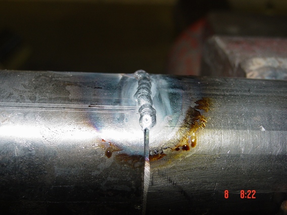

    To do the tight inside i have high heat anyway, the argon is 6lbs, and i'll extend the toungsten a little. I use the m*** of the metal to control the heat, the lower tube is thicker (the upper tube has been gound to fit and the inside edges are thinner) so i get the lower tube hot enough to 'park' a blob of metal and then 'pull' it around with the heat and i also make short arcs with the tip to move metal from the low tube to the upper tube.

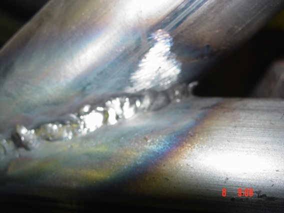

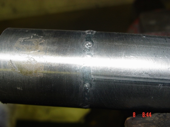

    These pics might help explain:
    the first example is a square cut **** joint, the tubes are cut square, cleaned and tightly fitted - you don't want any air gaps. The first 2 pics show the prepped tube, ready to be taped together; 2nd pic is the tubes tacked.
    The 3rd pic is the weld seam on the joint, i have left it high.
    The 4th pic is where i have made a 2nd p*** over that seam and the seam is about gone, i hate grinding.
    The 5th pic is where i finished welding the tube by fuzing them together, no or very little filler is used. The stain to the left of the weld is from the tape, i didn't clean the adhesive off the metal from the tape so that you can see what happens.

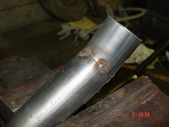

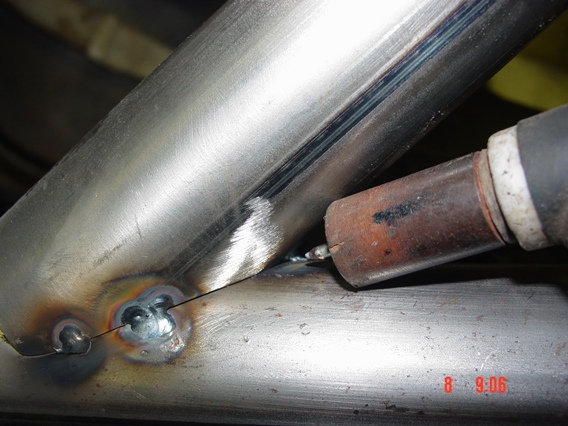

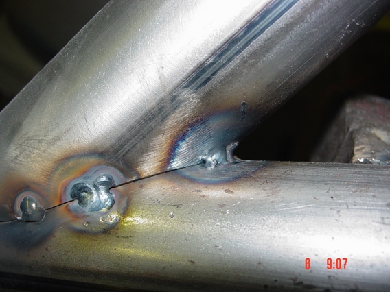

    This set shows the welding inside an angle, i didn;t make a severe angle because it would be hard to show the technique. For those of you doing a roll cage this is done a million times for the diagonals.
    The first pic shows the angle of the tube in a vise so you can work it with an offset grinder, fishmouthing can be the subject of another thread and there is a lot of technique involved. The 2nd pic is the trial fit - it has to be tight.
    The 3rd pic i have it tacked and the typical length of the toungsten is shown.
    The 4th pic i have made the electrode a little longer (if the angle were more severe i would make it longer yet, you can go out quite a ways, 3/4" or so. I have tried different lenses etc and they just block your vision). If you look past the electrode you can see that i have 'parked' some metal from the other side, while the metal is nice and hot i begin at the metal and 'pull' it around.
    The 5th pic is where i have pulled it around. And completed the weld in the 6th pic.
    I want to point out that my heat is much higher than you'd think, around 125amps and i work very quickly. I used to do it at about 50-60amps and try to be more fussy with the weld appearance. Since i have only one eye working i have given up on 'pretty' welding as my electrode is in the puddle about half the time and now i focus on doing the weld with the least amout of effort and work.

    I love that red handled deburring tool... I have 3 of those... :D
