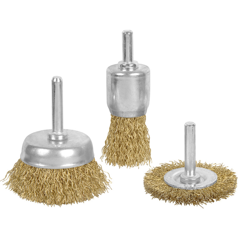

  7. '29 Gizmo
    Joined: Nov 6, 2022
    Posts: 1,199
    '29 Gizmo
    from UK
    Use these..
    Duellym likes this.
  8. squirrel
    Joined: Sep 23, 2004
    Posts: 60,087
    squirrel
    curious how you'll get that between the tubes....
  9. '29 Gizmo
    Joined: Nov 6, 2022
    Posts: 1,199
    '29 Gizmo
    from UK
    Different brushes. In a power drill
    Duellym likes this.
  10. squirrel
    Posts: 60,087
    squirrel
    ok, I'd like to see it work....
    (yes, I've sandblasted headers, and yes, I've used wire brushes in a drill, and I can't imagine the latter taking the place of the former)
