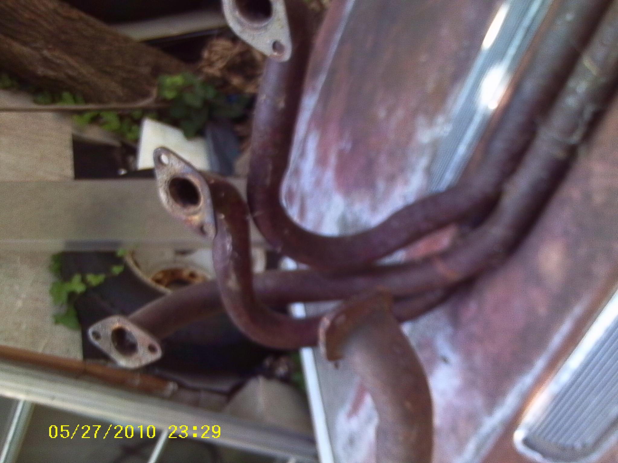

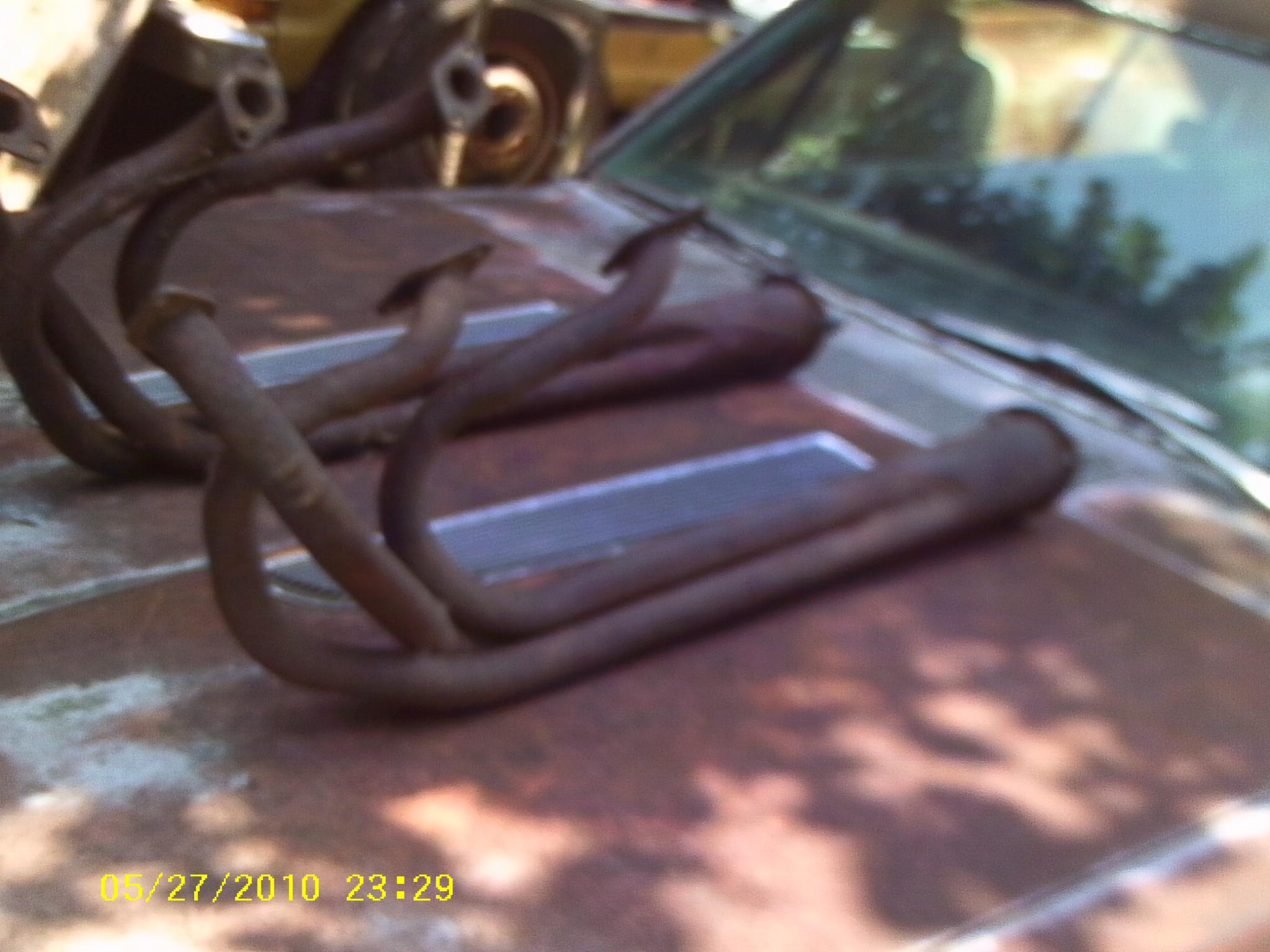

    not sure who fab'd these under car tubes....got them back in the 80's from an old guy....hoping Jeff will fab up a new set...we need to find out if they will clear a stock wish bone or what....

    stillrunners,
    If those headers would fit on my stock '47 Ford Tudor I would love to buy a set if somebody would fab some up.

    Those are some cool looking headers.

    that would be Jeff in Dallas....
