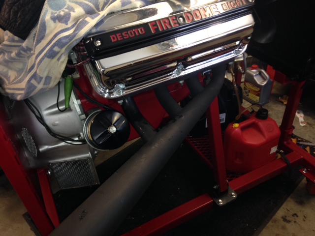

    Just used the 2" x 50' Premium header wrap from Jegs to wrap my 56 Desoto hemi headers. I have the SS cable ties but am wondering if anyone has a few pics of how they tied their headers...

    for now the engine is just on a stand and I have yet to decide where it is going to go. I sure do like the look though. If someone can post a few pictures of the wrap wire tied that would be most helpful. I already snipped a few of those shi..y SS cable ties off. They are a ***** to get tight enough..

    I just want to see more pictures of that engine!
