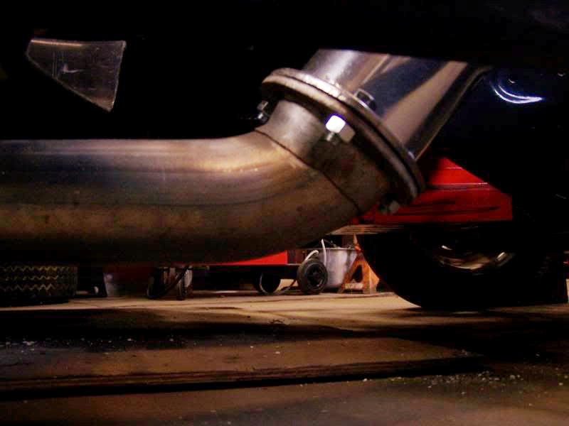

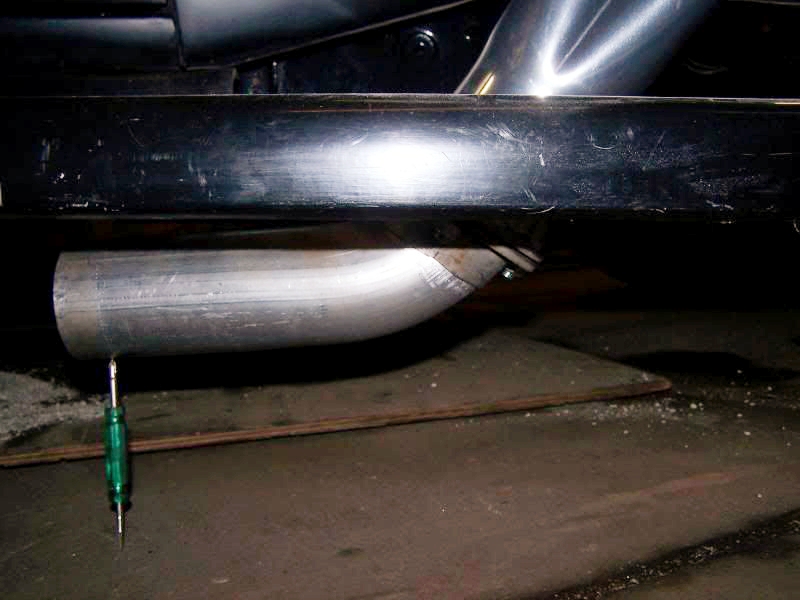

    Nice. Do you know the brand of the headers? Meanwhile, here are a few pics of my current setup. They are Hedman headers. Think they are mid length. 1-3/4 tubes 3” collectors. I’d like to keep them if there’s a way to transition from the reducer to the exhaust pipe without such a drop. Thanks all.
    Kent[​IMG][​IMG][​IMG][​IMG]
  10. squirrel
    Joined: Sep 23, 2004
    Posts: 61,018
    squirrel
    just get a mandrel U bend, cut it off at the right place, weld it to a flange. The setup you have is typical exhaust shop work, not hot rod fabricator work, so of course it's ugly and doesn't fit right.

    @rc57: Excellent pic with the tape depicting frame height from ground, also exhaust height.*

    Posts: 216
    bogart62
    I agree it's ugly. Bought it that way. Mandrel bend may be the ticket. Looking to drop the front end a bit and don't want to have any issues with it getting lower. Thanks.

    I agree with getting a mandrel bent U-bend and a couple of header collector reducers.
    Then you just sneak up on the fit, t******* them to where you like it, here's the ones I did on my 41 pickup.
