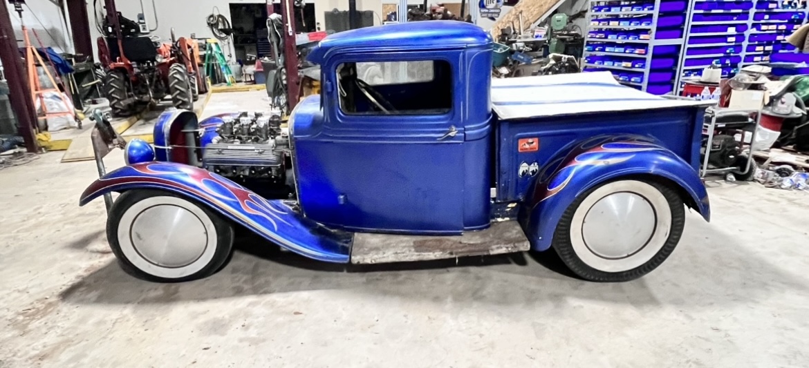

    Check out my other threads regarding this truck. I still haven’t been able to find any pictures of this pickup when it was running so the question of the day is under cab headers, lake pipes or cowl exit collector headers? What do you think he ran? What would be period for the late 50’s running a 324 olds?
    Need to order materials asap so I can start the motor but can’t decide what to build.
    it was a drag truck that I’ll be putting back on the street to drive.

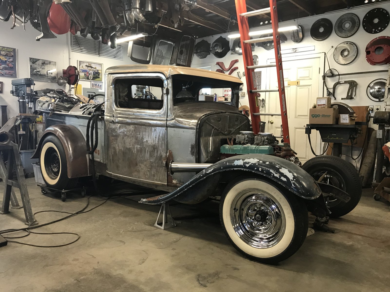

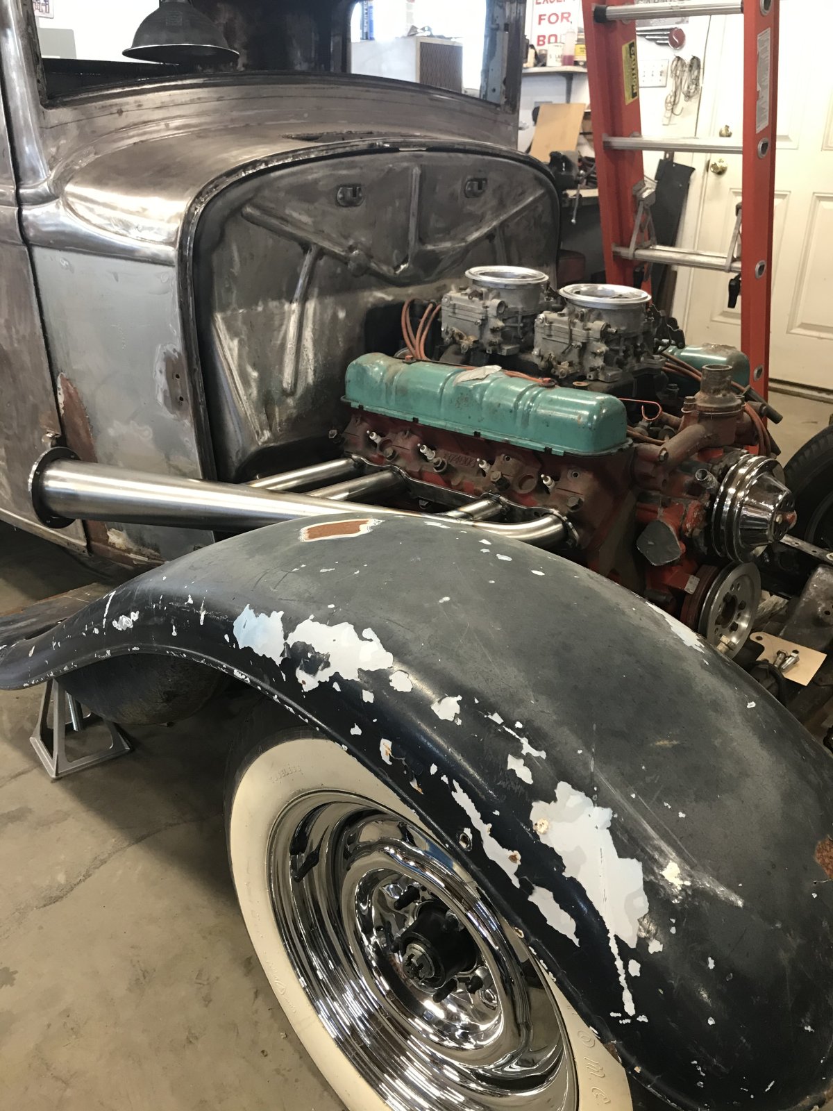

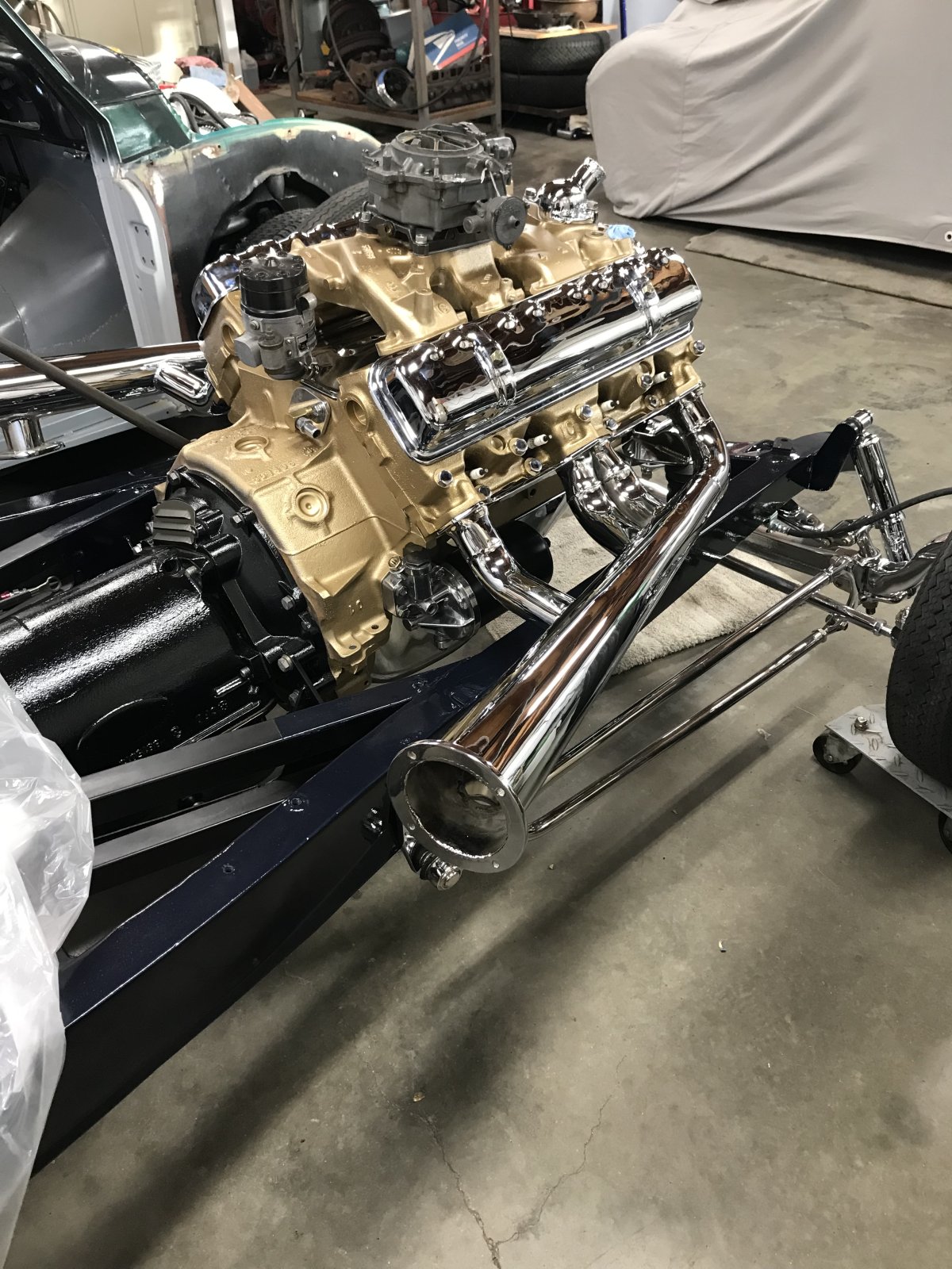

    Here’s what the “Lakes” style will look like. My truck is very similar to yours but nailhead powered (for now).
    It’s all parts from Speedway.

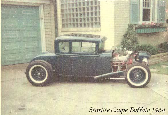

  5. swade41
    Joined: Apr 6, 2004
    Posts: 14,564
    swade41
    from Buffalo,NY

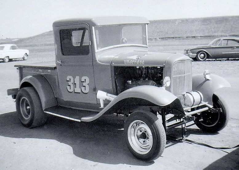

    I agree with your first paragraph. A Belond style tubing manifold would fit the 50s style well. But I take exception to the second paragraph that Lakes headers are 1998. They did see a resurgence in the 80s and 90s due to the availability of kits but they were a 60s style that was popular with those who could afford them. Some didn’t have access to the rolled cones and opted for a different style, like the 313 pickup in Swade41’s post.
    An excerpt from HRM 1963. A local muffler shop building a traditional style Lakes header on an Olds powered ‘29.
    And my ‘29, built in the 1963 style.
