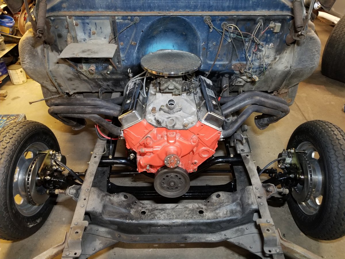

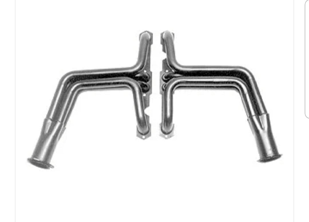

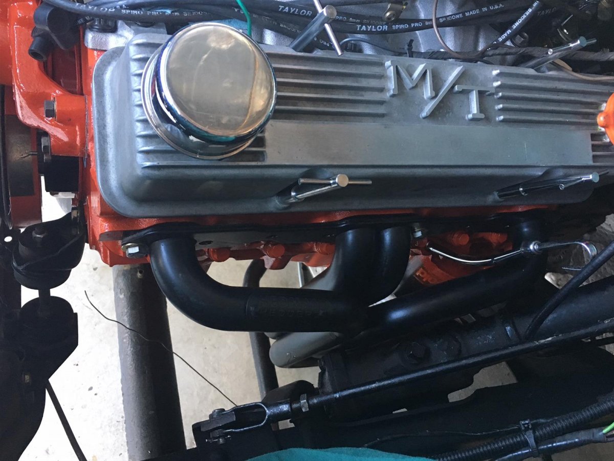

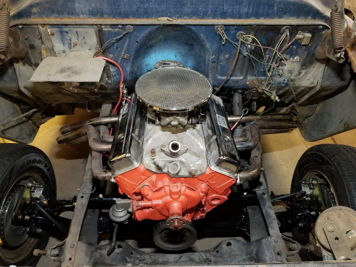

    The square body headers that Squirrel posted are the go to headers for these truck, the steering box tends to get in the way, the 2.5 rams horns do clear the steering box.
    I just tried out a couple different fenderwell headers and rams horns on my 57 to see what was going to fit. I had a photo of those square body headers on one but I may have deleted it, that would be the header I would choose, why not pick up the extra torque, hp and gas mileage when you can get it.
    Square body headers
    -Hedman-Hedders-69260-201851010304715.jpg Screenshot_20201117-203419_Chrome.jpg
    41 GMC K-18, 1Nimrod, Blues4U and 3 others like this.

    Per chance, have you got a part number for the headers in the last picture? With a slight modification, they would be just right for the whatever project. Thanks
