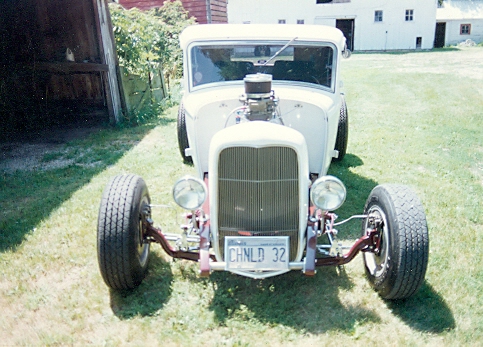

    The headlights on my coupe are mounted on a cut, heated and bent Model A bar, they happen to be 28 1/4" apart, but it wasn't really planned that way they just ended up there. scan0016.jpg
