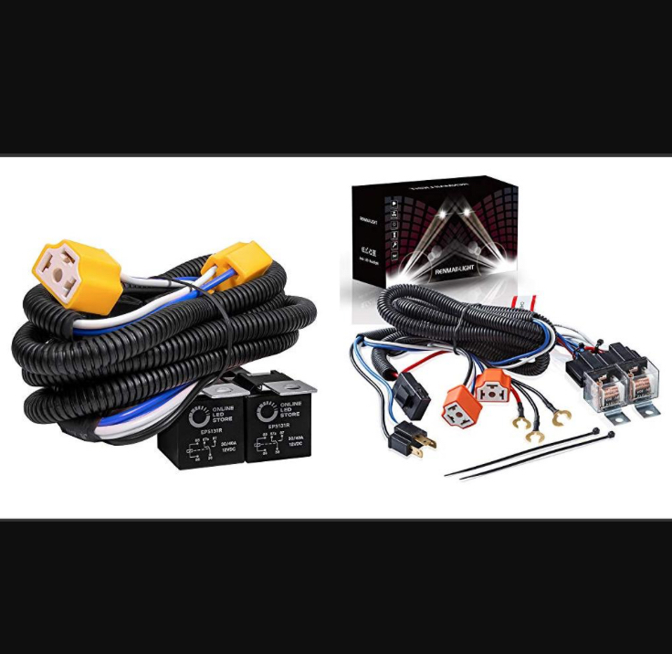

    So I got into a not heated but kind of warm conversation about using headlight relays.
    I have all brand new wiring and headlight switch and dimmer switch. Nothing gets hot and everything works fine with my headlights (stock replacements) for my 69 Dodge. They light up the road fine at night and never dim.
    I don't feel the need to cut a brand new harness to add relays due to "fear", which in my opinion are a band aid for a bad electrical system. If I had high wattage lights well maybe it could be a good idea but reminds me of when Angelina Jolie wanted to have her ****s removed due to "fear" of breast cancer lol
    What do you guys think??? Thanks, Mike.
