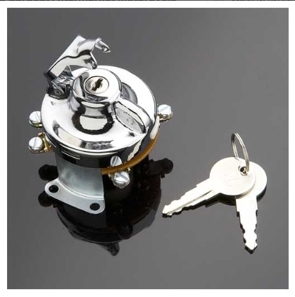

    I use an old style key-type Harley Davidson ignition switch. The switch has multi positions for a combination of uses including ignition, lights, wipers. Replicas are available.
