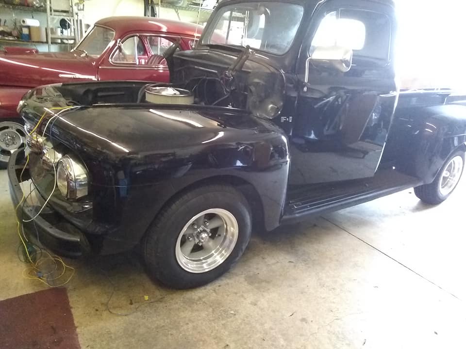

    Ok, I have a 49/51 F1. I rewired the whole truck. I just put the front end back on and working on headlight wiring. It's a simple setup. No relays, just direct from switch.
    I wired up the left headlight socket plug first.
    With the test light, I test the socket plug. Everything checks out fine. Turn on low beams, the low side has power. The high side does not.
    Hit the high beam switch and the high side has 12 volts, the high beam indicator light lights up and the low beam side has no power. I think....ok, everything seems fine.
    As soon as I plug in the head light and pull the switch on, both sides are getting power and the high beam indicator stays lit in both positions.
    What am I getting wrong? It's a new headlight btw.
