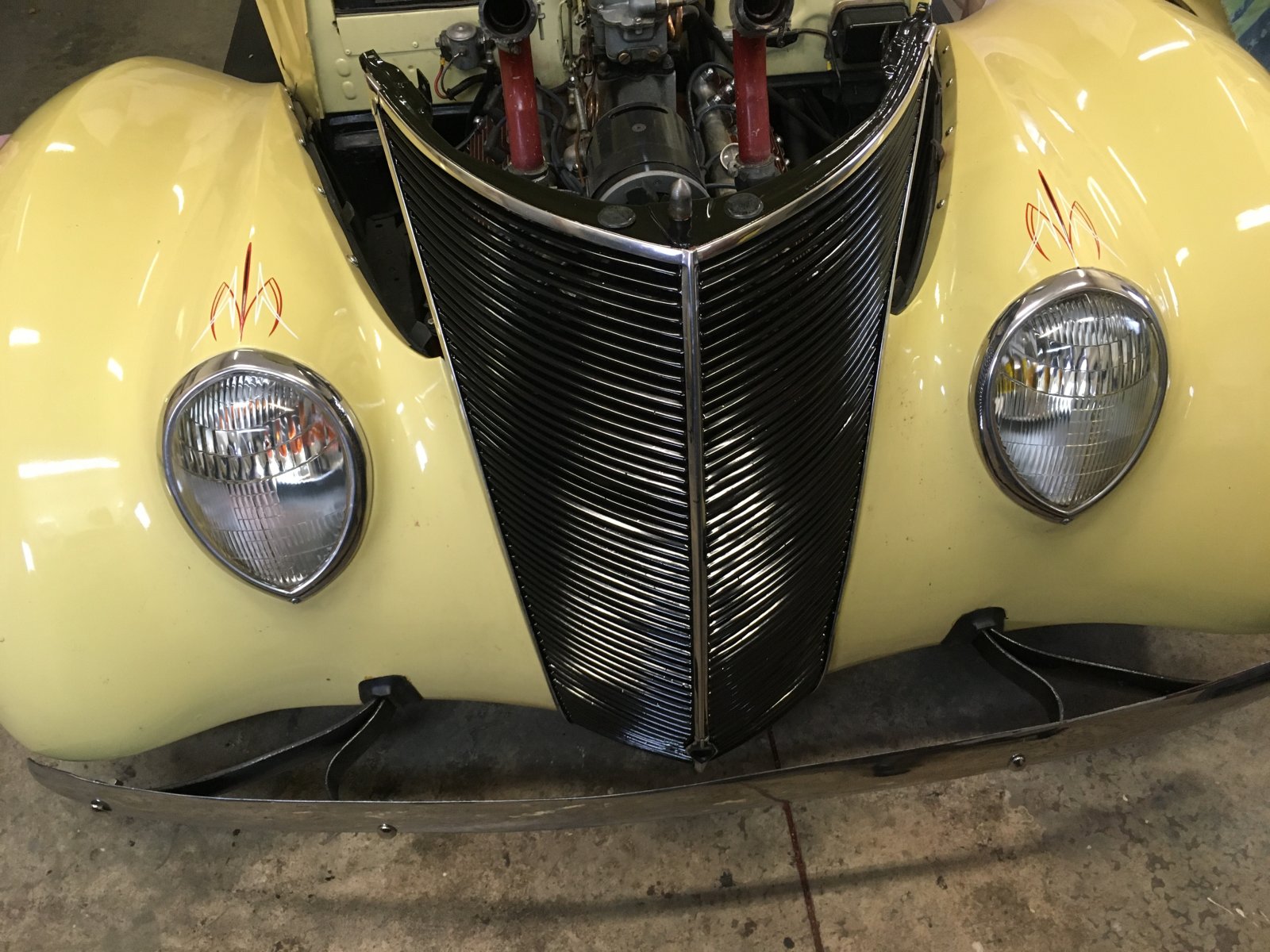

    Add me to the while functional I am just not a fan of the look club. It's usually not all that hard to change the socket in the park light to a double element socket. Then your turn lights look proper.
    The other option to me depending on the build theme of the car is a pair of lights on the bumper that look like fog lights but are turn signals.
    This turn signal is on the fender of the 51 1-1/2 ton I have.
    I keep thinking that they would look pretty nice all done up right and sitting on the splash apron where a pair of fog lights would normally go.

    Petejoe
    from Zoar, Ohio
    My similar 37 lights have a socket for turn signal bulbs that double as parking lights.
    These sockets are positioned below the headlight sockets about 1-2” from the edge of the reflector.
    Work well and are visible at night.
    Still look original too

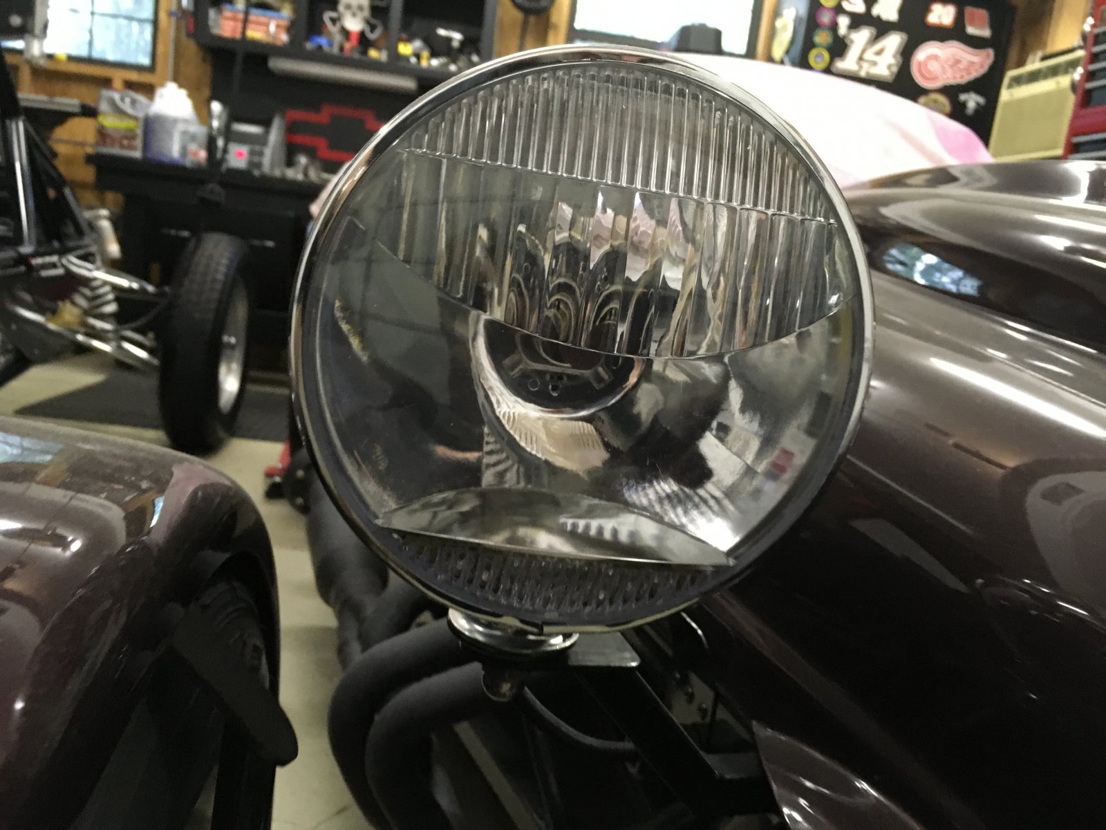

    I have these on a car I built. There are amber LED’s in the bottom of the halogen headlights and a little more discreet then the lense being amber. I like them because it’s a cleaner look without having to find a place to hang an extra turn signal light. Don’t remember where I bought them but pretty easy to find. Maybe not for everyone your mileage may vary. 563C24DD-C160-44F3-94D6-5A3F9090480F.jpeg
