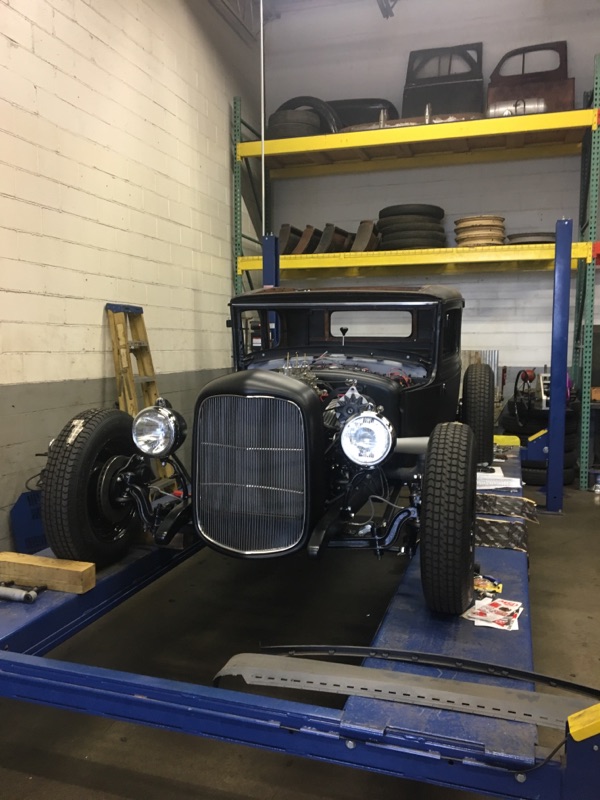

    Going to go with a 3-1/2" haircut (chop) not going to rework the floor, should have 1-1/2" to 2" of headroom, if it's too tight I can build the seat on the floor, like a split bench style. Thanks guys for your input and help!

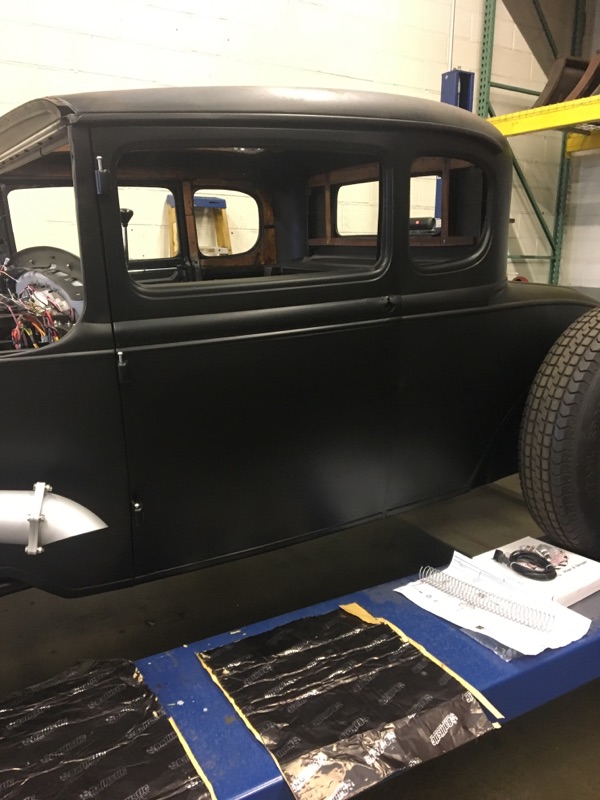

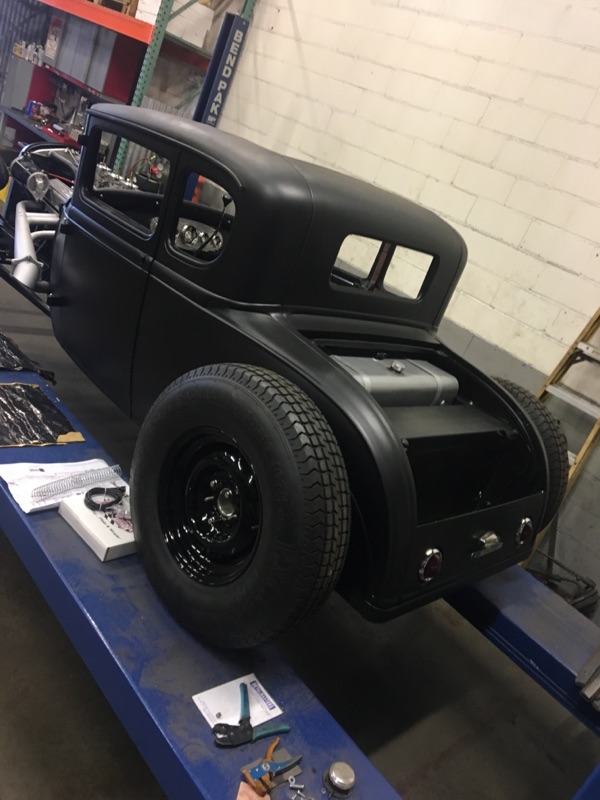

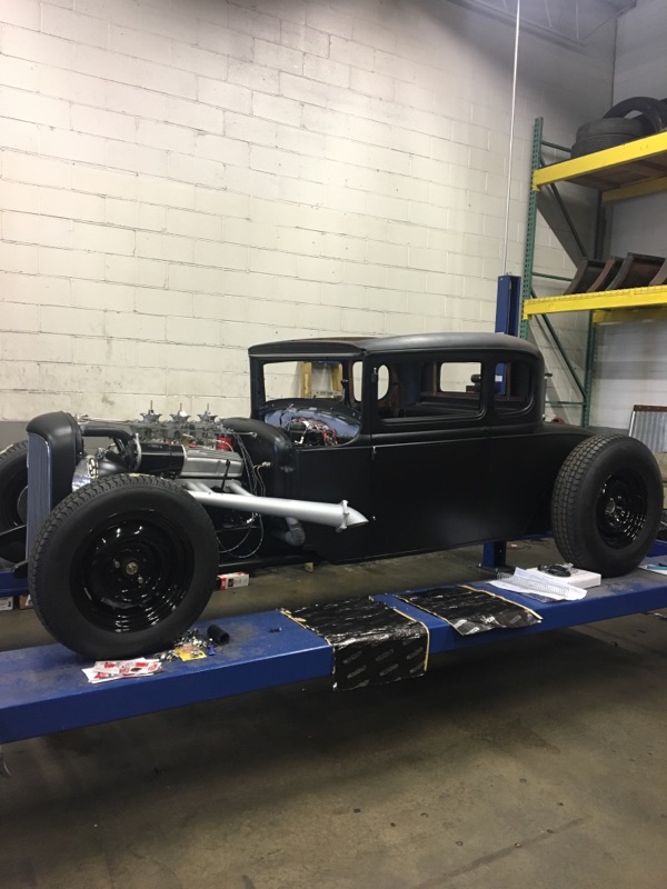

    It's been a while but I chickened ou,t and went with a 3" chop. Car is getting close, runs, has brakes and is wired, needs gl*** and a few small others to complete.
