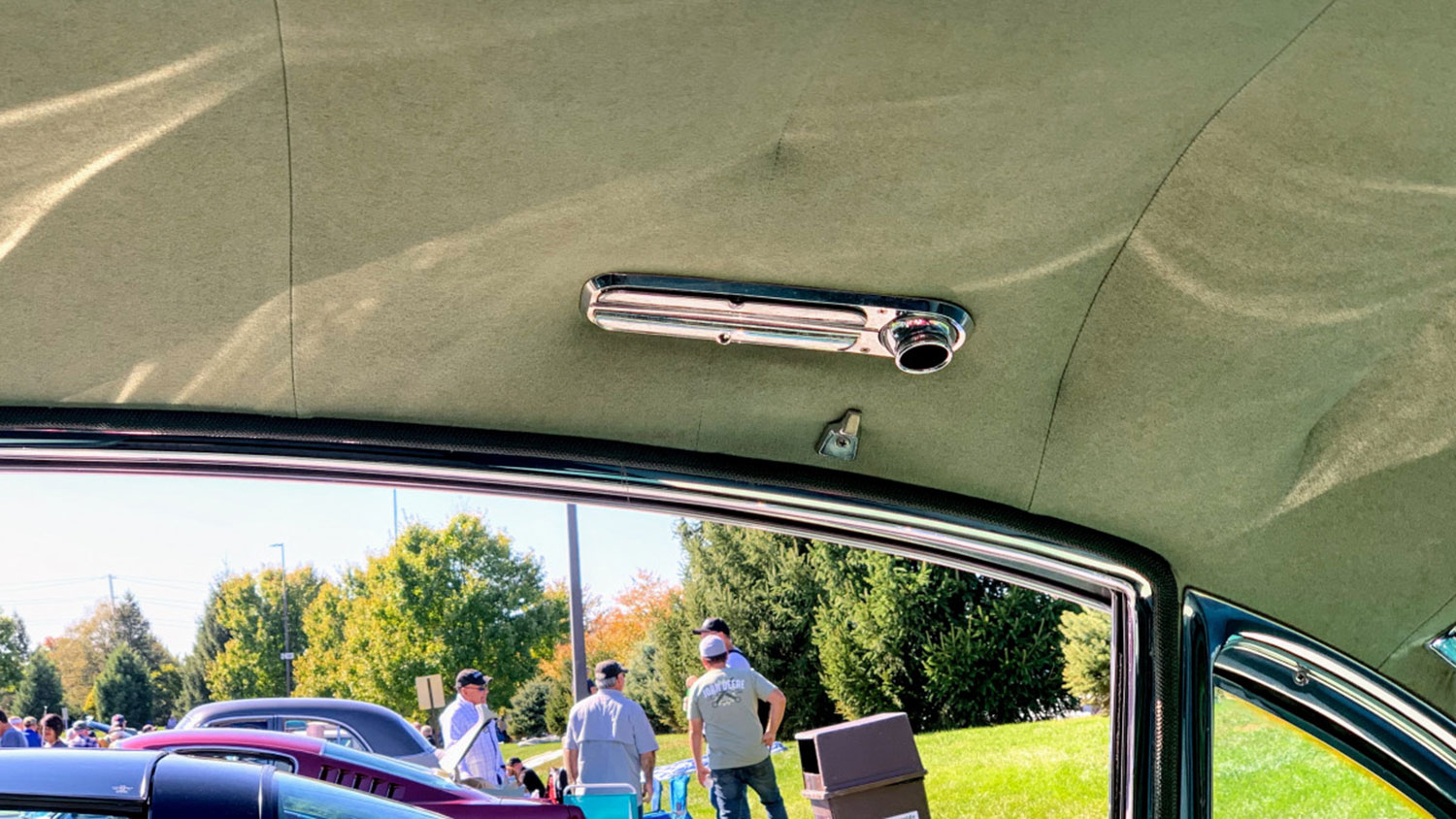

    What is your 54? Olds, Cadillac and Lincoln all used boot mounted AC in the 1950s. I think Olds and possibly Cadillac had ducts that mounted on the inside of the roof. The usual option nowadays is to have a centre console on the transmission tunnel that feed air to the rear.

  9. Oneball
    Joined: Jul 30, 2023
    Posts: 1,652
    Oneball
  10. BJR
    Joined: Mar 11, 2005
    Posts: 11,361
    BJR
    That was back in the late 40's and first half of the 50's. When GM, Ford, and Chrysler, used trunk mounted AC units. Now a days everyone mounts the units under the dash.

    this is almost exactly what I was planning except I’d like to route a vent to the back seat of my kids.
