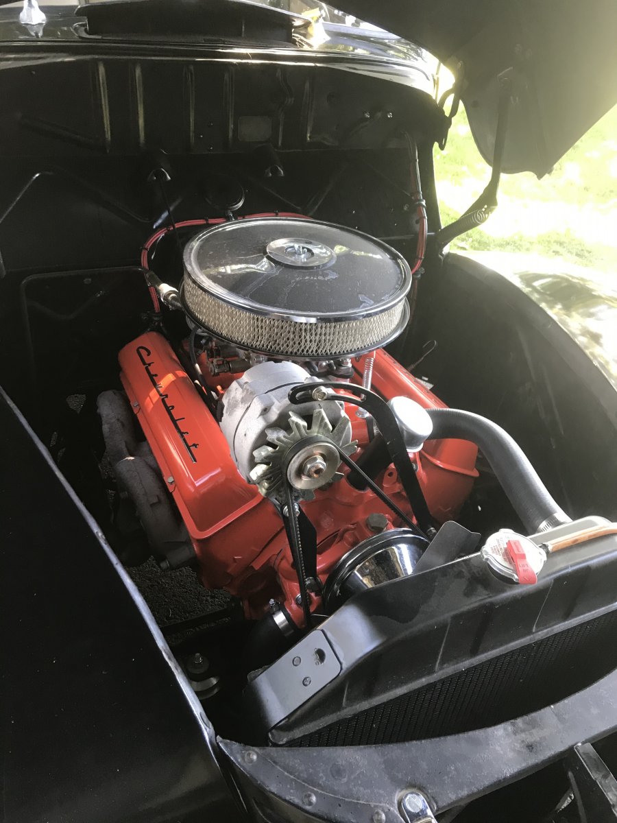

    Hello all, I am hoping to kick ideas around on my 1940 Ford. I bought it this past summer and it runs and drives great. It’s a fresh car with a 283, stock running gear, walker radiator, etc. Pretty basic setup. It seemed like it was running hot, so soon after I got it, I pulled thermostat (160) and changed out to a 180. I also swapped out under dash temp gauge with one I knew worked accurately. The gauge will climb to 220-230 easily, stopped and idling or shut off (like getting gas). On the road it will SLOWLY come back down but never really goes below 200 once hot. It pukes a little antifreeze as well.
    I drove it today for the first time in a couple months and even with it being 35 degrees out, I tipped for gas and sure enough, climbed to 220-230 after sitting 5 minutes and didn’t really dip below 200 the rest of the way home. I’m not sure what the issue could be...I’m not familiar with SBC despite them being very basic. I did do a search and most problems pointed to thermostat (which I already changed). I may try running no thermostat and see if that does anything.
    I’ve never really had a car constantly run this warm. I know it may be “normal”, but it just seems odd to me. I should check timing, that I have not done. Car does run great however
    Any ideas or thoughts anyone has beyond that?

    Definitely the alternator.
    Ok fine. Timing is on? No chance you have an air pocket?

    Nice clean engine detail and I like the alternator bracket, ‘40’s pose a problem for the alternator with their narrow, tapered hood. I would suggest getting a thermostat housing gasket, pull the 180* ‘stat and drill two or three 1/8” holes in it to bleed out any trapped air as you fill the cooling system. There are commercially available air deflectors that cover that opening at the top of the grill to the radiator, but you could easily fab one, it might help. The fan is driven by the water pump, but how far is it from the radiator core? Maybe consider a shroud. Also, the belt looks like it doesn’t wrap the pump pulley too much because of the high alternator, rev the engine up a bit and observe that the pump is being driven properly. If not then go to two belt pulleys and fit the second belt directly from crank to pump pulley.

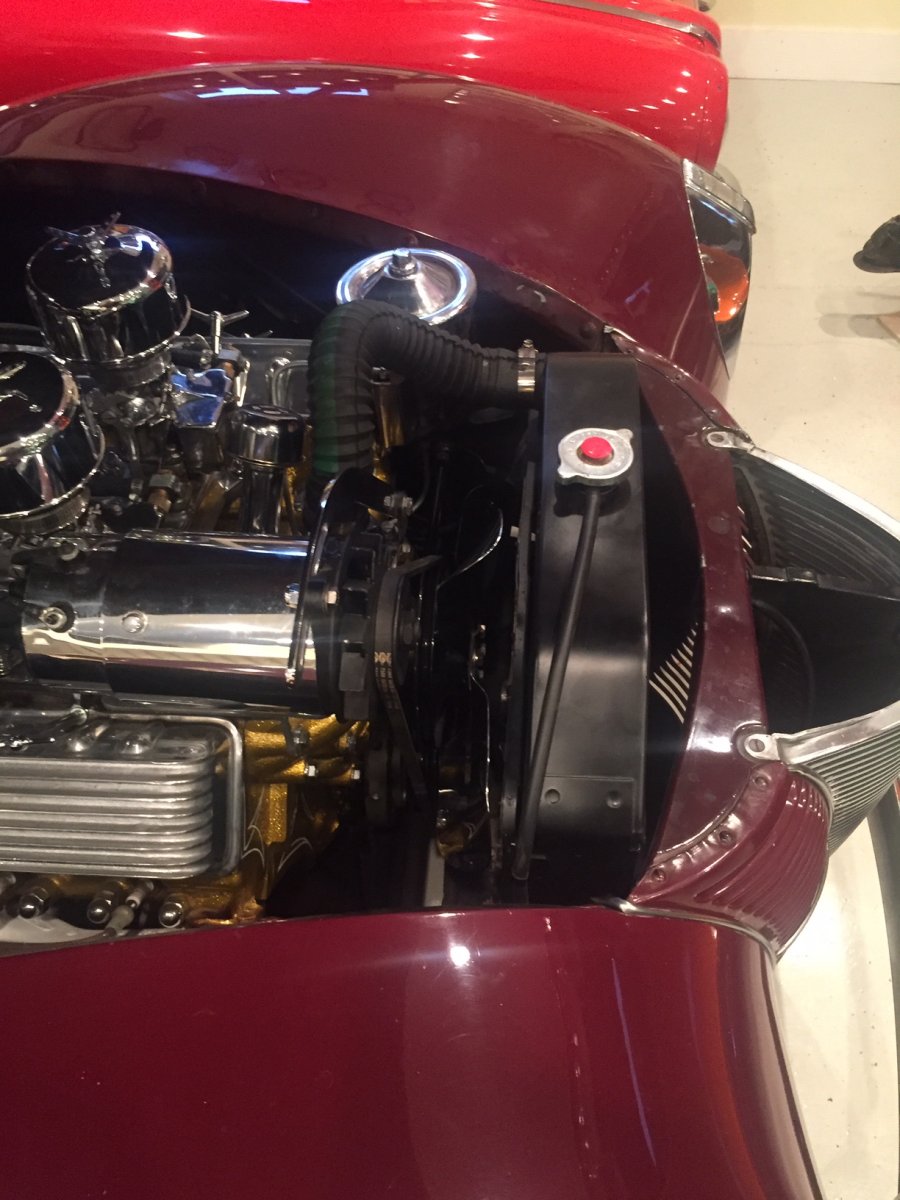

    My 40 has a caddy and runs at 165 on the freeway or around town or idling all day long in any weather, I have a walker radiator with no shroud and I don't have one of those street roddy grill deflector things. My 4 blade fan is 1 inch from the core. I am sure that is your problem, space your fan closer to the radiator and check your timing and make sure the vac adv is working. you need to have about 50 degrees advanced at low load freeway cruise, Initial plus mech plus vac advance

    Is that one of those aftermarket flex fans? If it is, throw it away and get a good stock style fan. Chevy had a good 7 blade clutch fan that would put ice sickles in the coolant. And like was stated, a shroud of some kind will help, as well as the piece on top from the hood latch to the radiator.

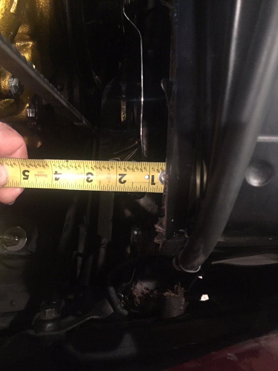

    There is no shroud and the fan looks pretty far from the radiator. The fan should be within an inch or so of the radiator, so it may just need a small spacer to get it closer. With the engine running, you should be able to put your hand in front of the radiator and feel air being pulled into it. If the spacer alone doesn't do the truck, you may consider adding a shroud.
    It also looks like air could be going over the radiator instead of being forced through it. Adding the sheetmetal piece mentioned above should help with that.

    As mentioned the fans closeness to the radiator is super important. I would run a 160° thermostat in it as well.

    Check the timing and move the fan closer as others mentioned. I had a case where I got a radiator from a guy, new but sat in the garage. I put it in, and it was fine around town then would heat up in the highway. Pulled the radiator and flushed it, out came all sorts of mice nest ****. Put it back it and has been fine since.

    I apologize for how dumb this sounds, but how exactly do you do that?

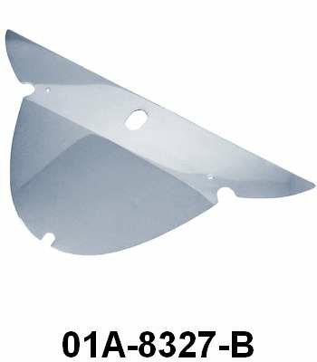

    Like everyone else said, check your timing, put a GOOD fan on it that is close to the radiator and make sure all the side plates and lower pan are on the grille.
