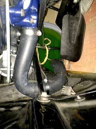

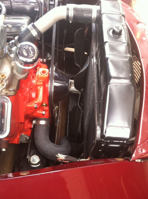

  5. The mechanical fan will be fine once you figure out what changed since the PO had it. My '41 p/u has a Babb radiator, an old clutch fan, no shroud or extra air deflectors and it was running @ 195 in the In-N-Out drive thru after idling for 30min in summer (and cooled right back down when air flow started again).

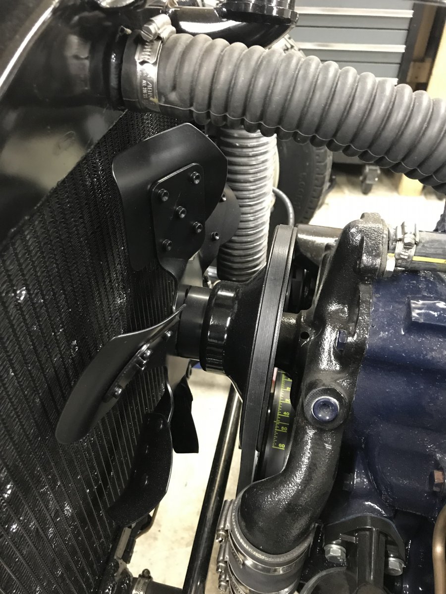

    This set up worked, decent fan in close proximity to the radiator. Thought the deflector inside the hood controlled air byp*** and the latch plate cover gizmo was just to look pretty.

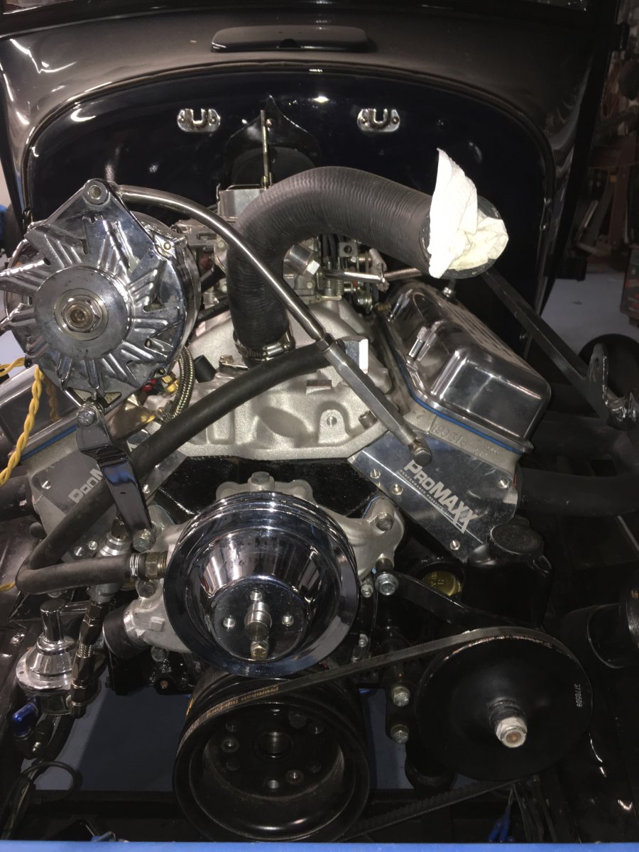

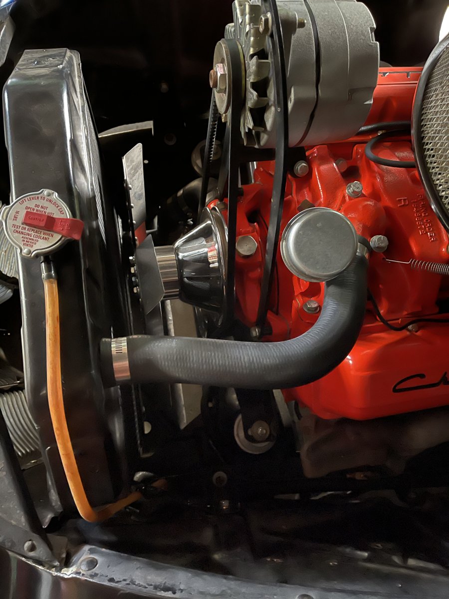

    I just went through the same thing with the engine wanting to heat up when sitting idling. It would cool down when going down the highway. My '26 T has a very crowded engine bay. I did three things to fix it. I built a good fan shroud. I used a smaller water pump pulley to change the ratio to provide about 15% more fan and pump speed. I rerouted the belts to give more belt wrap on the water pump pulley. That high mounted alternator does not provide enough belt wrap on the WP.
    As you can see I have a power steering pump to deal with that is not on yours. I was able to use a longer belt to run the WP/crank/PS. You don't have the power steering, but you can go to a crank/WP dedicated belt as mentioned earlier in this thread.
    These three modifications worked well. My engine will sit and idle for as long as I like and it never goes above 185.

  10. jaw22w
    Joined: Mar 2, 2013
    Posts: 1,720
    jaw22w
    from Indiana

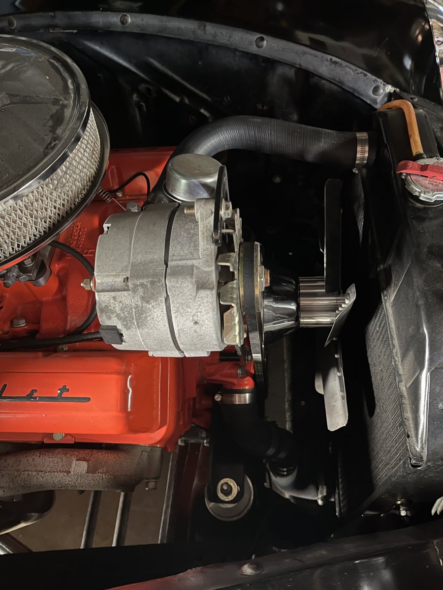

    Looking at your pic of the engine, I see that you have single groove pulley on the WP. It also looks like the 7" pulley. You can get smaller WP pulleys to speed up the pump and fan. You would need 2 groove pulleys on crank and WP to go with the dedicated WP/crank belt. So you would have a little money in pulleys and belts. Less than $100 probably. Cheaper than blown head gaskets and cracked heads. WP belt wrap is more important than you would think.
    I bet a dollar to a doughnut that these modifications would fix your problem. They sure fixed mine.

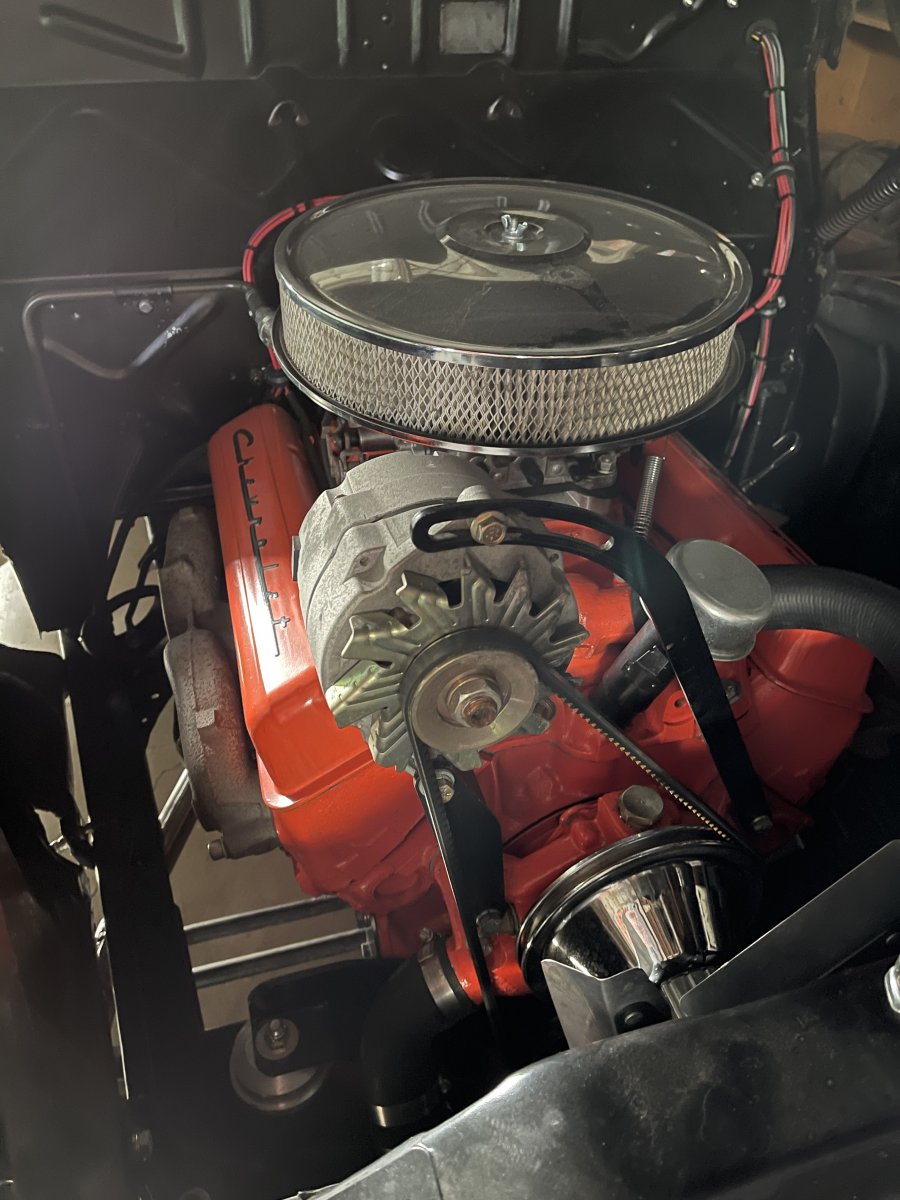

    How about rolling the alt.up and over more towards the rocker cover and welding an extension on the slotted adjuster bracket, that should put more belt surface on the pump. My avatar ruck has a cooling components fan and shroud and never overheats. Using an elect. fan will take most of the load of the water pump pulley as it no longer has to swing the fan blades. Ralphie

  14. I agree with Fordors. The alternator is mounted so high the chrome water pump pulley does not have enough surface to bite the belt. A idler running on the back side of the belt between
    water pump & crank would give the water pump pulley more surface to bite instead of slipping on the chrome.

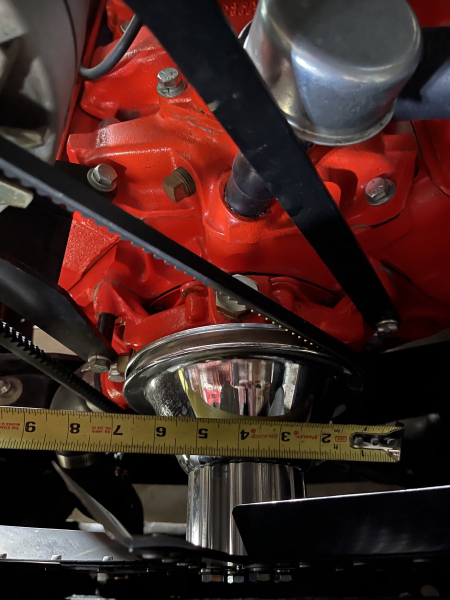

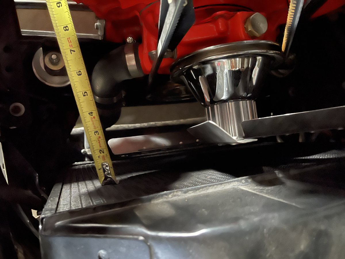

  25. Chris
    Joined: Jan 5, 2005
    Posts: 14,500
    Chris

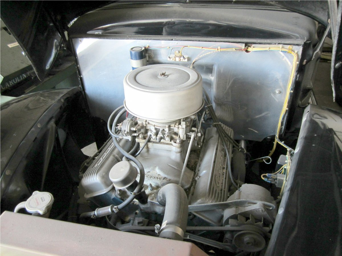

    Ok...well I have not actually messed with it. I have NOT checked the timing or done anything. That will be first on the list. However, I was out in my garage so decided to at least open the hood and take a peek. Water pump pulley is 7”. I am not sure if that’s normal or what. Fan is 2” from radiator. Yes, the little shields on the grill sides are in place, as well as the pan below radiator. I see what you guys mean about the height and angle of the alternator. I can grab the fan and easily turn it without turning the belt. The belt also does not seat into the grove that well. I’m ***uming it’s an aftermarket pulley.
    Im still going to check timing first. If that seems ok, I have a friend donating a GM power gen to the cause so I will address the alternator/belt issue then. I can raise the radiator if necessary and get a stock style fan closer and possibly add a shroud.
    Sorry, these pics are dark, hopefully you get the idea
    57620E24-46AF-4D7D-A9E3-2F2C30E32DFF.jpeg 5AA81239-301C-4C03-B3AE-D16C9D86E551.jpeg 32AE58CF-E161-4A69-8744-CF4AD74C568C.jpeg 909AA575-9F03-4867-BD90-83B58AA471EC.jpeg FFE78C35-42F4-4993-BF51-306BD39CE9C8.jpeg

    Another idea is, the long water pumps flow more, and you have plenty of room for it. Since you are going to remount your alternator anyway...

    I’m pretty sure that a big part of your cooling issue is that fan.
    Those flat on the front flex fans just don’t move enough air.
    I tried one on my RPU and it was useless.
    Overheating.
    So I switched it out to a Derale steel fixed blade race fan and the problem was solved believe me the blades of the Derale fan really move air.
    That and a spacer to put the fan an inch away from the rad and you should be good.
