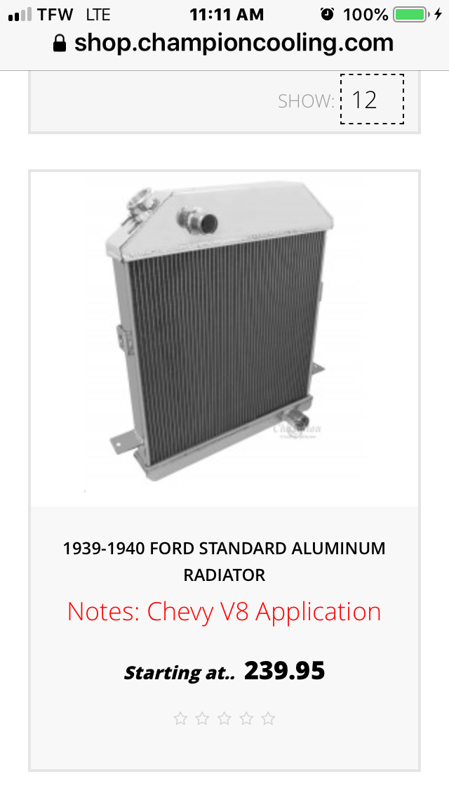

    Bingo, also Jegs (a**** others) sells a hi output SBC long water pump. Reasonable priced. If available, install a Champion 3 row radiator. Put the 160’ back in, get rid of any flex fans and corrugated radiator hoses. One Syclone pusher fan should be plenty.
    Good luck
