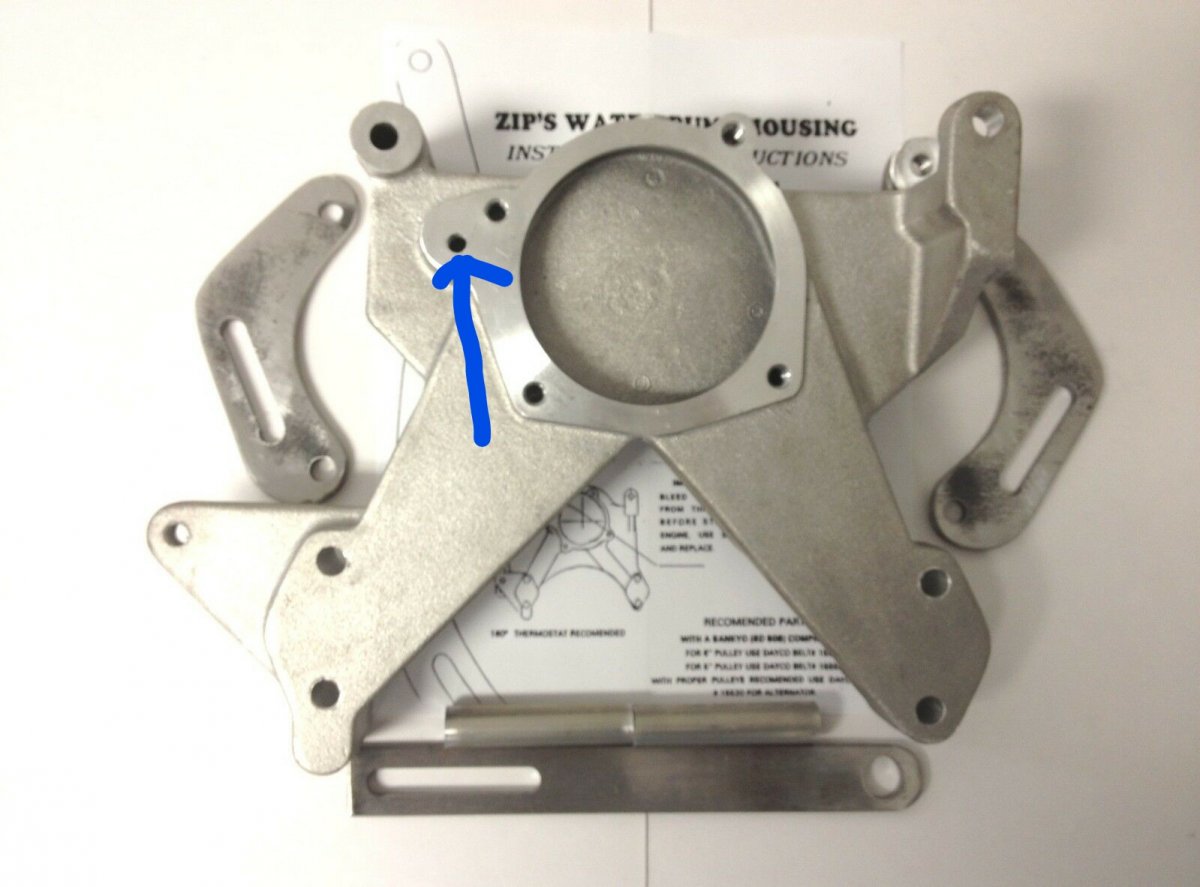

    wp riser_LI.jpg Not sure if if it is the issue but the return hole from the heater hose on the Zips riser looks to be seriously smaller than the return hole in the pump restricting flow.
    I can't find a usable photo of the back side of a 6 cylinder pump that I can save but the hole on this flowkooler pump should be oem size and looks a lot larger than the what appears to be a 3/8 hole in the riser. https://www.flowkoolerwaterpumps.co...line-6-cylinder-ccw-rotation-riser-water-pump
    Because there are so many of those risers out there on Early Fords and AD Chevy pickups I'd think if it was a serious issue it would have been brought up. Possibly because so many guys don't run a heater or don't drive when the temp goes down. I've run the heater in the middle of July up here crossing the passes at night when the temp drops down a number of times.
    If the heater is flowing right and working right you should have enough circulation though the heater that even a 160 thermostat won't open. 15 miles and the temp should get up to 160 though even if the heater is doing most of or all of the cooling.

    That answers that question so we can pretty well forget that it is something with the Zips riser.
    I'm still betting on restriction.

    I agreed with this yesterday but I'm not so sure now. This looks more like a bypass than a return when looking at the pump vs riser.
