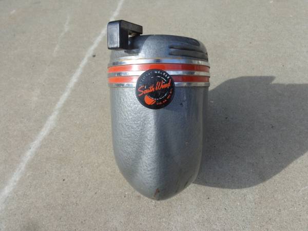

Technical Heat- or the lack of it - UPDATE
Discussion in 'The Hokey Ass Message Board' started by HOTRODPRIMER, Jan 25, 2020.

    ^^^ Cool. My old Corvair had a Gas heater in it, worked better than the forced hot air.
    Cliff Ramsdell
